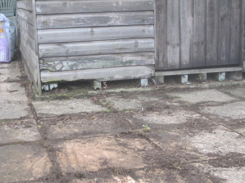

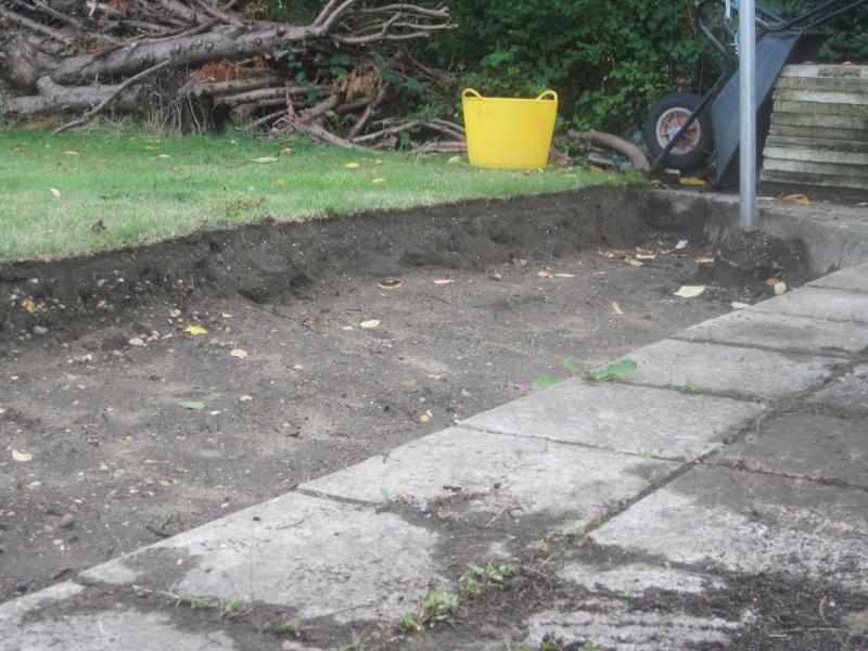

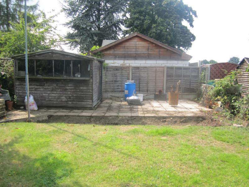

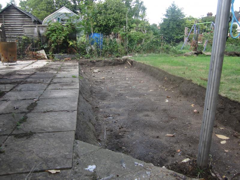

Further to my earlier post I thought I would attach some photos of the site which show the existing base and what I have dug out. I am hoping that someone will be able to advise on the following: -
I) Whether I should add some hardcore to what I have dug out before covering with cement
ii) Should I just fill the additional space to the level of the existing base or cover the entire area with an additional layer and if so how much?
My other questions relate to the sub deck of what the Garden Office will be built on. I was looking to lay DPM on top of the base and then lay the timber sub deck with insulation in between.
Would a perimeter of bricks, including air bricks be best to install the deck on?
