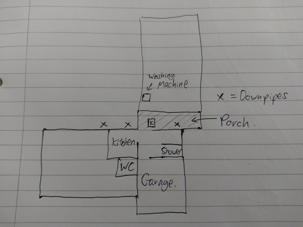

Hi,
I am currently in the process of buying a property which has an inspection chamber within a "porch" area which connects the house to an outbuilding. The outbuilding has double brick walls, and I wish to fully connect it to the house (losing the porch in the process).
There is a flat roof running the whole length of the outbuilding, plus the porch and the right hand side of the porch (as viewed in the attached image) is a brick wall, with the right side being a double glazed door.
I am awaiting a full inspection of the drainage, but it seems that a drain must run under the garage to the IC, with the WC and shower connecting to it (there is also a bathroom on the upper floor, approximately above the WC on the ground floor).
I am not clear whether the kitchen and downpipes connect to another drain, or whether they connect to the IC directly (there is no other IC or rodding point in the garden to permit rodding to a further drain, and the owner believes that the drains only serve that house).

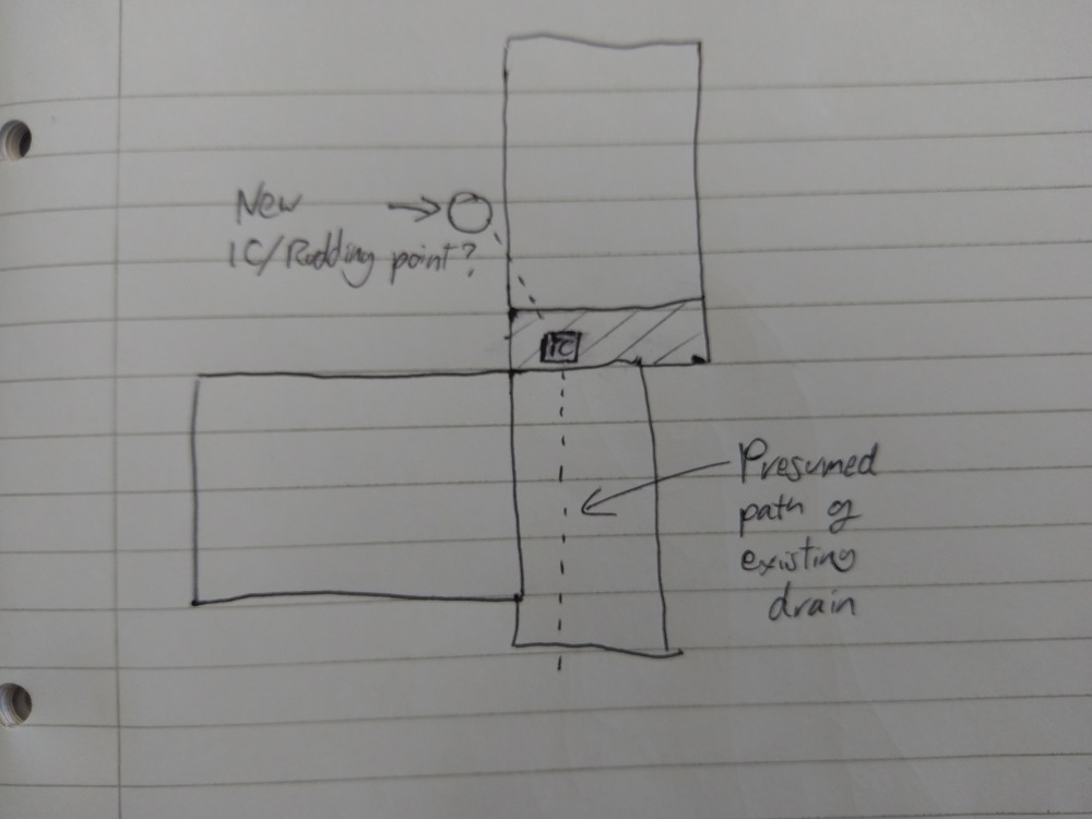

I am very keen to either remove the inspection chamber, or build over it in situ and provide rodding access outside the buildings.
To do this, the drain would obviously need to be extended to the new IC/rodding point. If the angle of the new drain was less than 45 degress, could this been done while leaving the existing IC in place? With that configuration, could I permanently build over the original IC in the knowledge that it would never need to be accessed again?
Things become more complicated if there is a drain along the back of the house (rather than just direct connections at the IC). In that case:
If that drain only carries water from the gutters and, possibly the kitchen, does it need rodding access at the original IC location? Could rodding access be added at an external point on that drain?
I've attached a couple of drawings (sorry about the rough quality) to hopefully illustrate the situation.
Any thoughts would be much appreciated as I would really like to avoid keeping the IC within the building (even with the double seal cover).

Need a better idea of where the drains run before advising further. Building regs state all drain runs must be accessible for rodding if required, depending on what is currently accessed from that chamber, will determine what you can do with it.
If its a shared drain, then its the Water Company's asset, so you'll need their permission to do anything to it.

I've had a couple of contractors have a look now, and this is what I was told:
1st contractor
  • It could definitely be moved outside at an angle of less than 45 degrees
  • When I asked about rodding access he said "we wouldn't rod it, we can just power wash it"
  • That there is one pipe running a short distance in from the outbuilding and one that runs a short distance along the back of the house, picking up the drainpipes and pipes from the kitchen, that pipe bends 90 degrees at the IC and then under the garage and out to the street
  • Would cost about £2,500 + VAT
  • No mention of needing a CCTV survey
  • No mention of building regs
2nd Contractor
  • It could definitely be moved outside at an angle of about 30 degrees, if the run along the back of the house is not shared with neighbours
  • The building regs guy he works with would pass it, but the council building regs guy might not
  • It is unlikely that the drain run is shared, but would need a CCTV to confirm (£180 + VAT)
  • If the drain is shared it is still doable, but would cost much more to move all the required drains
  • Would cost £2,500 to £3,500 + VAT if drain is not shared
