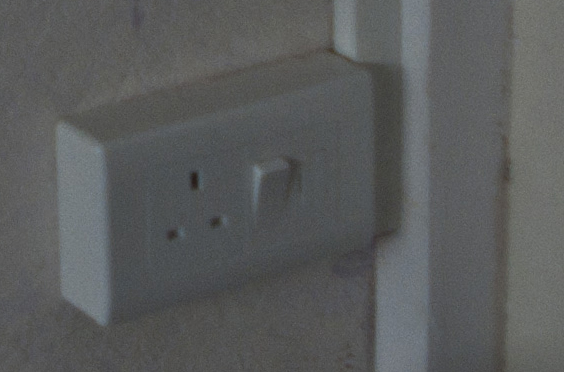

Yes as you are adding a 13 amp fuse in the plug, but there are other methods, I used a grid switch system IMGP7387c.jpg with a socket, switch and fuse in a four module plate size of double socket once you add the 13 amp fuse you can add as many sockets as you like.
