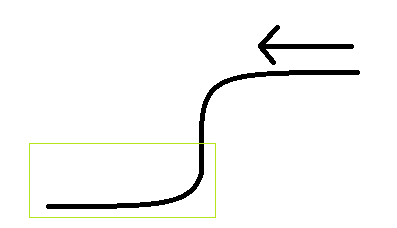

Hey guys...I've run into a problem with regards to moving my toilet in a downstairs bathroom.
I was going to dig out the existing soil pipe, cut back and couple a straight piece on to the existing in order to move the loo. Unfortunately the pipe is too close to the wall and I can't cut it back to before the 90deg bend. Would it be a problem if I added another 90deg bend, creating a s bend? There is enough depth to do this in the floor (to allow for pipe and fall etc). See badly drawn pic below - the section in the green box is the existing pipework
Any advice is appreciated!

Based on your sketch (photos would be better), what you want to do is fine. Swept bends would be better than knuckles.
