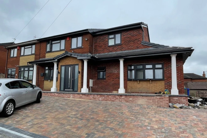

Extension Built - Rules Not Followed - Neigbours "Hate..it" - 2B Demolished
Just the thought of stepping up to that front door pains me ... or maybe the builders are about to construct a quality set of steps :confused:
Lethal. Paviors should never oversail the wall. Nuts. Differential movement (wall v's the rest) and ex/con will mean a good many of the edge pavoirs will inevitably loosen.
The wall should ALWAYS supersede the paviors (paviors abut the wall not wall abut paviors).
Alway use the wall to 'frame' the paving..

I agree, the pillars look naff, and I can't comment on the quality of the build, but it doesn't look any worst than the many end of terrace / last semi on the row side extensions I have seen before.

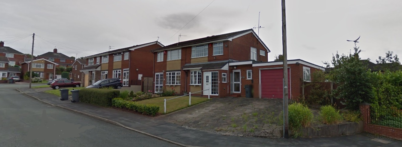

From a planning point of view the footprint is not much changed, as it had a big garage already. The pillars are silly, but some like it. A friend, who's a carpenter, recently bought a house with a pillared porch, and quickly swapped them for some oak.
Looks awful. The Grecian style columns don't exactly look in keeping with a 1960s property. And the poor workmanship :rolleyes:
But more importantly, they ignored the plans. Sounds like it would be a lot of work to alter to what was on the plans, so they have to take it down. Lesson learned, eh?

Fact is though, regardless of the fact it’s a complete eyesore (and the workmanship is terrible), if it had have been built to the plans they wouldn’t be in the position of having to take it down now…
