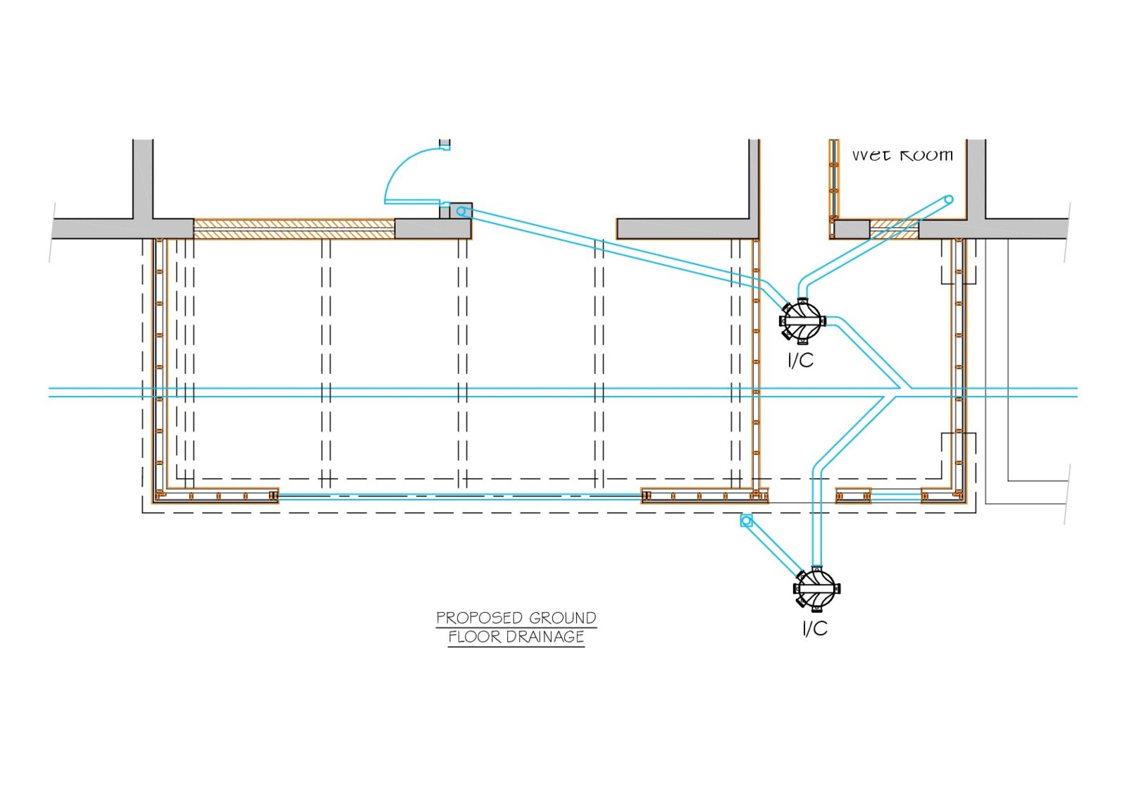

Woody, is the below what you mean? This had also entered my mind but wasn't sure if it was acceptable to TW / BC. The sketch below was knocked up quickly and may require a bit of tweaking prior to submission / construction...

You won't need that external chamber as the gulley can go straight to the drain. But otherwise yes.
The drainage layout is risk assessed nowadays so the old rules are not applied religiously.
If levels permit and the external branch is not acceptable perhaps the external drain can be run straight to the new internal manhole leaving the Main drain with just one branch.

I was under the impression that the external inspection chamber was required by TW as it gives them rodding access when there is no access to the house (there's also no access to the rear of the property without coming through the house but that's a different matter).
Also, I plan to run the sink waste to the gully and not just rainwater, so I assumed this would require the inspection chamber anyway?
Also, where the sketch indicates a wet room, is currently just a toilet (without an SVP). Any issues with running additional waste water from shower and sink into this outlet?
The internal pipework serving just your property, up to the point tit joins the shared drain, is your responsibility, Thames have no concern with this. Their concern is the through sewer taking your upstream neighbours waste, that is, and remains their responsibility, hence their concerns for its protection and accessing it in case of problems.
Fit a bottle gulley externally, this will allow rodding access along the gulley lateral to the main run, and omits the need for the external chamber in your drawing. All other internal drains will be accessible from the internal chamber as shown.

I'm thinking of ignoring the existing toilet waste pipe and bringing it out to the inspection chamber on its own pipe.
As said above, toilet hasn't got an SVP but I've never noticed any smells so thinking best not to mess with it (other than routing it to new internal inspection chamber).

Wet room, fit proprietary floor drain/gulley, connect to 110mm under the floor and run straight to chamber. Removes any risk of syphoning the shower drain when WC flushed.
