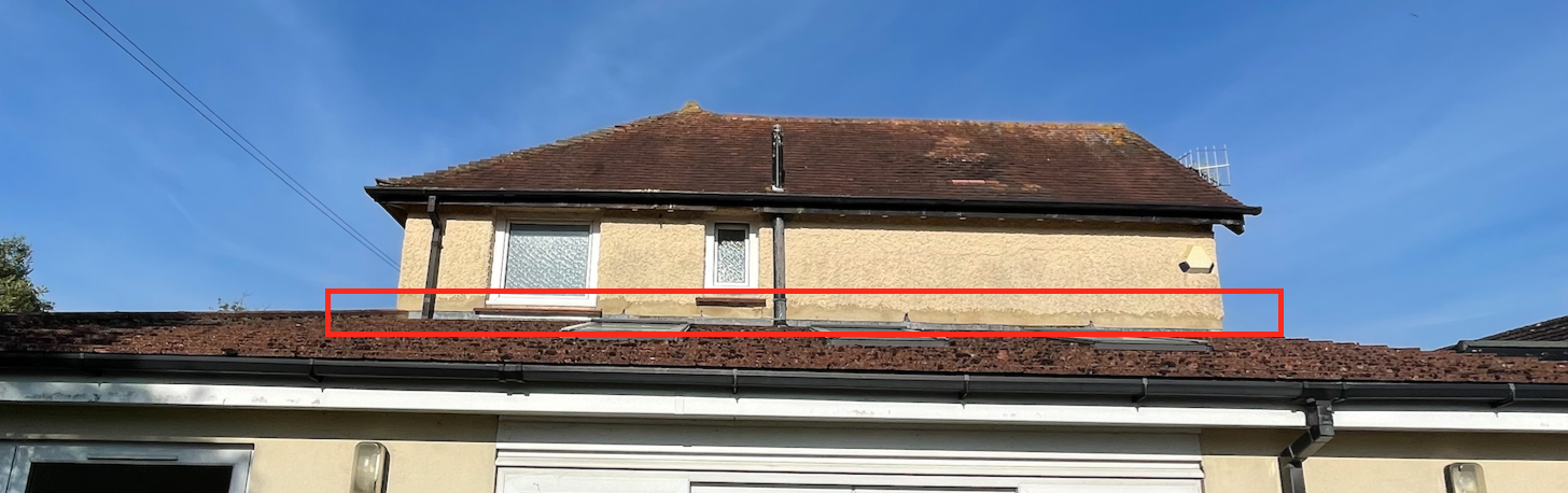

Hey -
First post, long time lurker, so I was hoping someone may be able to provide some advice please.

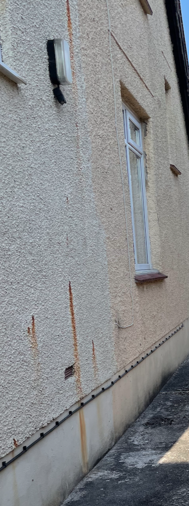

I'm looking at a house, and like a lot of people, am slightly hesitant to spend on a survey as there's already one thing that does strike me as a bit odd.

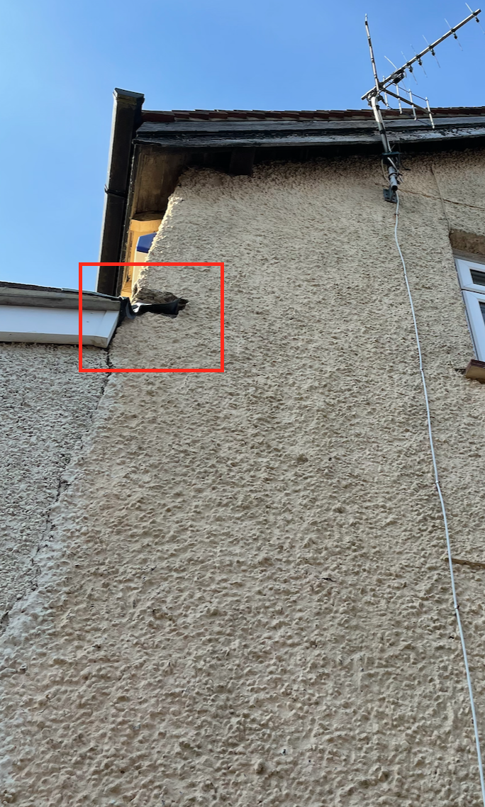

An extension was added in the last 10-15 years, you can clearly see the join in the (not very attractive) pebbledash finish. As I understand, it's semi-expected as things settle.

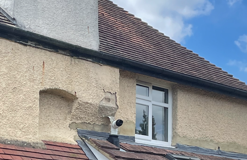

There are three problems I can see:
  1. The join where the extension meets original house: its visible (as expected, really), but there is a piece that needs repair as it's fallen away.

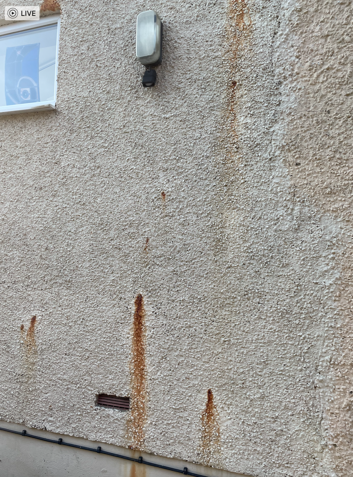

  2. There is rust coming through but only in the extended parts - I think this may be wall ties but at no more than 15 years old, is this a sign of shoddy workmanship or a costly fix?
  3. There is also a section that has been recoated with cement above the extension towards to the original wall of the house.
Any advice gratefully received - as with a lot of house purchases, cash is tight and a couple of grand spent on a surveyor to have to walk may impede a future purchase.
Of course, if this isn't too serious and I decide to persue the house, then I would look to engage a surveyor.
Many thanks
A

I don't know about the rust staining. It looks to me like it might be old metal fixings in the wall, for pipes or washing lines, but I don't know.
We use stainless steel wall ties now.
Could there be a water leak into the cavity?

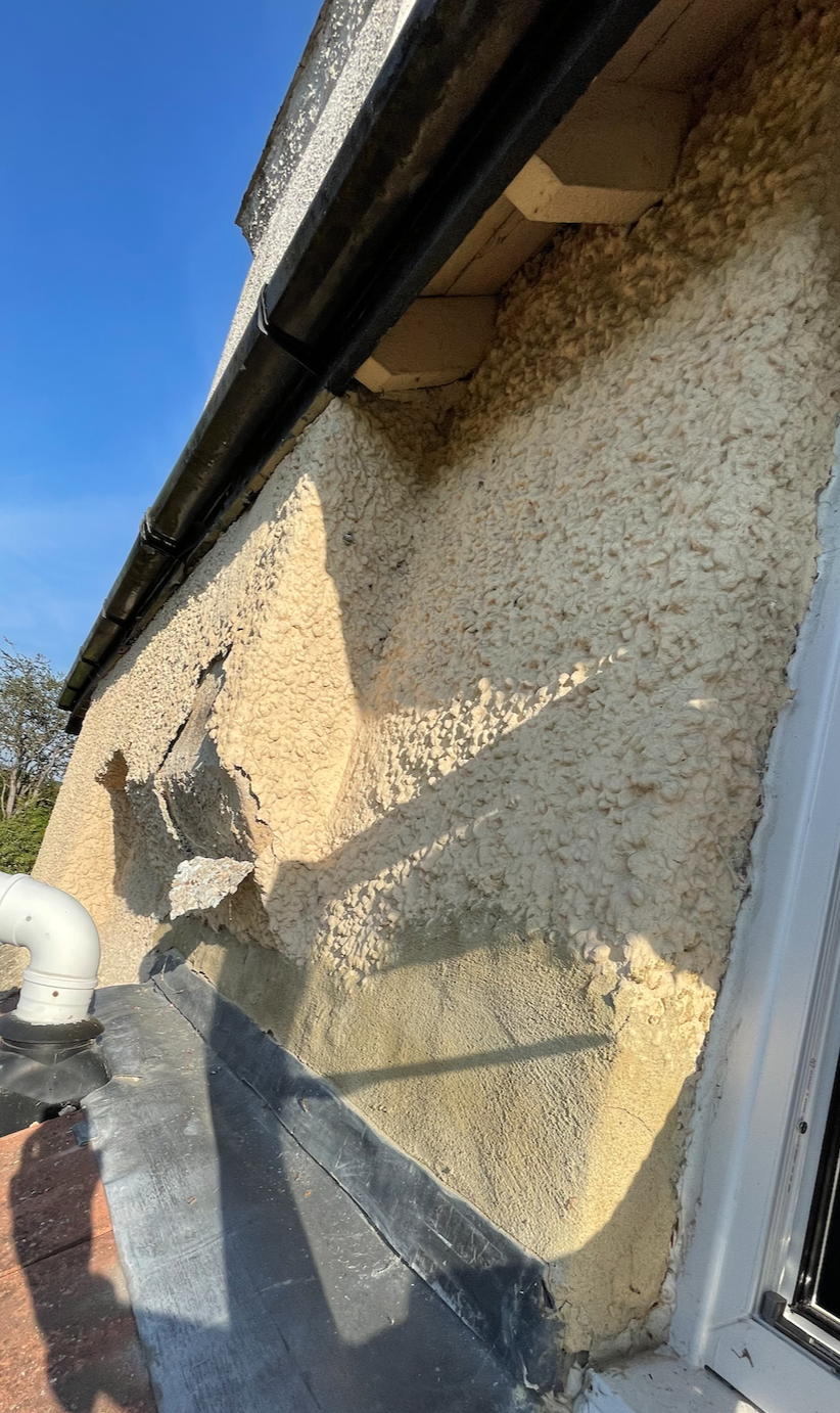

The patching of the render isn't very good, the cement where the roof joins is where they have patches the render for the flashing.
I'm wondering if the rust stains are as John said old fixings, or could they be from what's in the render maybe there was bits of iron or something in the ballast they used to mix the render.

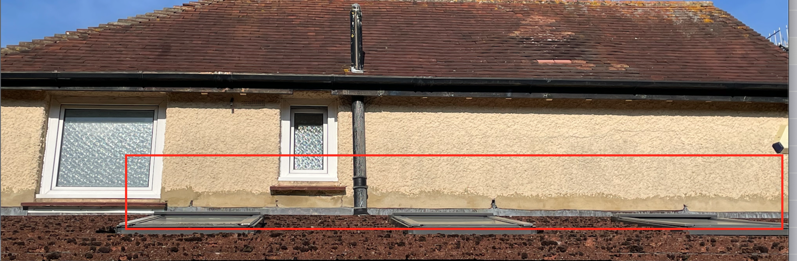

The join in the wall between the extension is a tough one, if cracking isn't visible inside then it's possibly nothing to worry about and may jest be where they haven't attempted to blend the new and old render in.
The bit in the corner of the roof apex, looks like the old render is quite thick and they've channeled the lead in. But the pics not that great and hard to make out exactly
Thanks for the reply - I do know the rust stains are only on the extended part of the property - which I thought may be a concern if it's approx 15 years old (if the wall ties may be corroding)
Clearly I'm no expert but you'd have hoped they'd be stainless, even 15 years ago. Good point that it may be ballast although a couple of them are vertically aligned so it does make me think it's wallties...
Won't be wall ties. My guess is either inclusions in the render, or old fixings. The join is shoddy. Would have been better to fix stop beads and fill the join with expandable sealant.

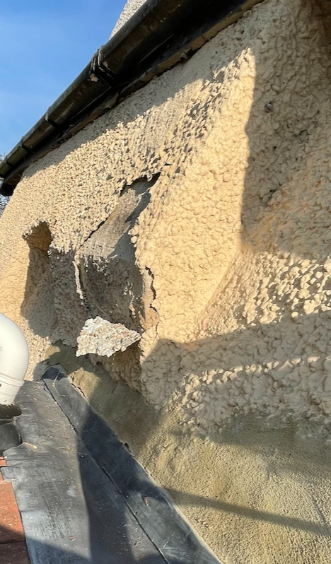

There's a large piece that's already coming away but no idea if/how difficult it would to strip it from the whole house, or better to render smooth over the top....

You can see rust stain on neighbours house aswell so I would be pretty sure that the rust you see is within the ballast used for render.
That peeling you see is quite common. Due to the texture water ingresses into the render and causes it to blow out over time.
It's not generally goo to render over it as it is unknown how good a condition the base is and the new render may well just fall off.
It will be quite the task to remove it all, but not insurmountable.
I'd be inclined to cut out the joint into a groove, with an angle grinder, and put a visible joint in. Would look neater.
