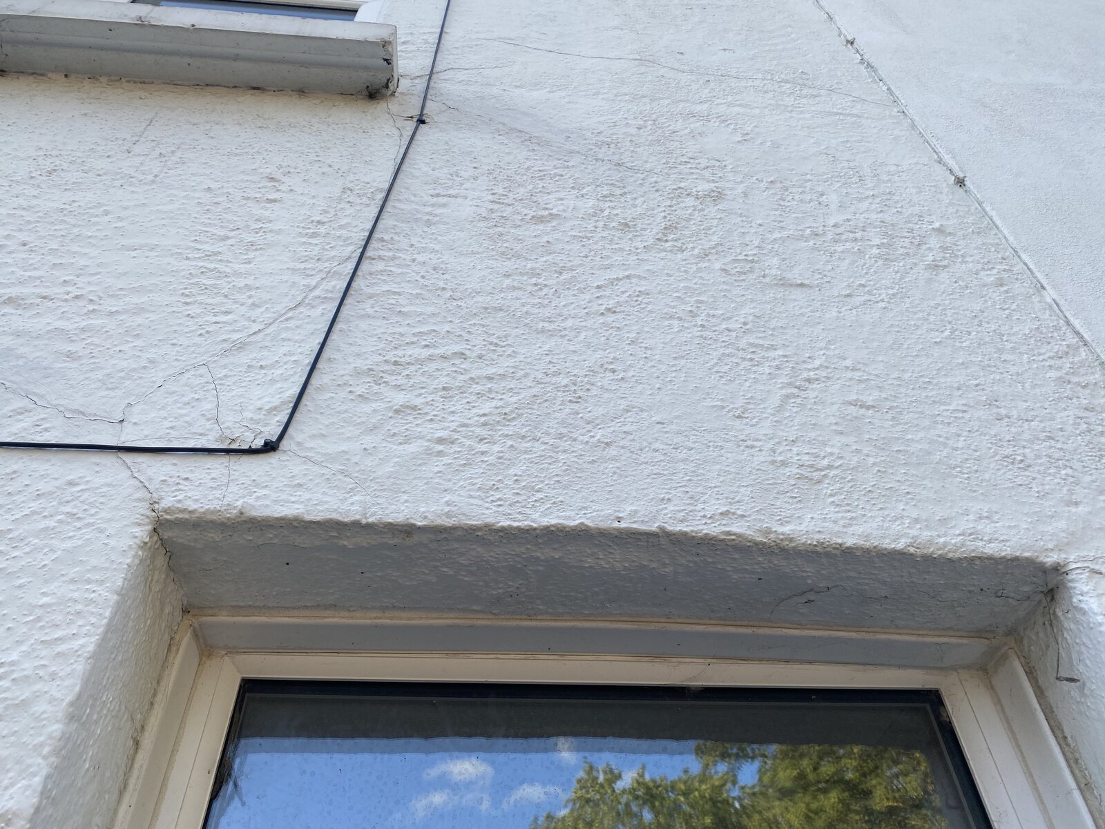

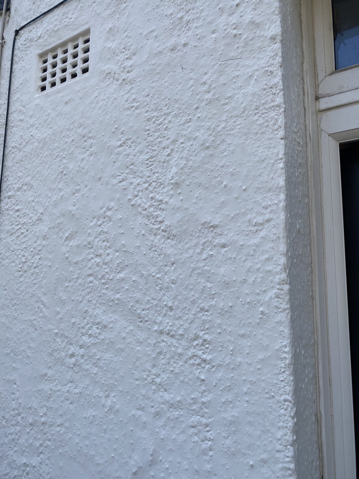

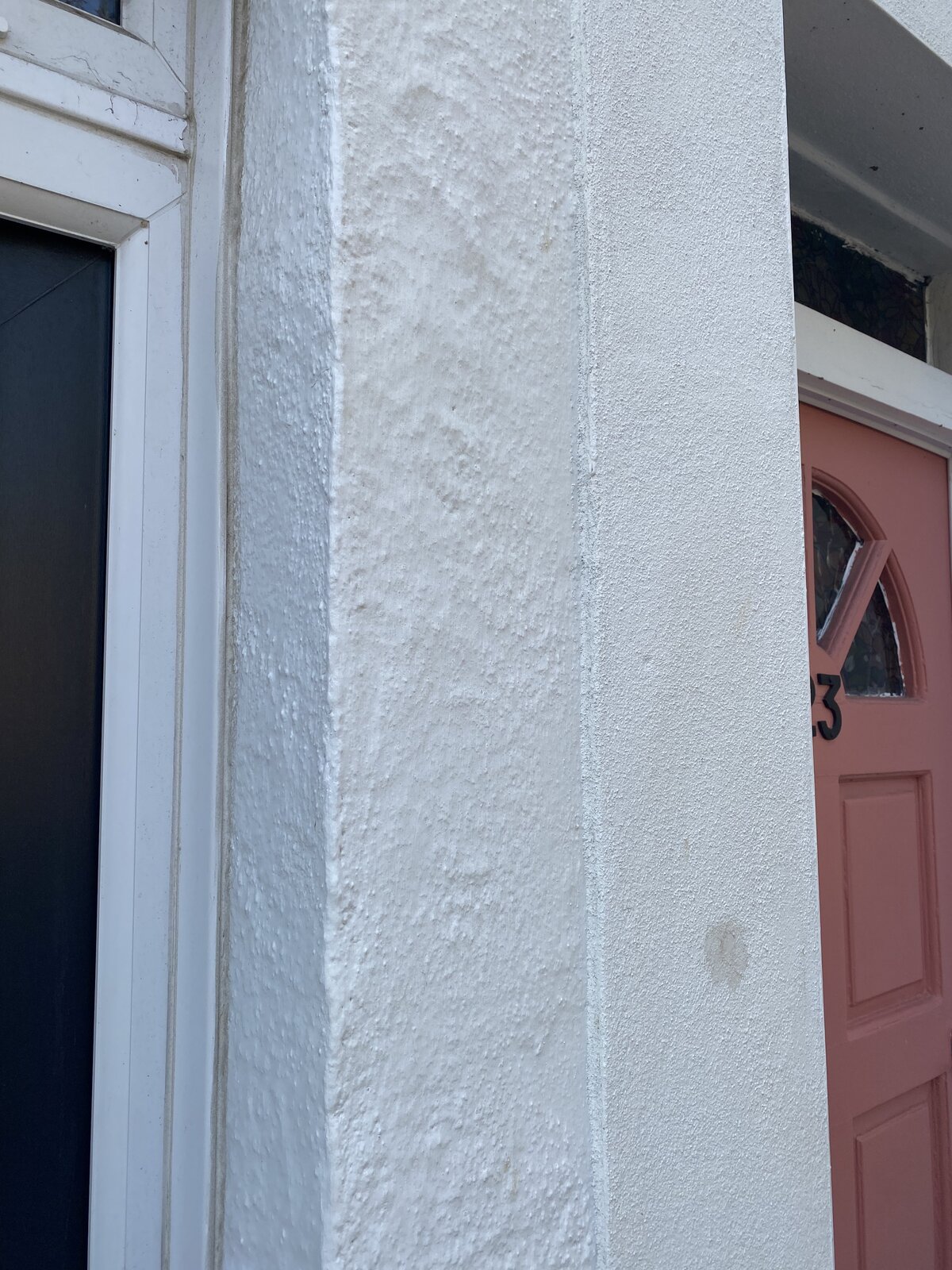

Could anyone tell me what the exterior finish on my house is? Looks like a coarse type of render—next doors is similar but much smoother, which I’d like to replicate. How easy / difficult would that be?
Guessing it might be Tyrolean Render.
I say that because mine has what looks like that same blistering effect in the low spots (evident more in your photo #3) with that partial smoothed out appearance, with just the tips showing.
edit: properties in my area generally jack-hammer old render back to brick, then apply new.
