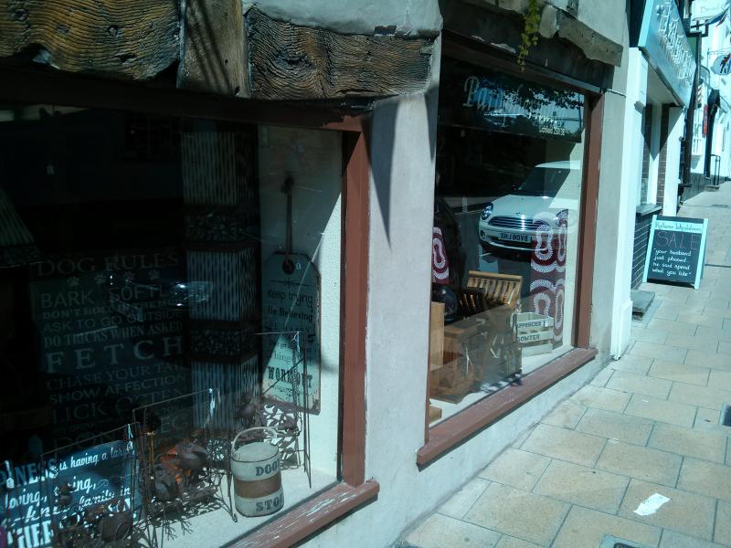

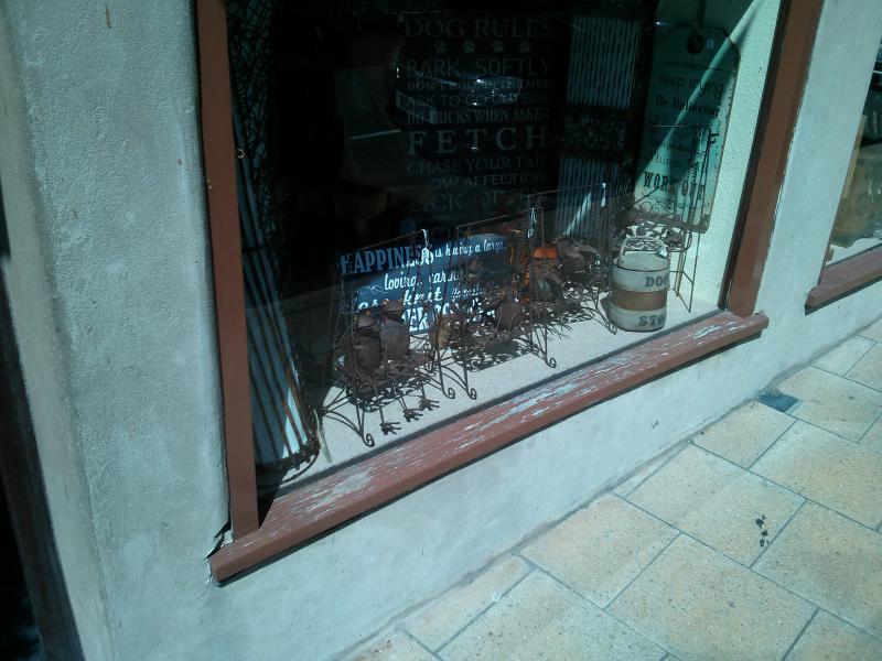

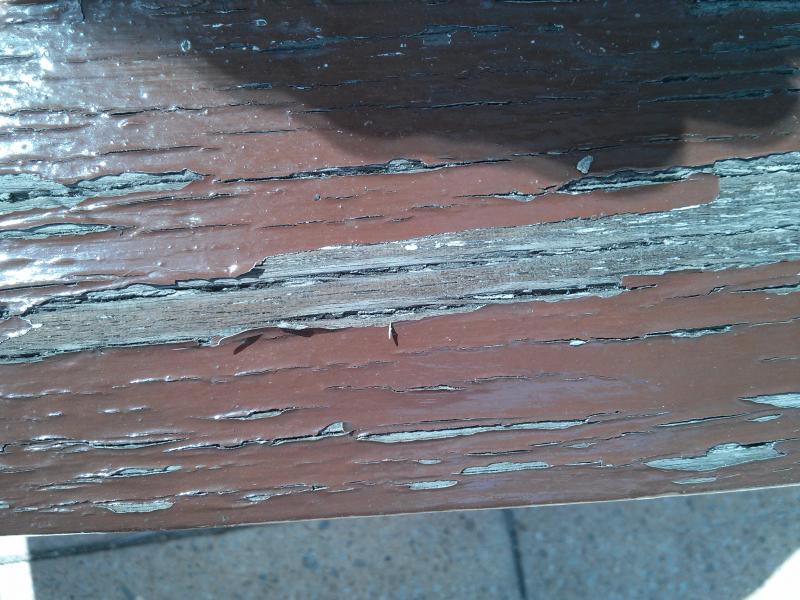

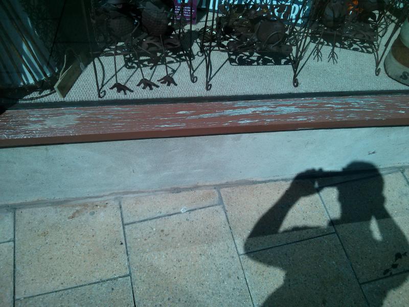

My 3 shop windows are in desperate need of re-painting. The frames are wooden, most parts are actually fine but the lower window ledge parts - the wood has all split and cracked and the paint has also split and peeled all over. The wood itself does feel dry, not rotten.
My initial thoughts were just to sand the frames right down to the bare wood, but sand deep enough to remove all the cracks/splits in the wood as well, then re-paint. Is this the correct method? Some of the cracks seem several mm deep so is this too deep to try and sand all the way through?
I have attached numerous pictures to help show what I mean. Any help and advice on how to tackle this would be much appreciated.
Many Thanks
Greg

Looks like the frames are hardwood, which will crack/ split eventually,
a good rub down wth an electric sander (I use a small hand held one for frames), you could use the Painters Mastic (coloured) or coloured woodfiller to fill in the gaps,sand and wipe off with damp Sponge/cloth,
then minimum two/three coats Quality Trade Exterior Woodstain, i.e Sadolin, Ronseal, I prefer Dulux Trade Weathershield Woodstain.
As its a shop dont forget Wet Paint Signs, and dont leave stuff around on the Pavement in case anyone trips over it and makes a claim.
Is the work only on ground level, as its on a public footpath the Council may require you to use scaffolding if you need to go higher (or do the high bits off a ladder on a Sunday, when there is no one around :wink: )

going by the pics it looks like the wood has been treated with a stain varnish,
If you chose to paint I would suggest either an Aluminum Primer then 2 Undercoats and then gloss,
If you go for Dulux Weathershield products , use their wood primer.

The frames had previously been painted. We did it ourselves about 3 years ago and it lasted about 6 months. I can see now from your advice that we weren't thorough enough in our preparations and skipped too many steps (not knowing what the steps were didn't help :oops: )
Once its all sanded down and filled, I may test with some stain and see how that looks compared to painting.
