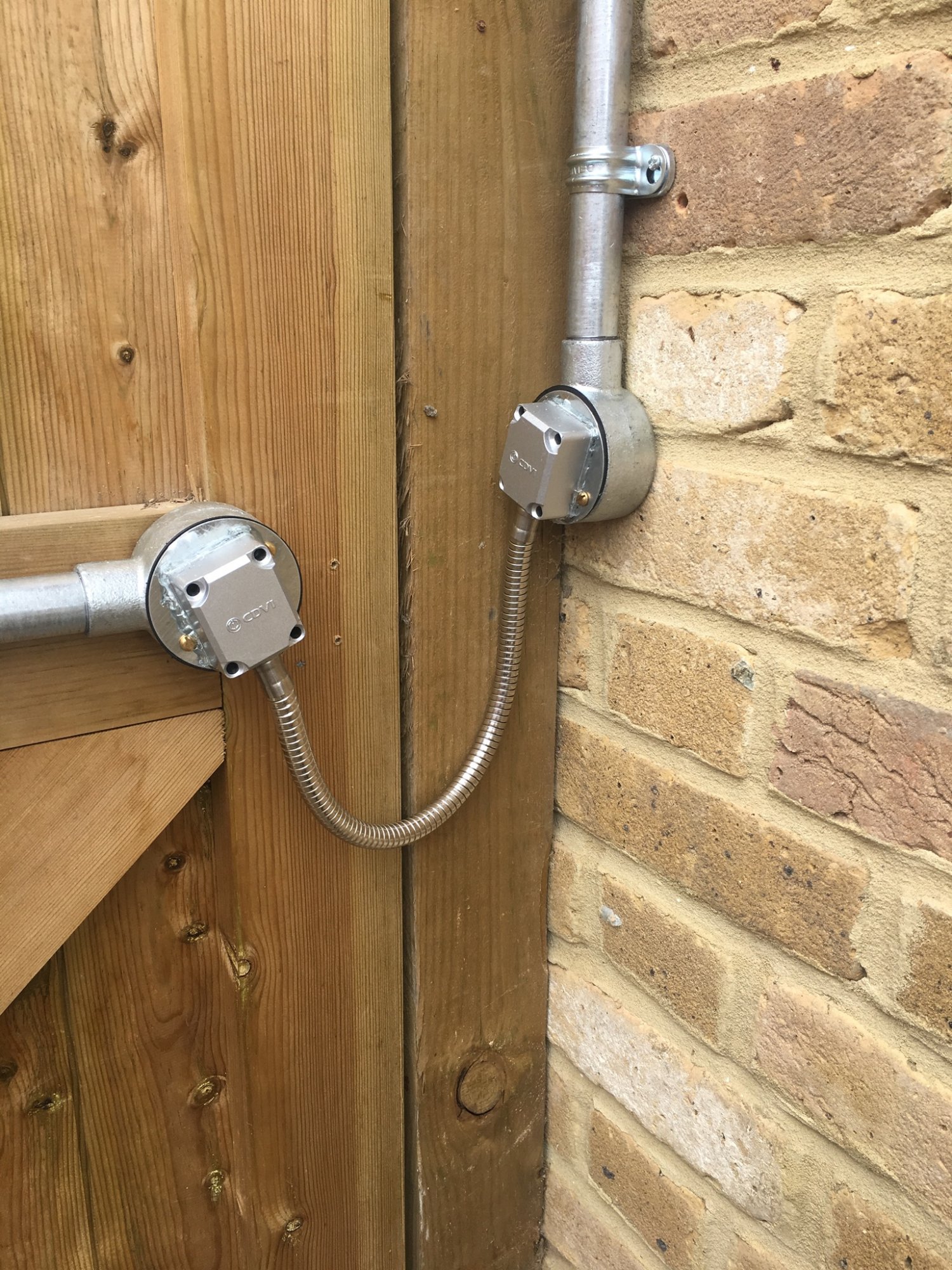

I am fitting an electric gate lock to a wooden side gate that I will power the release from a Texecom output and as I am running a cable from alarm to the gate, I am going to also add an external door contact, probably using the same cable.
When installing my external PIR I could drill through the wall with no exposed cable, but now I will have a small section on the wall, and then the cabling on the back of the gate. I will use an armoured door loop on the hinge, but does anyone have any good ideas on how to protect the cable otherwise?
Would pvc trunking be ok, or should I look at steel conduit tubes? I guess it doesn't have to be massively secure, someone cutting it and setting off the tamper alarm is probably good enough for me that I have a problem.
Ideally I wanted a semi circular steel cover to the cable, but I cant seem to find that. Also I only have internal alarm cable, so would that be ok if fully run inside conduit? I don't want to buy a roll for just 10metres.

Sounds like full metal conduit is best then to ensure no water gets in either. Will have to work out how to join from a metal conduit to a door loop to minimise exposure to the elements.
Depending on the door loop contact you could terminate the conduit into a metal conduit terminal box and then mount one end of the loop on top of the metal plate with some sealant between the two pieces of metal and then the wire can be terminated inside the box. That way should also mean you can get to the connections for maintenance should it ever be needed.

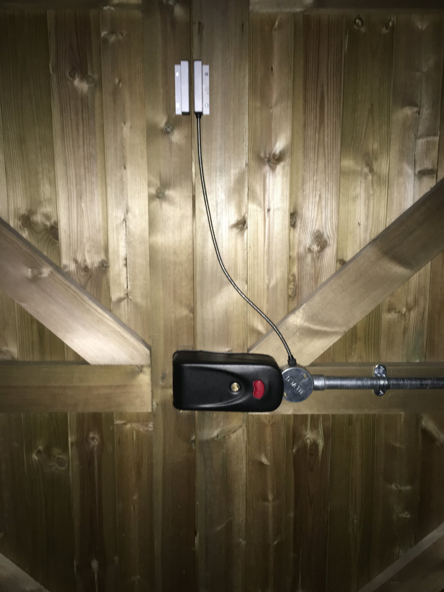

However I think I have got it done as per the picture. One small 2mm hole drilled for the cables for the electric lock, hidden behind the lock, and a larger hold for the rubber grommet of the armoured cable to the door sensor. Its a bit tight to get fingers into the door handle, so might need to put an extra pull handle on but its all good and now my phone unlocks my gate.
If its not too late one thing I probably would of done slightly different is to have the door contact on the bottom half of the gate (with the cable still coming out of the bottom) and then come out of the junction box from the bottom. That way water is less likely to find its way into the entry point as everything would be running downward.
crude example:
Haha. Nice photoshopping. I had thought about putting the door contact cable coming out the bottom to reduce water getting in , although the rubber is tight, but couldn't work out how to run the cable to the contact. Didn't think about putting it below the lock!!
It's too late for that junction box but have spares so will change it round at the weekend
Thanks for the idea

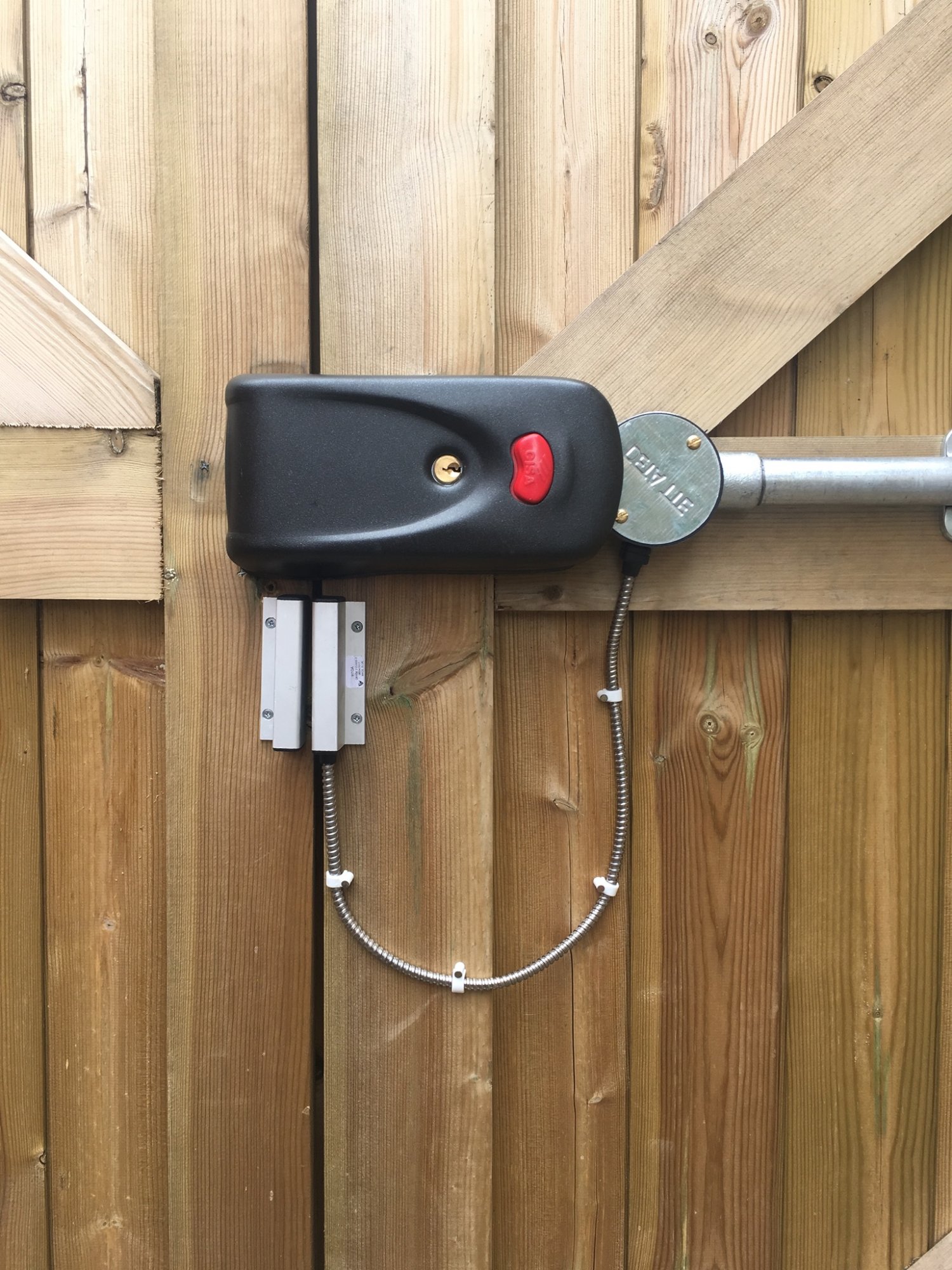

What ever you do or don't do, fix the armoured cable to the gate or someone will pull on it and cause problems, usually at the worst possible time.
HaHa. Thanks yes will be doing that as soon as I get cable clips the right size. Especially without easy pull handle it will be just the thing to grab hold of!
All done... Thanks all for the good advice. Door contact moved to below the lock with cable entering at bottom of the junction box and cable clipped to gate.
The door loop fixed to the 2 junction boxes with Sticks like sh!t and a hole in the box cover to allow the cable through. Hopefully all waterproof.
