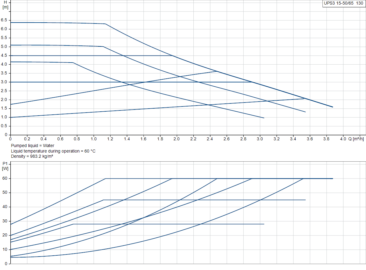

In short, you shouldn't use CP or PP mode with a ABV, some pumps like the UPS3 don't even have true CC curves but most arn't too bad, did you have any particular boiler and pump in mind?

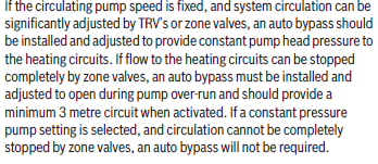

Good idea! I've looked at a few now. WB give some pretty comprehensive advice and it sounds very sensible. My situation will be a heat only boiler with three NC zone valves, using constant pressure mode. So they seem to saying I would need a bypass for overrun. But if you are using constant pressure mode, how do you set an ABV so that it opens only during pump overrun but not at other times? Or might it be better to use some sort of diverter valve for the bypass, as suggested by Johntheo5 above, so that it only opens during overrun?

Well you set it so that it opens when the trvs or MCV all close down and when the pressure rises and the pump is dead-heading. During normal CH operation, there should be enough pressure Loss so as it won't open.

I was wondering if the pump is running at constant pressure, would it slow right down in that situation. Maybe almost to a stand still. So that the pressure never actually rises above the level it is set at (even when all the TRVs and zone valves have closed and the pump is dead heading). The horizontal pump curve at 3.0m shows it maintaining the same pressure all the way down to zero flow. I don't know whether that literally means zero flow! It is very confusing, because it is still using about 10W at zero flow at that setting.
