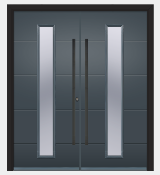

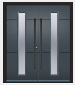

I’ve had difficulty finding a company that offers composite French doors suitable for a narrow opening.
After finally locating a supplier who can accommodate the 1300mm width, I am now faced with a height dilemma.
I have two options:
1. Order a door without a sill and use a AM370 aluminium threshold (which would meet my height requirement of 2050mm).
2. Order a door with a sill and AM370 aluminium threshold, but the minimum height for this is 2069mm, which is 19mm taller than my opening.
