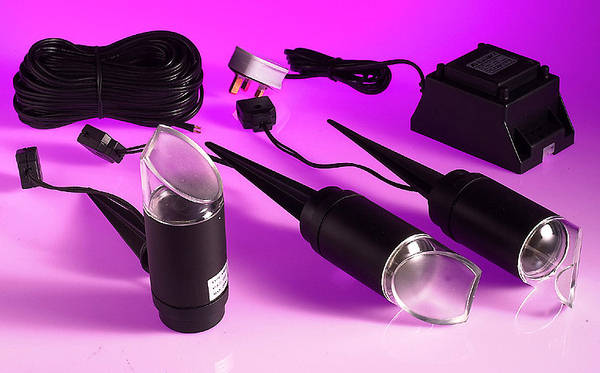

Hi
I have just bought a few new replacement external lights to replace some smashed and corroded old ones.
These are the ones I bought:
http://www.tlc-direct.co.uk/Main_In...tern_Index/Halogen_Garden_Lighting/index.html
Problem is, I cannot get them wired up
There are 2 wires leading off the new lights I've bought
These presumably need to be screwed into a junction box to join up with 2 wires that also feed into a junction box from the mains supply
I cannot find a small external/waterproof box ANYWHERE
Can anyone advise?
just as well you didbt. the lights you have linked to are 12v, you said
Harden Long said:
.............There are 2 wires leading off the new lights I've bought
The picture you linked to also shows a press / clamp connector , no Jb required
But then have you the transformer?
oh and TLC do supply suitable boxes, but I will not give the exact link as i want to confirm the existing lights supply voltage ( i dont want to see you turn up here with a black face like they do int the cartoons)

i still need to know the light supply voltage.
the press on connector is in the picture YOU linked to
post a pic of what you have

please stop saying mains cable- its not carrying mains.
as i said the lights from tlc have clamp connectors so should connect to the existing cable
BUT if they dont / wont fit, you can use these you should aslo use galands to do the job properly
as for extra lights that depends on the transformer rating.
say for example it says 100watt output
100 / 20 = 5
so you can have 5, 20watt lamps maximum
oh, if its of any use, its not un common for clamp connectors to fail like this, since although meant for outside selv use they still corrode
sorry to be thick, and thanks for your patience, but where it is likely that I would find the transformer to check it??
also what is a galand ??
a galand is a gland with an extra "A" (sorry it was a typo :oops: ) they are on the same page as the boxes.
The transformer will be on the cable you have that is slightly burried.
probability suggests it will be at the house end.
a transformer, transforms the mains 230v ac to 12v ac (in your case)
it will probably look like a large black lump that may or may not be plugged in, it may be a weatherproof one so it may be outside, but it will have one cable going in, and one cable going out, the outgoing one is the one which you say is slightly burried
using the link you first provided
the transformer in this case is the black lump that has a cable with the mains plug on it (transformer is top left) see, its a black lump :LOL:

Interstingly enough the product that I received does not have the press clamp connectors attached to them as shown in your picture above but a small V shaped plastic widget
I wonder if I need to get onto them?
Harden Long said:
Tomorrows task is to locate the black lump ! :LOL:
v shapped plastic widget = differnt brand of clamp / connector, from what you have said it sounds like a diffent brand of light.
if it doesnt fit go the jb method or buy the remainder of the set (starter kit) and change the lot (keep the lamps)
Its pointless asking tlc (or where you got them from) as what can they do? other than suggest you get a complete new set
oh, and the kit is designed so that it can be plugged in and no electrican required
