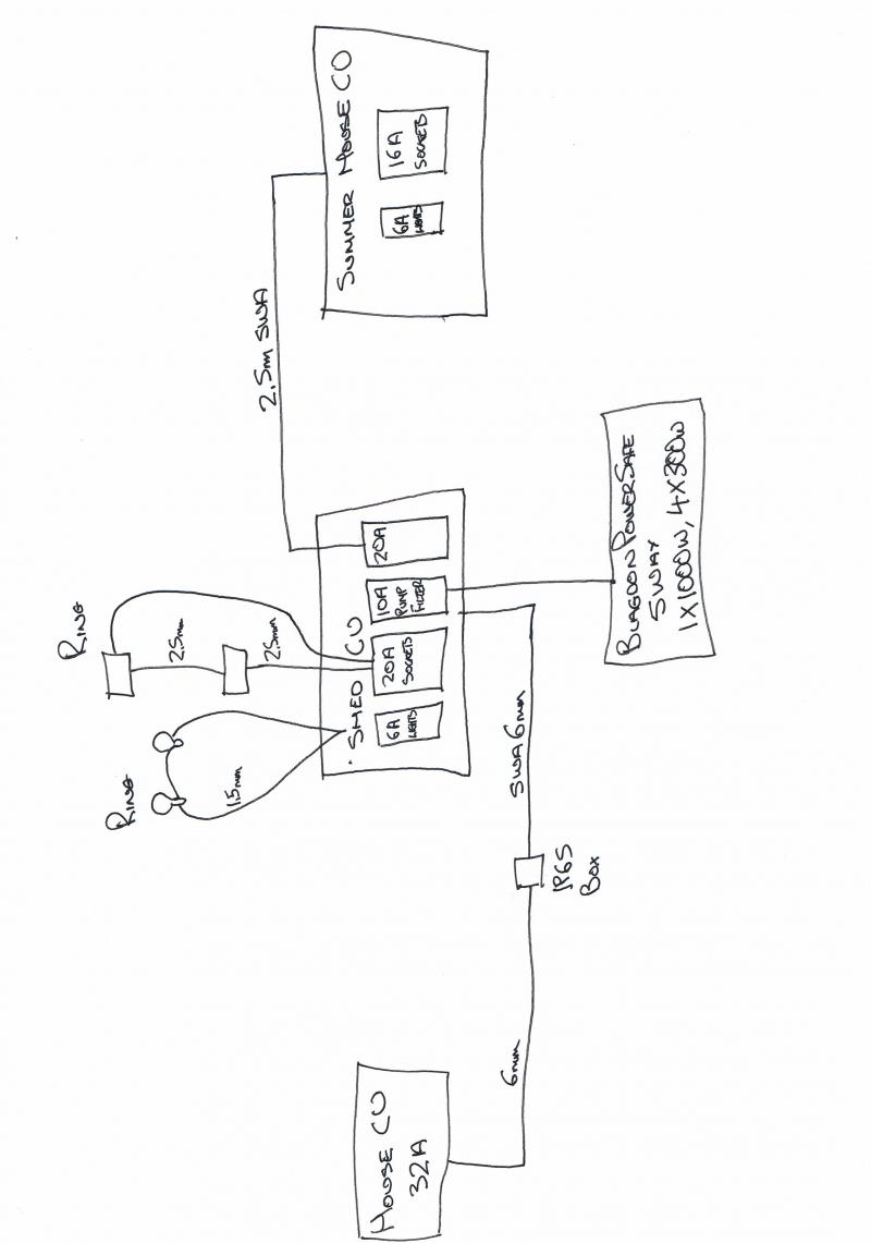

I am looking to install a consumer unit into my shed and then run another supply up to my summer house.
My shed is approximately 5m from the house and the summer housde a further 15m.
From my CU in my house I have a 6mm running from a 32A MCB to an outside box from where I have a 2.5mm SWA running to the shed. Ideally I would like to terminate the SWA into a CU and have 3 sockets (for lawn mower, tools etc) and a lighting circuit in the shed, as well as a couple of spare ways for future (pump, filter etc) and also have another 2.5mm SWA running from here to the summer house to another CU which in turn will have 4 sockets and a lighting circuit from it. The CU in the summer house will I think only need a 6A and 16A MCB's
Question is the RCBO inside the CU in the shed would it have to be 32A or less as am I correct in saying if its higher than 32A it wouldnt do anything as the house CU is 32A?
Ideally you need to work backwards in your design for the circuits.
The load required by summerhouse
The load required by shed
add them up this will give you your in house CU size breaker, then voltage drop should be considered and then you will come to the required cable size.
EG
Summerhouse: sockets 16A, lights 6A =22A
Shed: sockets 20A, lights 6A and summerhouse 22A = 48A
So 32A MCB at CU within house is not correctly sized.
I also doubt that 2.5mm SWA is sufficient either.
cable calcs

The swa is underrated for the existing 32amp mcb, since 2.5 core tends to max out at 26 amp as a radial.
Take the light circuits, if low es type- over both sheds how many 20-25w es fittings would you use and have on at the same time?
Hint 6amp fuse x 230v give you a load max of about 37 lights :rolleyes:
There's nothing wrong with having a socket circuit on a 10amp breaker if say you are ok with the limitations of the circuit being 10 x 230v or 2300w.
Then again if you have a 3kw / 3000w mower, you would be poleaxed.
Have a think about true loads, add up the sort of equipment you would use and present that to the spark.
Obvious observation would be to direct wire the 6mm on the incoming supply which avoids rcd on an rcd. Update the swa to 6mm and run to a builders / garage cu at shed 1.
I'd then have mcbs for shed 1 lights 6 amp, sockets 20 amp on a 2.5 radial.
Then a 20 amp mcb feeding to the distant shed on 2.5 swa.

Attached - I hope is a quick drawing - as I find it easier to understand - of what I think you are saying and what I am looking to achieve.
Does that make sense?
You have a potential load of 56A at the shed and are only offering 32A, you will have overload problems at maximum demand.
Even if you remove the 10A breakers, you still have overload problems and the lights don't need to be on a RFC.
Shed 1
Lights would be radial
Sockets would be radial
Shed 2
Feed via 20amp mcb from shed 1 and swa, terminate on metal box with a simple 20amp switch, then loop 2.5 mm through a 3amp fused spur for lights and on to sockets.
Why have a full sub board in shed 2 unless you plan for more than simple light and a few sockets?
