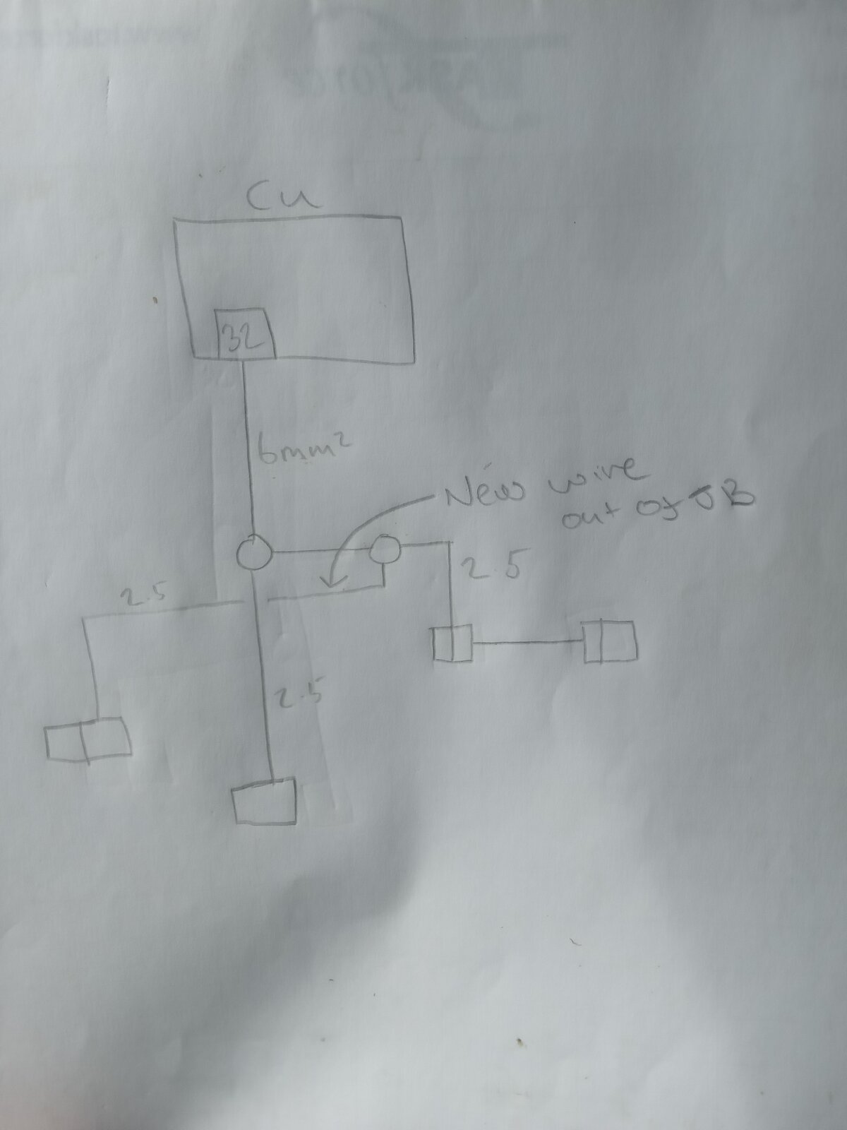

Hi everyone, would it be OK to add a second junction box strait from the first in this radial circuit as can't really access the first junction box?

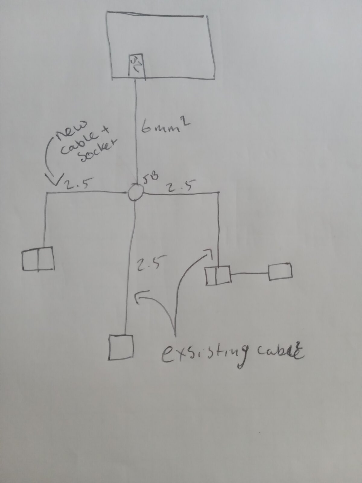

Would it be OK to take a 3rd cable out of the first junction box like this? There is a hole for a third wire just a bit fiddly to get to
That would be alright.
Note though that you have two sockets on the right hand side cable.

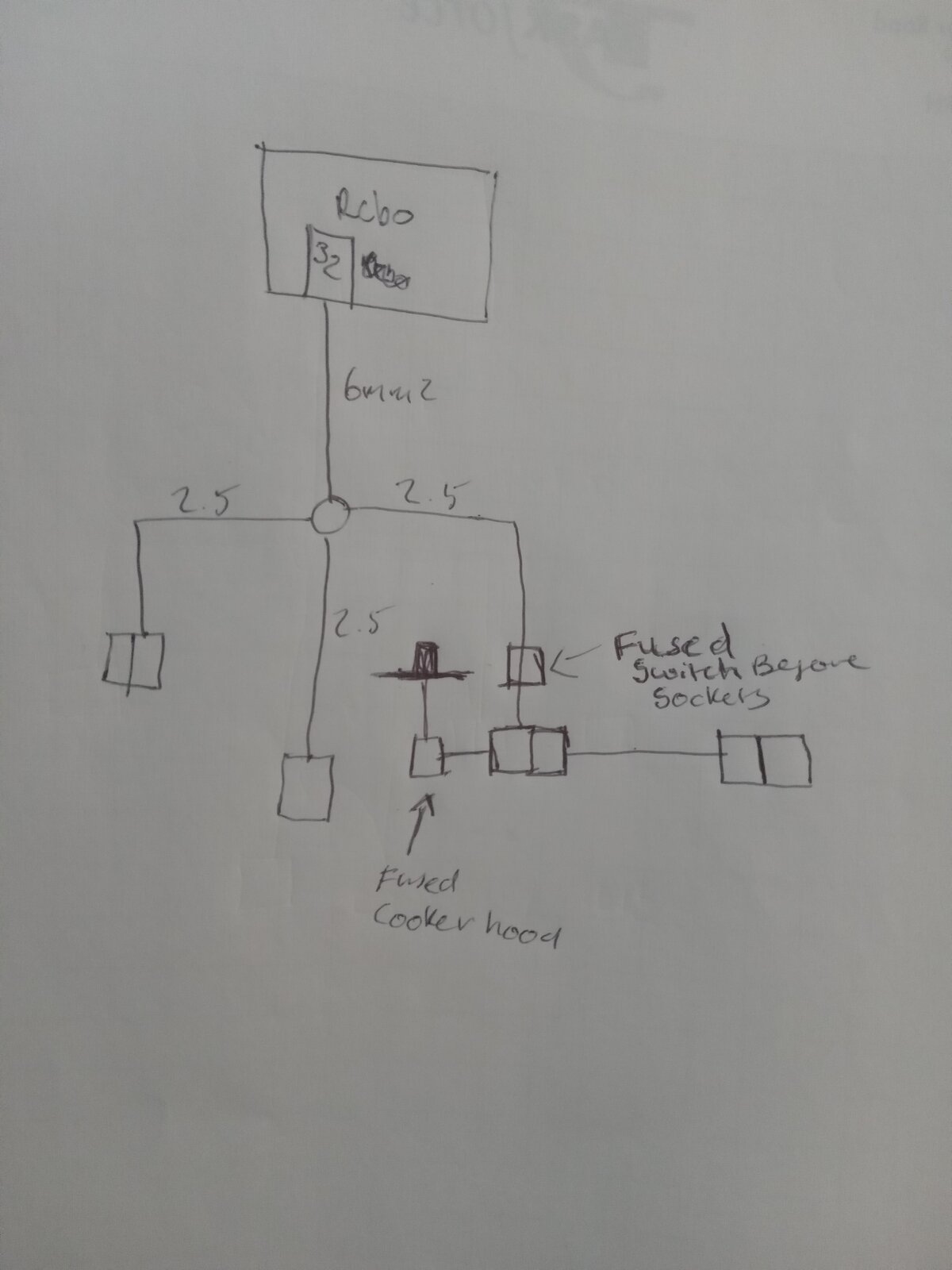

There has always been 2 there the second runs the fridge freezer, I have added a fused spur from the first socket on the right for a cooker hood. Dose the second socked need to be fused?
If there is more than one socket on the spur then a fused connector unit should before all of them.
Easiest thing to do would be to change the MCB for one of 20A then you can have as many sockets as you want.
Sorry for all the questions dose it make any difference if its on a rcbo than a mcb
So should look like this
