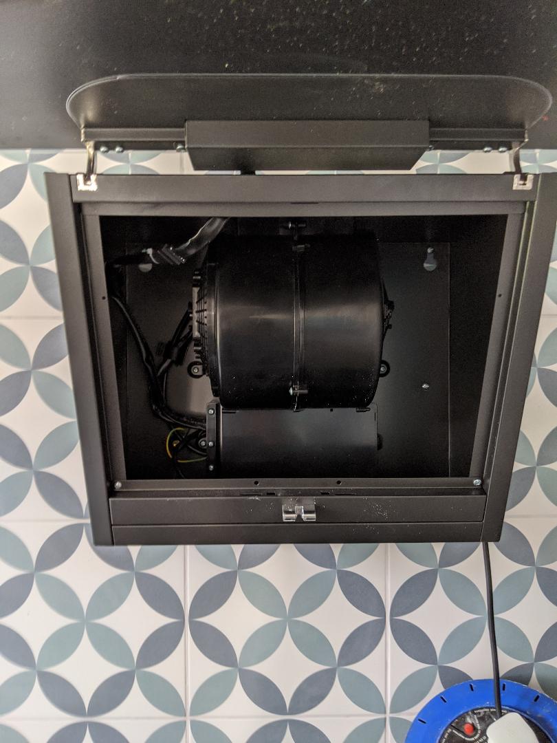

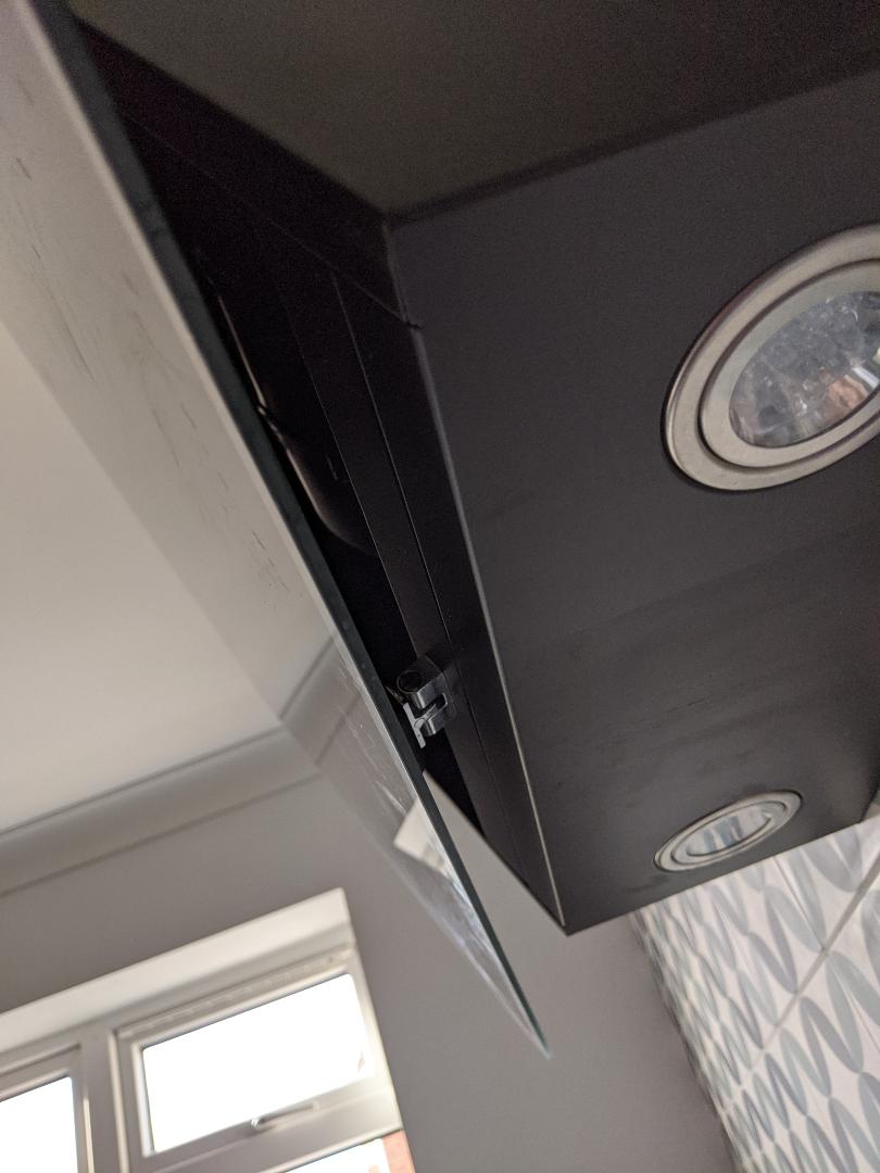

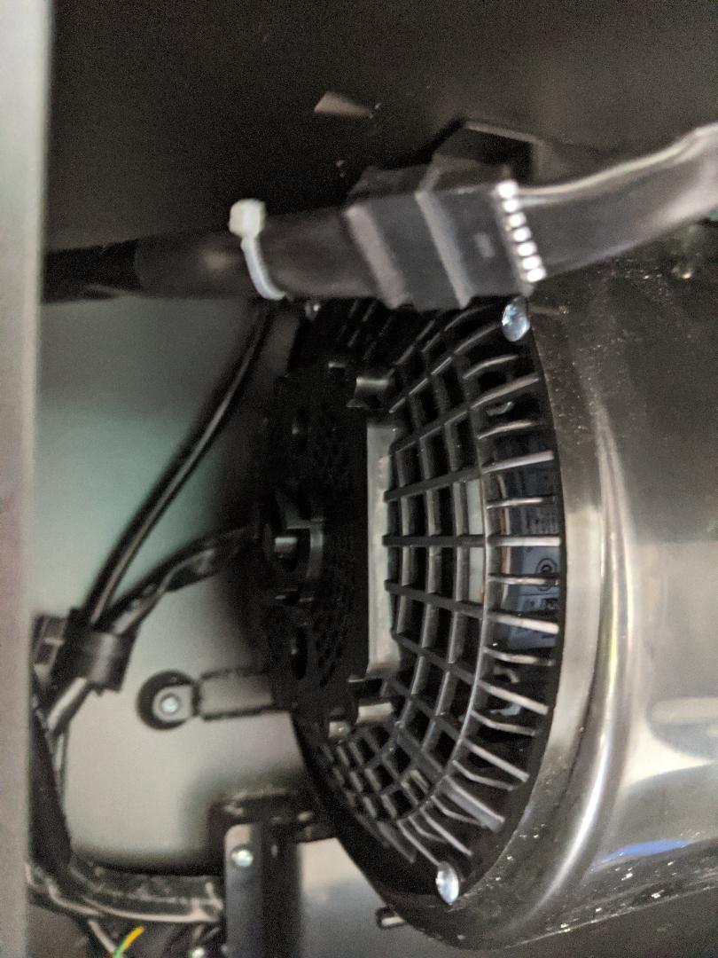

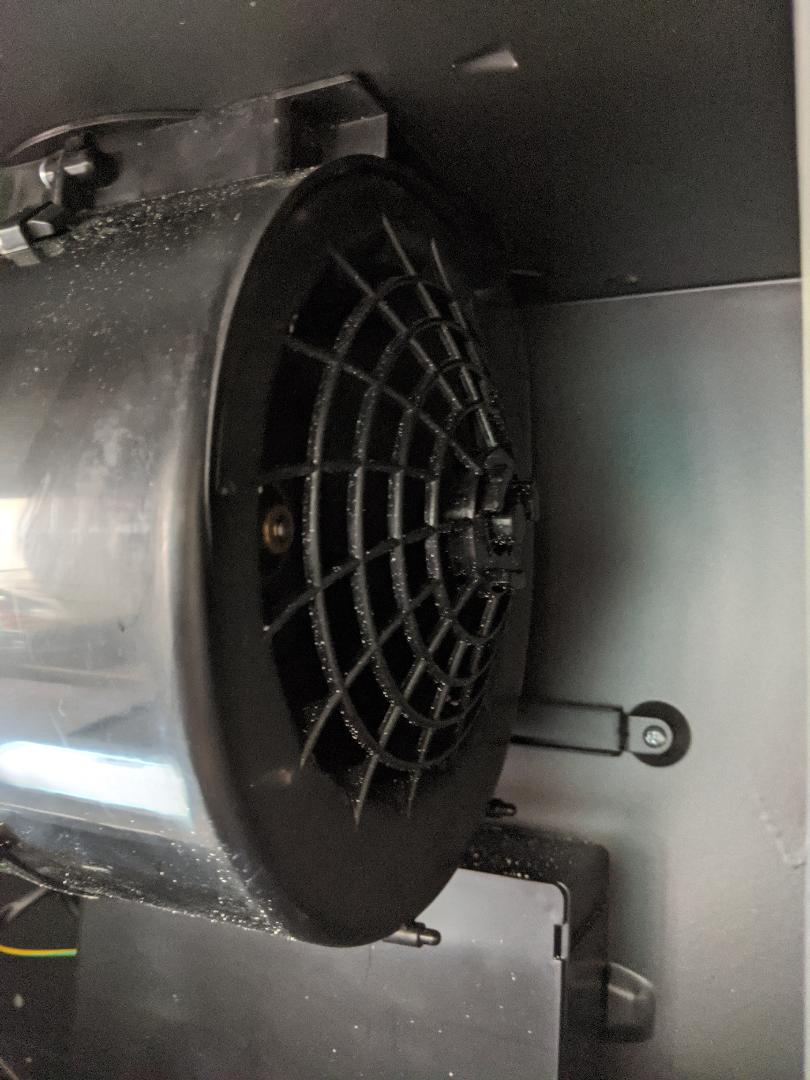

No, you lift the glass front up and there is the big motor in it. It looks like the right hand side is where you can put the filter in if its not using the ducting (it doesn't have one in as you need to unscrew it to put it in)
If you put your hand on the motor there's no suction as all but the top vent is pushing air out.. its got the little backdraft doors on which flap open when its on full power.
The unit is really noise and the air coming out of the top is pretty fast.
He did take photos too as it invalidates the warranty if you use the wrong ducting.
The wife was there not me but there is nothing being drawn into the unit to extract it back out.
I've taken some photos, when I remove the ducting I can see the top is blowing.
There's no suction at all from the bottom.

i wonder where the air comes from, that it blows out.
Can you hold a smouldering joss-stick or cigarette to it?
then air must be being sucked into the "ends of the barrel" where the blower is.
Test it with a smouldering joss stick or cigrette, or scraps of tissue.

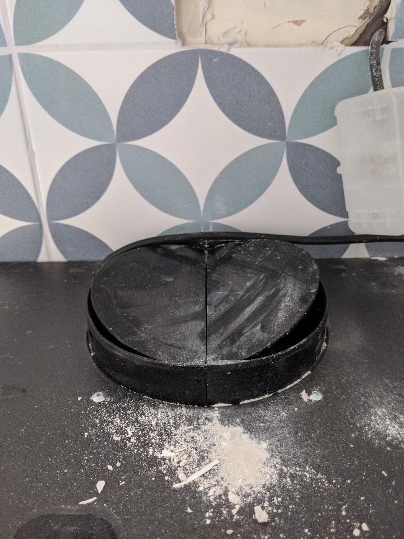

Show us the adaptor you fitted to the spigot with the butterfly valve.
next to, and on, the spigot.
Does it touch the butterfly?

What did the engineer say this was caused by? To me it still seems you have a faulty fan & it definitely is not caused by a reducer which would invalidate the warranty.
Ask the supplier to replace it if the engineer did not fix it.
As for air flow, the only apparent thing in your pics is as John says it may be the back draught valve not opening properly, it should be very light & loose fitting in the opening.
