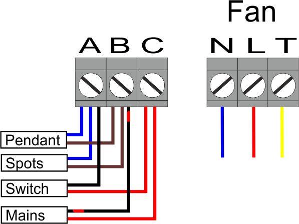

Hi All,
I have an Airflow Icon 30 fan with timer module for my bathroom, the module has the terminals N L & T on it, i am assuming that N = Neutral, L = Permanent Live and T = Switch live, in that case the attached should be wired i think N goes to A L goes to C and T goes to B is that correct or am i wrong? Cable from the fan is 3 core + earth.
