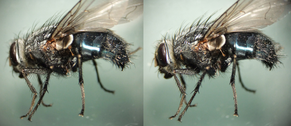

I have experimented with macrophotography in the distant past when I had an SLR, lenses and bellows. In fact, I think I still have them somewhere, but I haven't used 35mm film for many years.
More recently, I have taken some 3D pictures using a compact camera which I attached to a stereo dissecting microscope, each eyepiece in turn. I attach an example. (There is no need of any viewing device; just cross your eyes until you see three images and concentrate on the middle one.)

If you do stacking you can produce a good stereo image from that with Zerene Stacker. Tutorial HERE
Not everyone can cross their eyes to "fuse" the pictures, though it's worth teaching oneself!
