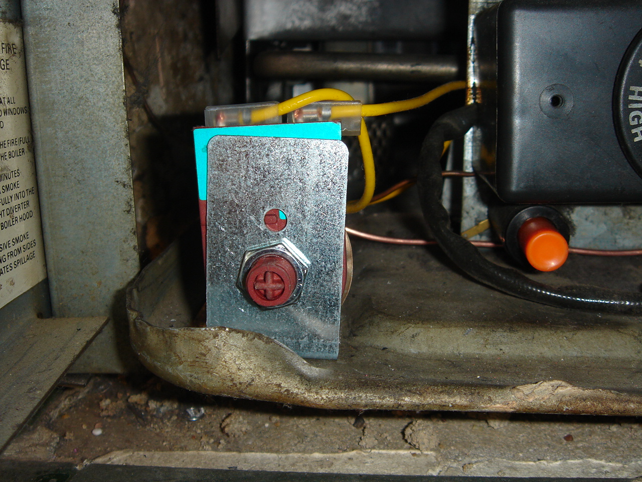

Update, problem solved !
I replaced the gas valve & set the burner pressure to 10 m/b (old one was set at 14 m/b.
Now everything is behaving great. ( customer phoned me 3 days after to confirm)
Thinking about this, I reckon that although everything is behaving, there must be a partial blockage somewhere in the system & reducing the burner pressure just means that it's not under as much stress now.
Thanks for all the advice.
