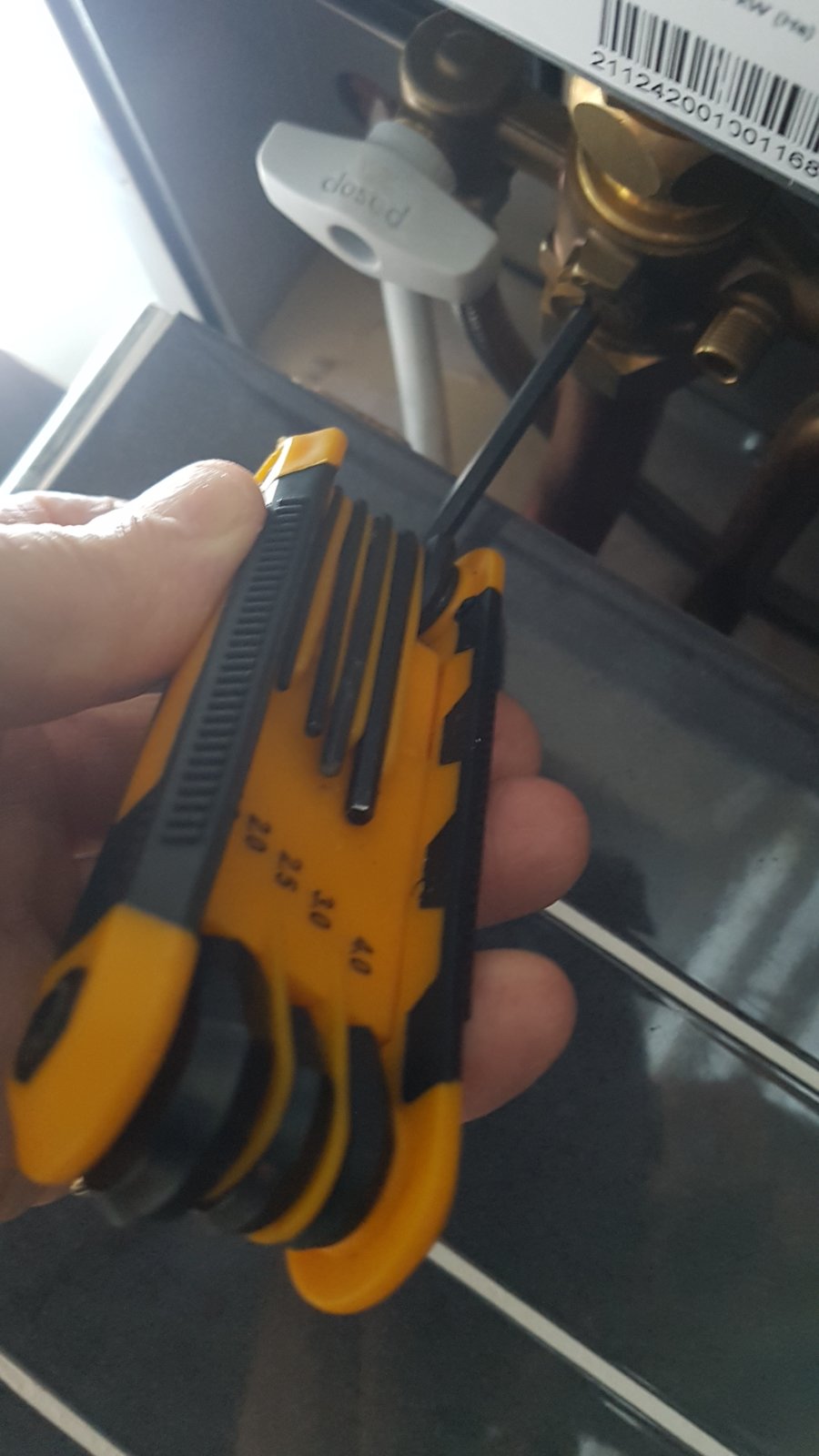

No, there’s 4 isolation points (3 if it’s a cylinder setup) under the boiler where the pipes enter/exit the boiler made from brass, using a 4mm Allen key turn the x2 outer ones all the way, to the stop point, you’ll know when.

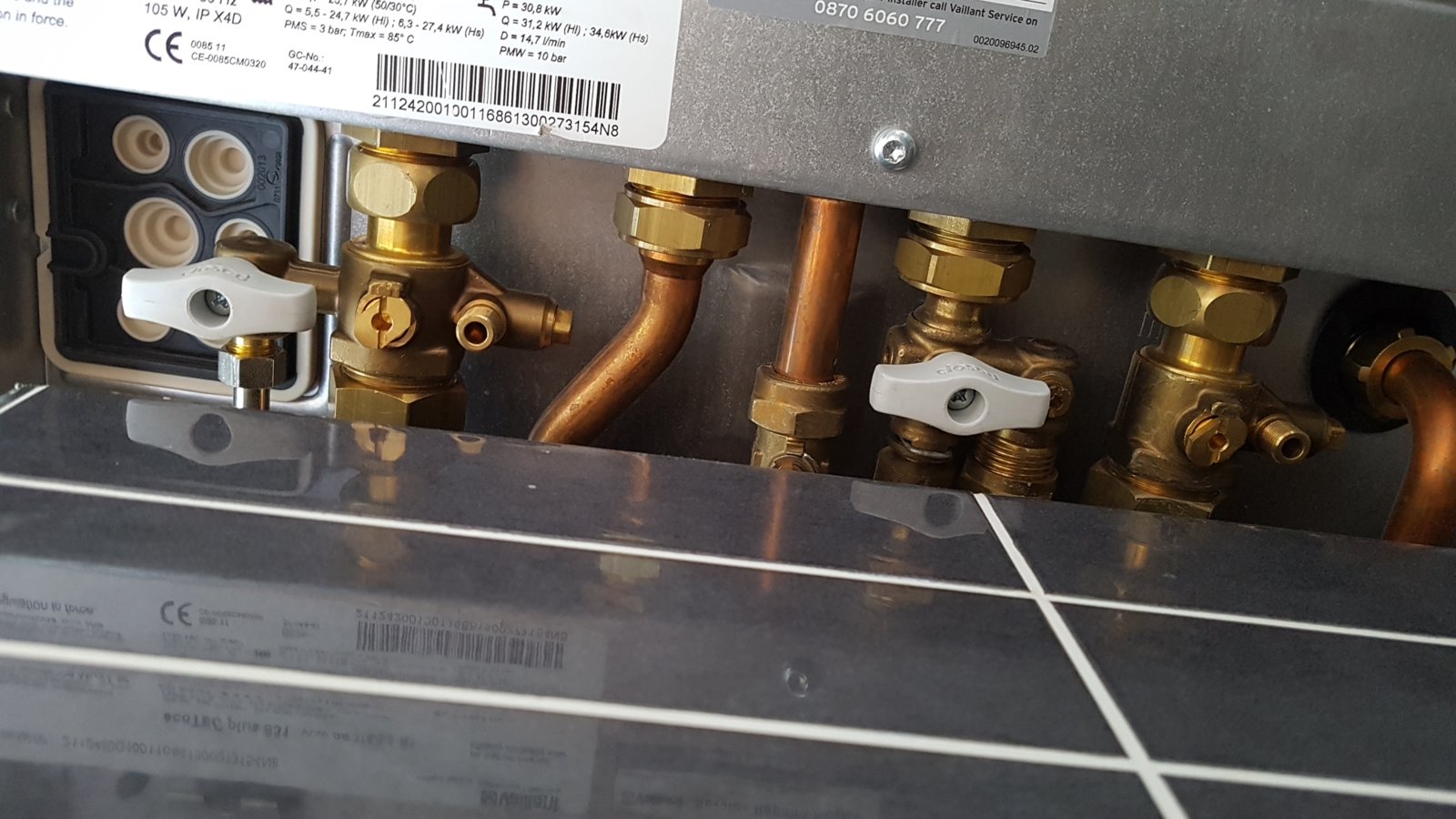

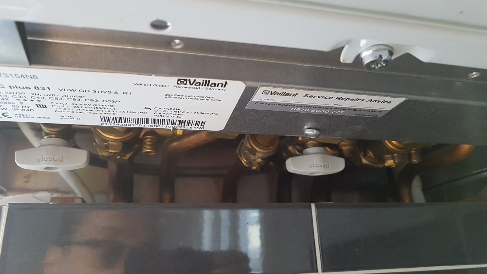

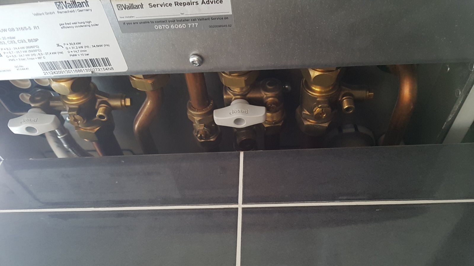

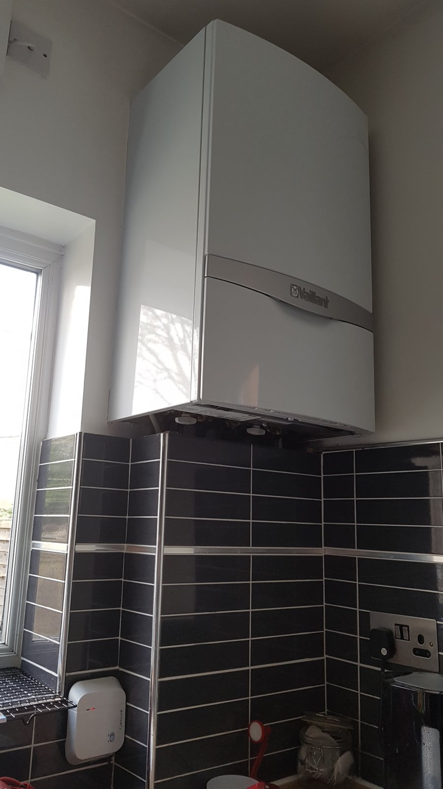

I've uploaded some photos from different angles. As you can see, below the boiler is boxed in. But I'm assuming/ hoping they allowed for access to important valves and I'm guessing there's no allen key points lower down where I can't reach.
There's 6 brass pipes but are you able to see anything here that would be the isolation valves I need?

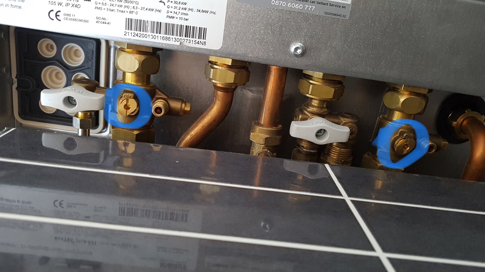

Ok, so these two circled in blue are your flow and return

Awesome! Thanks for circling those, makes it very clear and easy for me to know how to do it now. Thanks given, my pleasure.
Don't use the wrong allen key OR be too over exuberant else you'll round them out in the brass and knacker them... Gentle steady force and they only turn 1/4.
Thanks dilalio. Looks like I have a 4mm and it fits perfectly. :)
