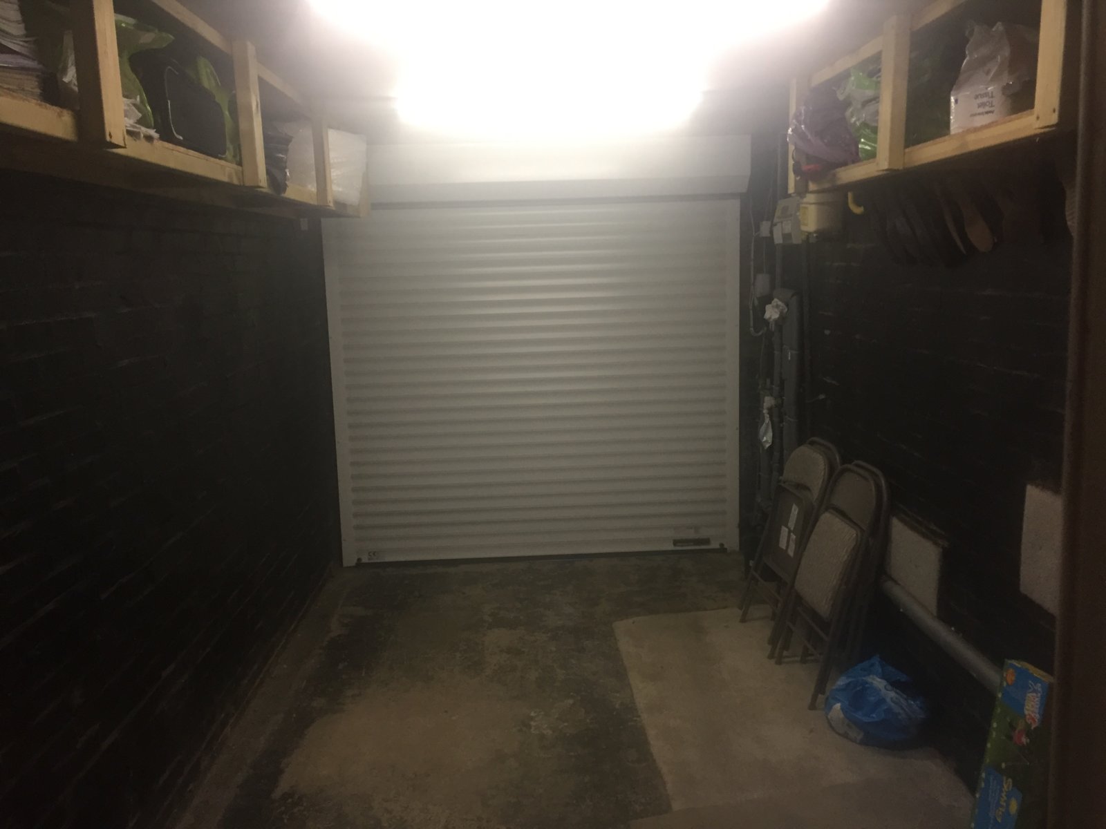

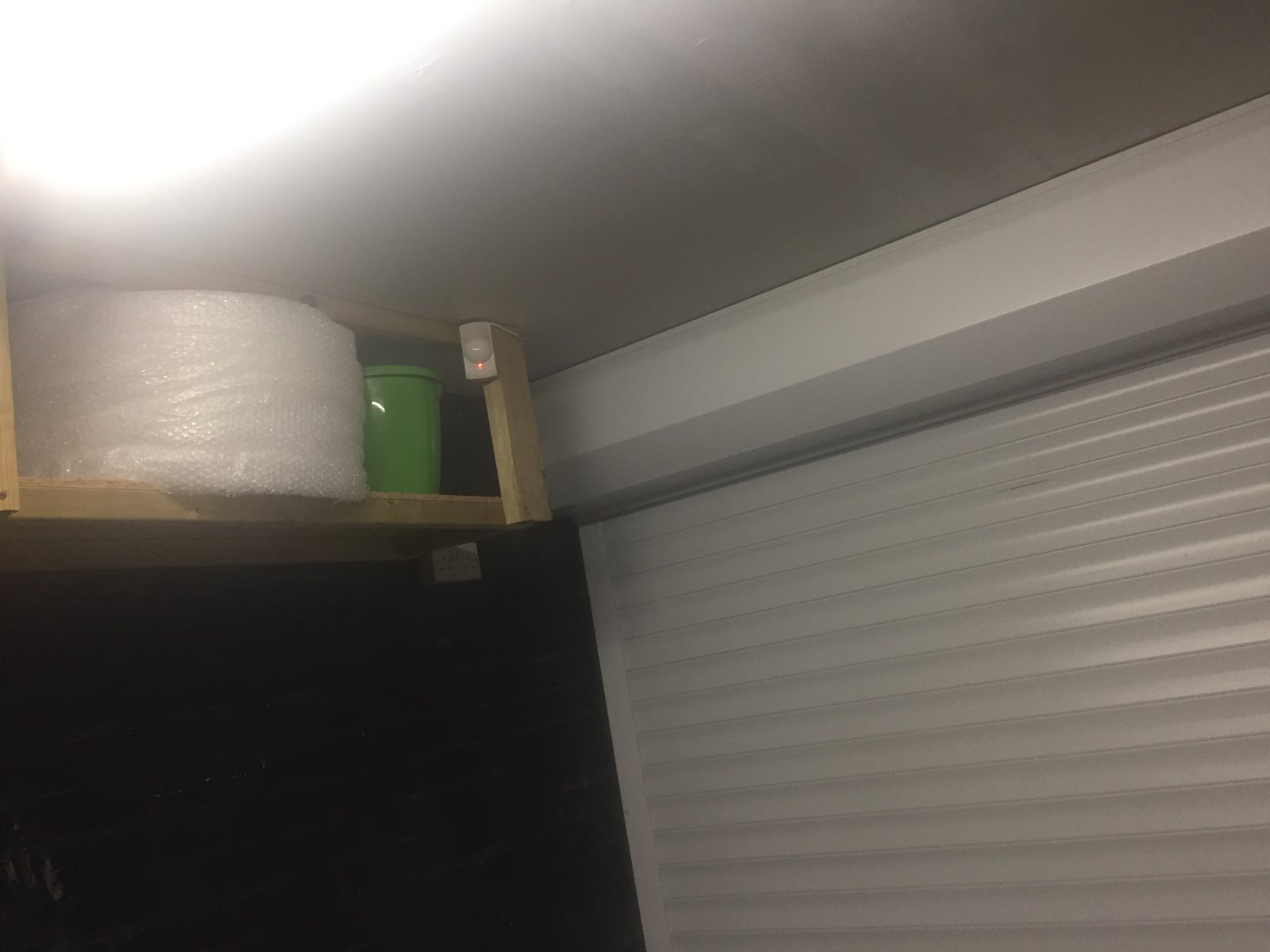

Draught is a possibility here as the back of the sensor is facing the garage door and there are definite air gaps in the garage door. Doesn't the sealed unit and DT mitigate against this risk though?
Post a picture of the location of the detector ....is there shelves/ units below or near the detector as vermin close to the detector can set it off
Picture of detector and the room. Whilst I would never say never but there are no signs of infestation.
On voltage, I did notice the following: when red probe is on + and black on -, I got 15v.
If red probe is on + and the black is on one of the tamper terminals, I got less. Around 13.

Taking a voltage reading between the + and tamper/alarm terminals won't tell you anything useful. 15 volts definitely sounds a bit on the high side, 13.6 volts would be a more acceptable reading. How sturdy is that timber frame that the detector is mounted on? You'd be surprised at how much structures like that can actually move (especially in the recent hot weather we've had) Not saying that's definitely it but I'd be happier with it mounted on the wall.
The wooden frame is absolutely solid. Opted for this as the wall doesn’t give the PIR the right angle across the entire garage.
I’m happy to measure the voltage again tomorrow. Assuming it’s 15 again. Where do we go next?
