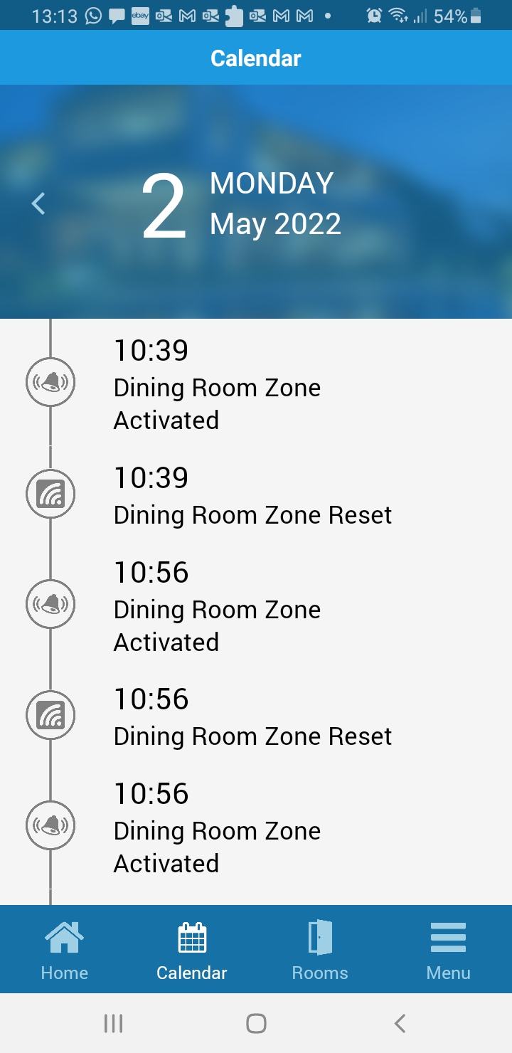

Dear All,
I wonder if anyone can help.
Have had premier elite 24 with a one entry exit contact sensor, around 6 Prestige TD WIRED PIRs and one keypad.
It's been problem free for 6-7 years.
Now initially, in the night, the downstairs hallway PIR would set off the alarm every 4-6 months and I just blamed the kids.
Now the false alarm is more frequent ie weekly. The issue is that one day the hallway PIR would false alarm and now the dining room PIR false alarmed.
No cobwebs. No obvious cause. PIRs on the wall. I have opened the hallway PIR and it's clean and sealed. Location of PIRs unchanged for years. No renovations to disturb wiring.
Voltage at PIR 13.8v stable. Sometime I remotely monitor the sensor via the app when I get a false alarm and sometimes the offending PIR shows movement when the house is absolutely empty.
If it was just one sensor, was going to clean out then replace but now it's different sensors.
What shall I do next? What's going on?
Thank you so much in advance.
Please see pic

I have taken on board your advice and this is what I have found:
No particular pattern of timing of alarm set off BUT I have found that when I leave for work in the morning and I arm the house alarm, by the time I have closed the exit door, locked up and sit in my car, sometimes the alarm will trigger.
I looked at the log, I can see the following in the log list - sometimes linked to a false alarm but not always: 'Charger Fault'
Other things at control panel:
Battery voltage with charging cables: 13.81v
Battery voltage without charging cables: 13.62v and the voltage drops by 0.01 v every minute
Power to PIRs at control panel (green/white wires): 13.83v
AC voltage between 12v for PIRs at control panel and the power supply earth: 0.00ACv
Wintex: system voltage: 13.92v, Battery voltage 13.76v, System current 0.350 amps - these three values slightly fluctuate
In terms of resistance at zones (with multimeter set at 20k ohms (I don't have an auto ranging multimeter):
Z1 Entry/exit: 2.14k
Z2 Access guard (where keypad is): 2.16k
Z3: 2.15k
Z4: 2.16k
Z5: 2.15k
Z6: 2.15k
Z7: 2.17k
Z8: 2.18k
When I check zone resistances in Wintex, they are all equal at 2.13k
In terms of false alarm zones to date, they have been Z2, Z3, Z4
PIRs can never have direct sunlight. They don't 'view' radiators/windows.
If I had a charger fault - I am guessing this refers to PSU - but I am getting full voltage to PIRs at panel and batter is being charged.
What are your thoughts?
