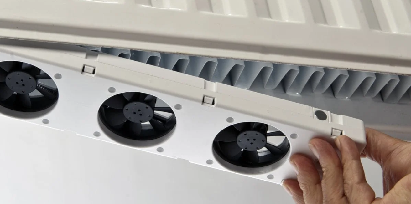

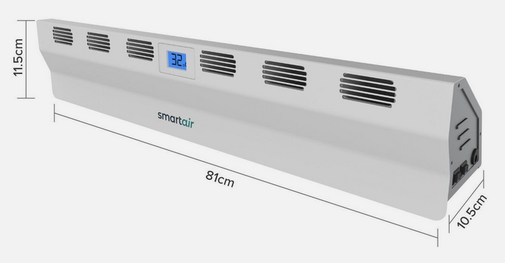

I used an upright fan at mothers old house, with the thermostat used normally for beer brewing to turn it on once pipes got hot, but it was too much, and cooled radiator right down, these 1705749921097.png are designed as an add on, but at £45 a bit expensive for a lump of plastic to direct the air from a computer cooling fan and a sensor so only runs when radiator is hot, they are 12 volt, with a wallmart power supply it seems. This one at £70 1705750279960.png is rechargeable, and this one 1705750471552.png fits under the radiator. Again £70 seems expensive for a thermostatically controlled fan. I having used a Myson am aware of the advantage of moving the air a bit not quite as this shows 1705750732015.pngbut it does help moving the air a little, but there are also some down sides, I noticed with hot air central heating there were no hotter or cooler spots, including next to as then single glazed windows, so heat loss was increased, today have double glazed windows, so not quite so bad, but a little wary of spending out a lot of money for some thing which may not work.

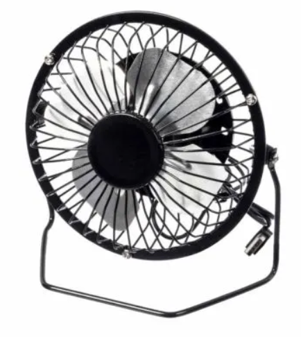

So a £7 desk fan 1705751203741.pngUSB powered seems a better idea. But I am surely not the only one to consider this, so is it worth setting up thermostatic control for such a small fan? And has anyone tried it? If so how did it work?
I could easily reproduce that, just from bits I have laid about in my workshop, simply switched by a pipe stat.

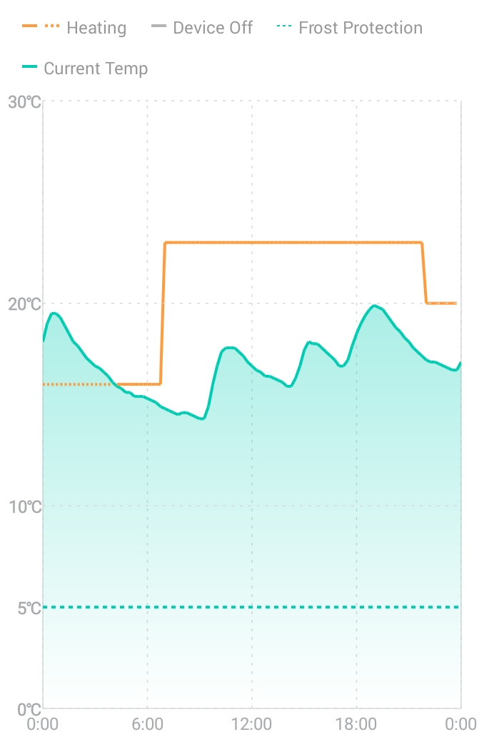

Found my TRV gives the performance for the day 1705771987836.pngI can see the hysteresis for 1st January, that is clearly a problem, only found it on my app today, so it seems some thing is turning off when it should not, so now need to find out what.

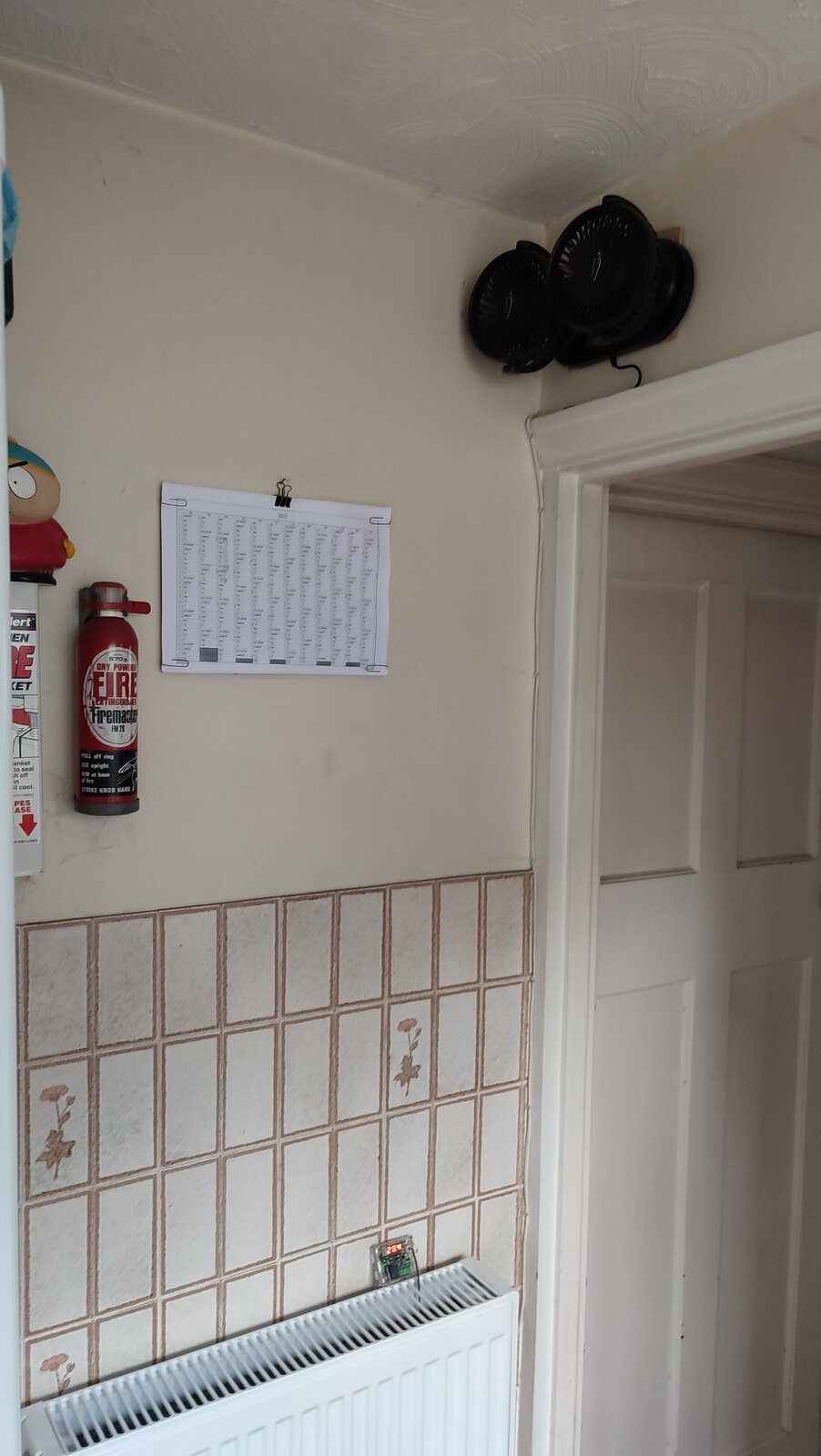

We had our 40-year old c/h system replaced with a combi boiler + all new radiators.
The old system had a huge cast-iron boiler in the kitchen which, while inefficient, heated the kitchen itself.
The new system had one radiator at one end of the kitchen with the result that the other end of the kitchen never really heated up and was always freezing.
I bought a set of 12V car dashboard fans + a thermostat off Amazon and rigged them up to an old laptop power supply I had laying around. The fans are at ceiling level above the radiator and blow towards the far end of the room.
The difference is astounding, the far end of the kitchen, once freezing, is now the first place in the house to warm up.
