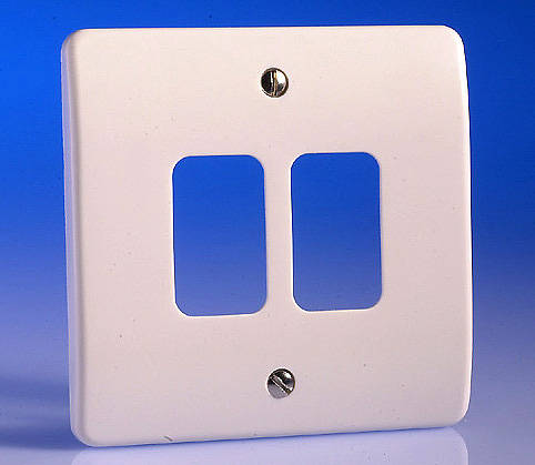

I have a two gang light switch outside my bathroom, one of which controls the light and one controls the extractor fan. I want the light to be a dimmer switch, but i know that the fan can only be off/on. I only have room for one light switch box on the wall. I have bought this dimmer switch thing off ebay with no instructions - it looks like a regular dimmer switch except it has a picture of a fan on the knob. I was led to believe this would allow an on/off for my fan, and a dimmer for my light, but on the back I only have a L1 socket and a C socket.
Surely with only two terminals I can't do what I wanted?
Hopefully someone can help!!
No, you can't, you've been misled.
If you only have room for a single switch plate, you'll have to use a grid-plate system.
You can get 2-module grid plates:
And then you stick in a dimmer module and a switch module:
Robert's your father's brother.

you should stick to just one brand for a grid assembly as there is no standard id personally advise MK (which is what bas pictured)
note: you will need a deep box probablly a 40mm
dimmer
http://www.tlc-direct.co.uk/Products/MKK4501.html
switch
http://www.tlc-direct.co.uk/Products/MKK4881.html
2 gang plate
http://www.tlc-direct.co.uk/Products/MKK3632.html
2 gang grid
http://www.tlc-direct.co.uk/Products/MKK3702.html
the grid screws into the backbox
the switch and dimmer clip into the grid
and then the frontplate screws onto the grid
