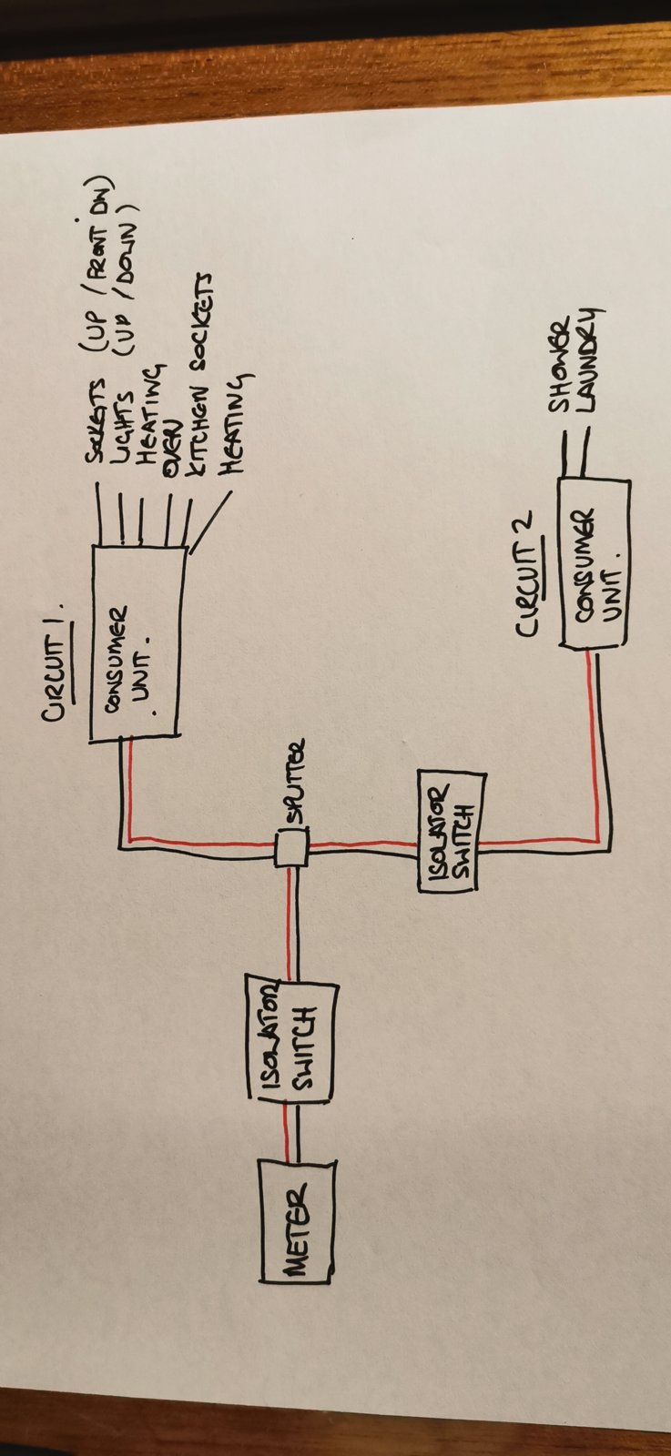

So the last couple of days we've been having random tripping RCD.
Before getting an electrician in, I'm trying to establish at least a cause, to save both time and money.
I've been trying to isolate appliances, but there doesn't appear to be anything specific causing it. Turn the vacuum on, trip. Reset, turn the vacuum on again in the same socket and it's fine. Turn the shower on, trip. Reset, and it's fine. Attached is a rough schematic of the wiring routing, we have 2 consumer units connected with armoured. Each with their own RCD.
It's ONLY Circuit 1 that isolates the RCD trips on. Note the shower is on circuit 2.
Any ideas?

From what you say, I suspect that you may well have a neutral-earth fault somewhere - either in an appliance or the wiring. If that were the case, then 'isolating' appliances with a switch might not cure the problem, because the switches may not be double-pole (i.e. may not disconnect the neutral) - in such cases, unplugging or physically disconnecting are the only ways to fully 'isolate'.
Kind Regards, John
Thanks John, I have been doing that to appliances.
The thing that is confusing me, is the ability of the trip to cross from one consumer unit to the other. Consumer 2 never trips, also the RCD in consumer 1 is new and exhibiting that same behaviour.

The schematic I attached on my first post shows it diagrammatically.
Are all circuits in both CUs protected by the CU's RCD, or do one or both of the CUs have some non-RCD-protected circuits?
As far as I'm aware, all individual circuits are protected by one of the CUs. I'm not aware of any circuit that's not fed via an RCD.
The feeds are shared before the CUs, and split near the meter.
Hope the picture helps to show the layout.
I do diagnostic testing as part of my job, but this one has me flummoxed.
I would presume that as the earth's are shared so the earth-neutral fault would be on CU1 as that's the one that's tripping, however by increasing the load in either CU1 or CU2 will replicate the fault. Am I looking in the wrong area?

Yes, I think that an N-E fault would have to be on one of the circuits fed by the CU whose RCD trips. As for your "however..." .... now that you have read a bit about neutral-earth faults, you probably understand a bit better ... assuming that the situation is not complicated by some circuits which are not RCD protected, then, even if the load you increase is on CU which doesn't trip (whose RCD will not trip, since all of both L and N current from that CUs loads will go through its RCD) some of the neutral current which should have gone from that CU to the supply neutral will be able to 'go backwards' through the RCD in the other CU (the one whose RCD trips), thereby causing an imbalance in L and N currents (hence a 'trip') in that RCD. If the load increases on a circuit fed by the CU whose RCD does trip, then the mechanism is more obvious!

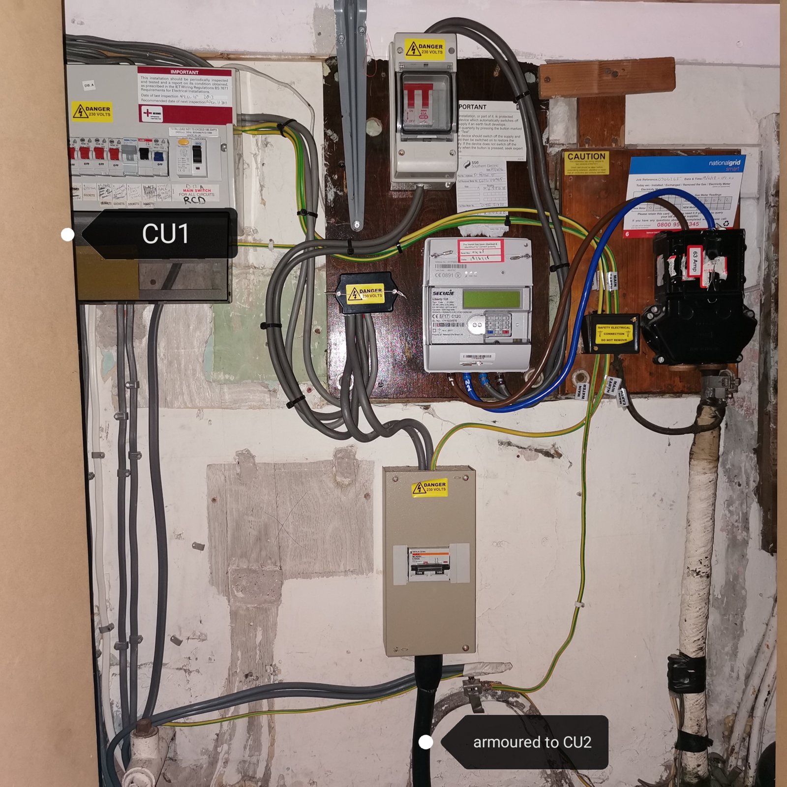

The house itself used to be a Residential Home, and was tested annually, the armoured extension to the second CU was installed then as part of an extension build. The only changes since it was domesticated is the RCD has been changed to discount a faulty RCD and a new boiler installed, replacing an aging dinosaur that failed causing a leak into it's internal electrics a few months back (this was when the RCD was changed as the electrician that attended didn't/couldn't find a fault)
When I did my initial fault finding I didn't know as much as I do now, I'm going to have another decent look tomorrow morning when there isn't a plethora of people in the house.
