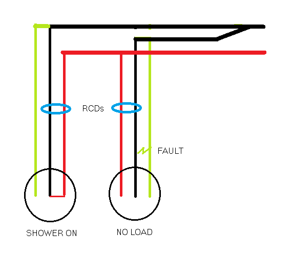

Yes, I was talking about the diagram in the link where that is not the case.
I don't see how your shower current can 'back-feed' through the other RCD.
