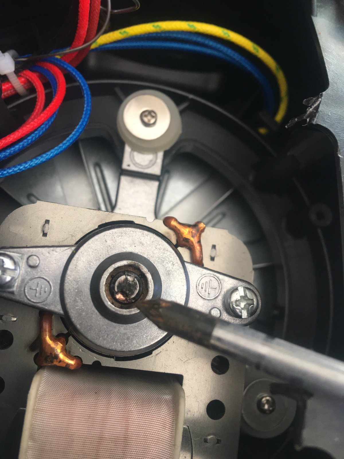

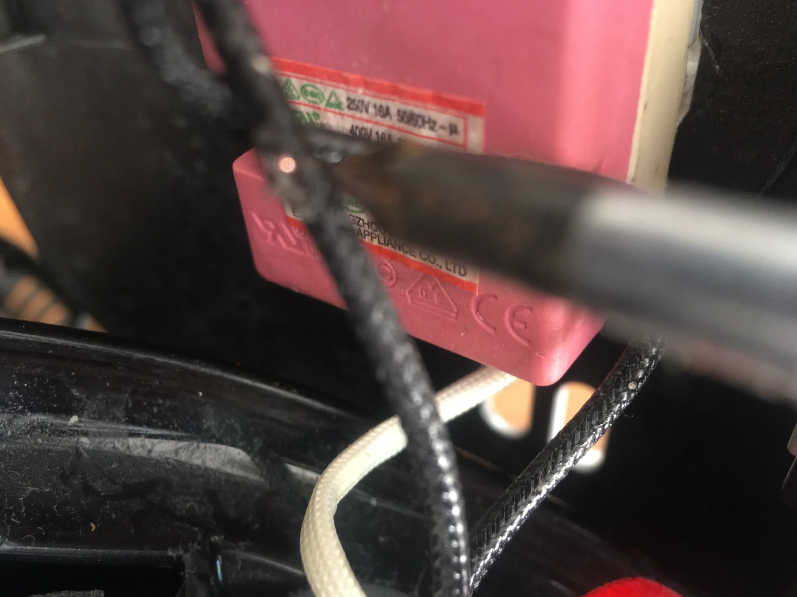

Just a heads up for anyone who's air fryer goes bang.
Took mine apart and found the tip of the fan bearing was in contact with a wire from the thermostat, wore thru and shorted out. You can just see the gleam of the copper on the wire and bearing [pointed out by screwdriver].
