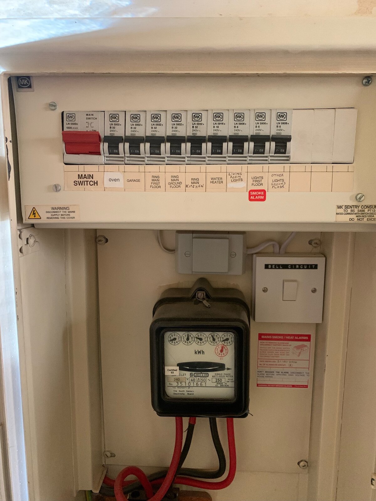

I have an old consumer unit that does not yet have RCD protection, (wired in the early 90s). At some point I will be getting a sparx to replace the MCBs with RCBOs or even the whole unit.

Ah, that's quite old. I don't think you'll find RCBOs to fit.
