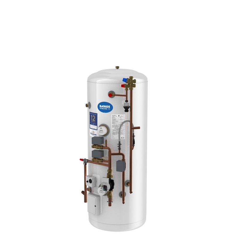

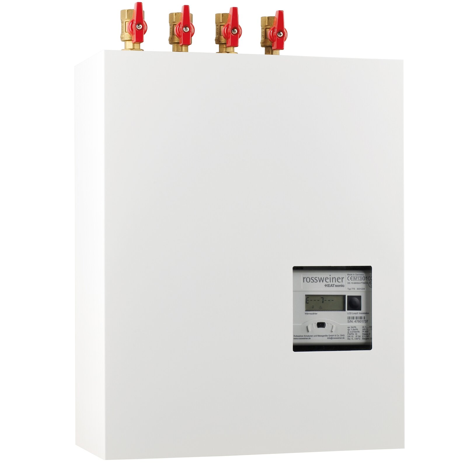

Hello everyone,
I moved in into "new build" back in 2015. Single bed apartment with the following configuration in place:
1) Communal heating where HIU is installed in every flat.
Rossweiner heat sonic.
2) KINGSPAN RANGE TRIBUNE HE 210 LITRES UNVENTED VERTICAL PRE-PLUMBED INDIRECT HOT WATER CYLINDER
3) There's underfloor heating installed
4) No GAS
PROBLEM STATEMENT.
South East of London - extremely HARD water area. Over the years heating spiral inside the tank degraded. It barely able to heat the water up to 40C and it takes forever (very expensive nowadays).
Note aside: immersion still works but won't last long.
I would like to replace my current system. What i am looking for is:
1) I must keep HIU - that's untouchable.
2) I would like to get rid of the water tank it is occupying a lot of space in tiny apartment.
3) Instead i would like to have a combi boiler (electrical as there's no GAS). Instantaneous heater.
4) I would like to install water softener connected to the main before boiler. Currently it's not possible as there's no space for it due to water tank.
QUESTION
How will HIU work together with the combi boiler? Is it even possible?
What could be the right solution here?
I understand that replacing the tank likely to be the simplest one however it is not what i am looking for.
P.S.
I am even happy to switch off HIU flow, keep paying standing charge as long as I can get rid of the tank and install alternative heating solution that cost less and easy to maintain.
Irregular usage of the current system is what accelerate limescale production inside the appliances. Due to personal reasons it could be that I leave the system completely shut for weeks. Replacing a tank every <5 years is not a good option. Softeners, even the smallest still require some space that I can't allocate at the moment.
Any suggestion/recommendation welcomed!
Thank you so much
Art
Doubtful if the electrical supply to a 1 bed apartment will be suitable for an electric combi.
Even if it was, performance will be mediocre and the cost will be high.
A 210 litre unvented seems excessively large for a 1 bed.
Much smaller cylinders are available.
If there really is no space for a water softener, this: https://www.combimate.co.uk/product/combimate-limescale-prevention-device is a much smaller alternative.
While not addressing the water hardness issue one would think that the thermal charge would be based on a flow meter and the flow/return dT maybe measured on the HIU primary side so shouldn't have any effect on the running costs, to you.
@flameport - 210 litre unvented is what they put in every apartment irrespective of it's size.
Placing a smaller tank would get me some extra space (possibly enough to put a softener). However if there's a chance to get of the tank that'd be my preferred solution.

Would i still be able to connect it to my HIU?
No. That is an electric water heater, there is no provision to connect to anything else.
You need an unvented indirect cylinder, such as this: https://www.plumbnation.co.uk/site/worcester-green-storage-wb-90-litre-unvented-cylinder/ , plenty of others available in various sizes and shapes.
which would normally be heated from the HIU. It does have an electric immersion heater in it but that's only there as a backup for use when the HIU is broken.
