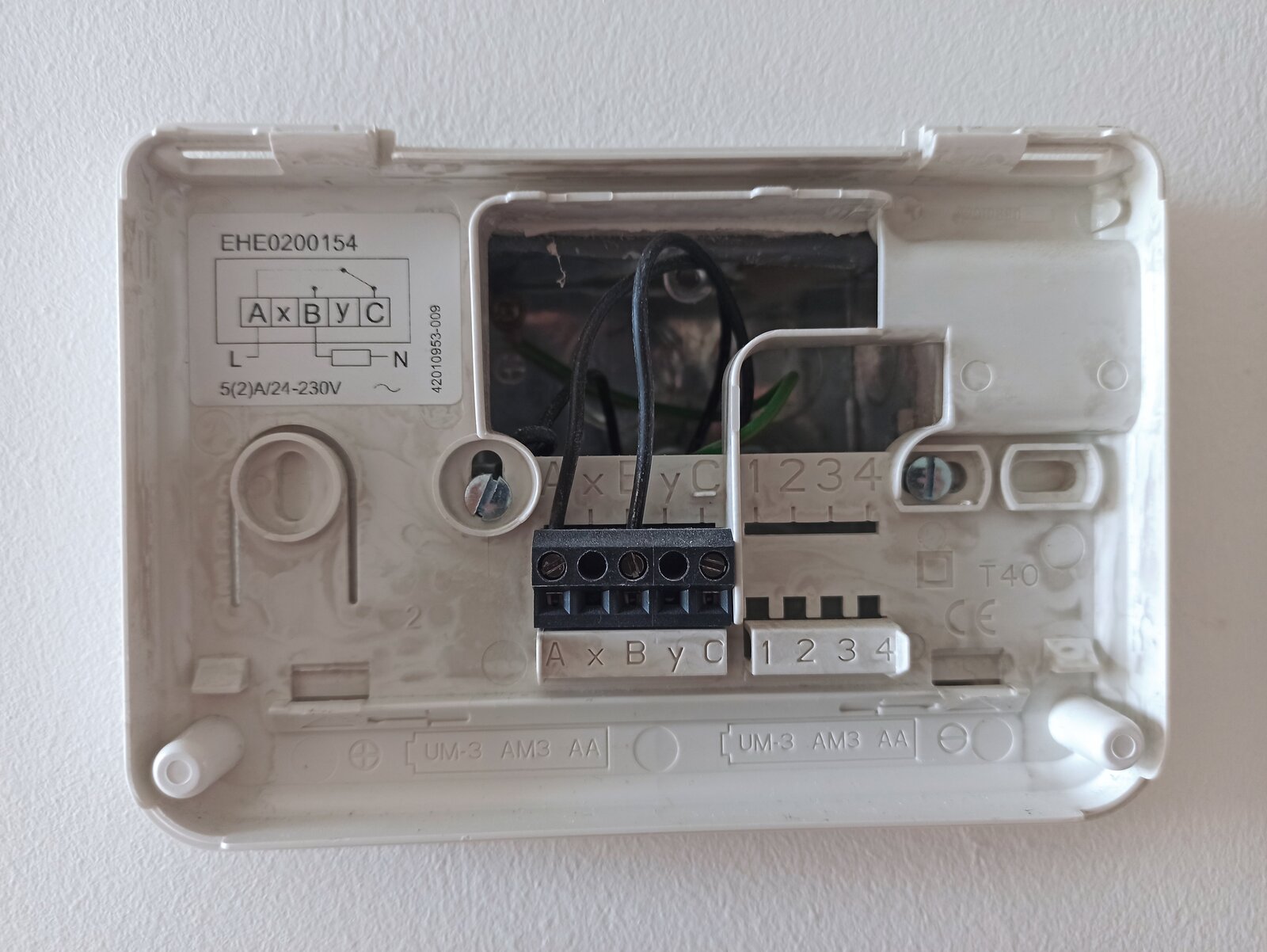

* Current thermostats are battery powered Wolseley Centre EHE0200 (153|154) with 2 wires (L & N) connected

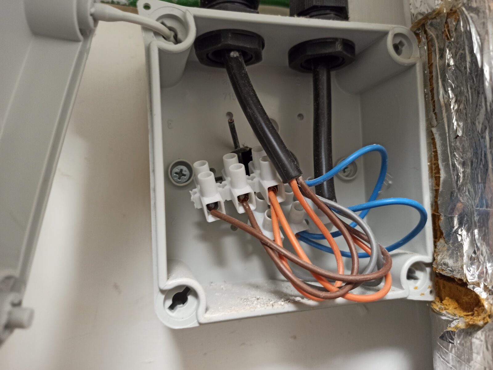

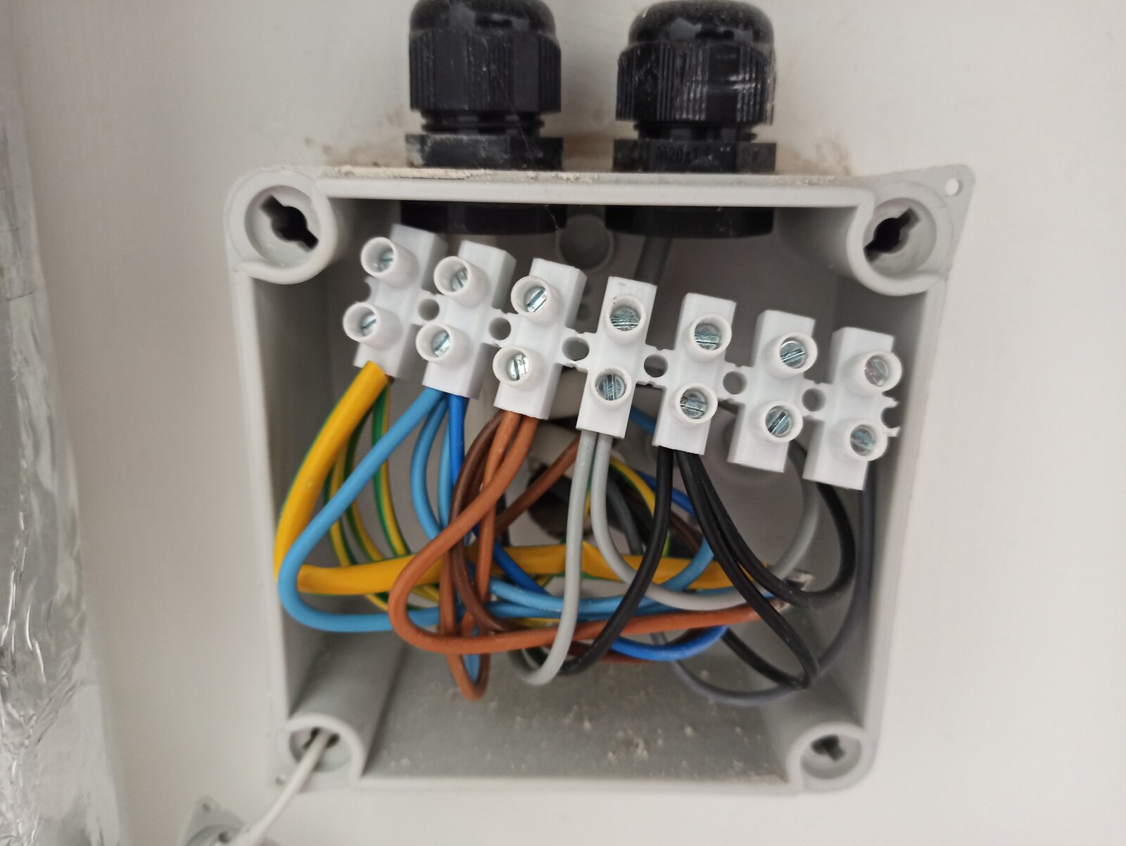

* I have 4 core wires running from the thermostats to a junction box next to HIU. 3 wires (2 connected to L & N on the thermostat, 1 spare). 1 yellow green earth connected to metal back box behind the thermostat

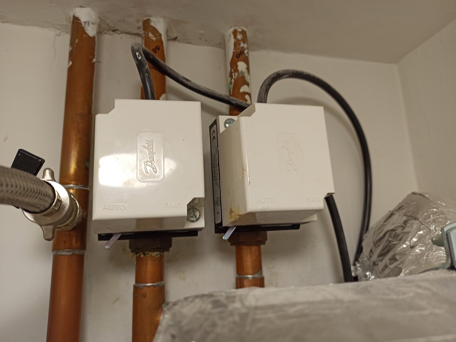

* From the junction box, cables go up to 2 x Drayton zone valves (both currently set to Auto)
* Simply, when each thermostat wants heat, the respective valve is opened, the HIU comes on and hot water travels to the radiators

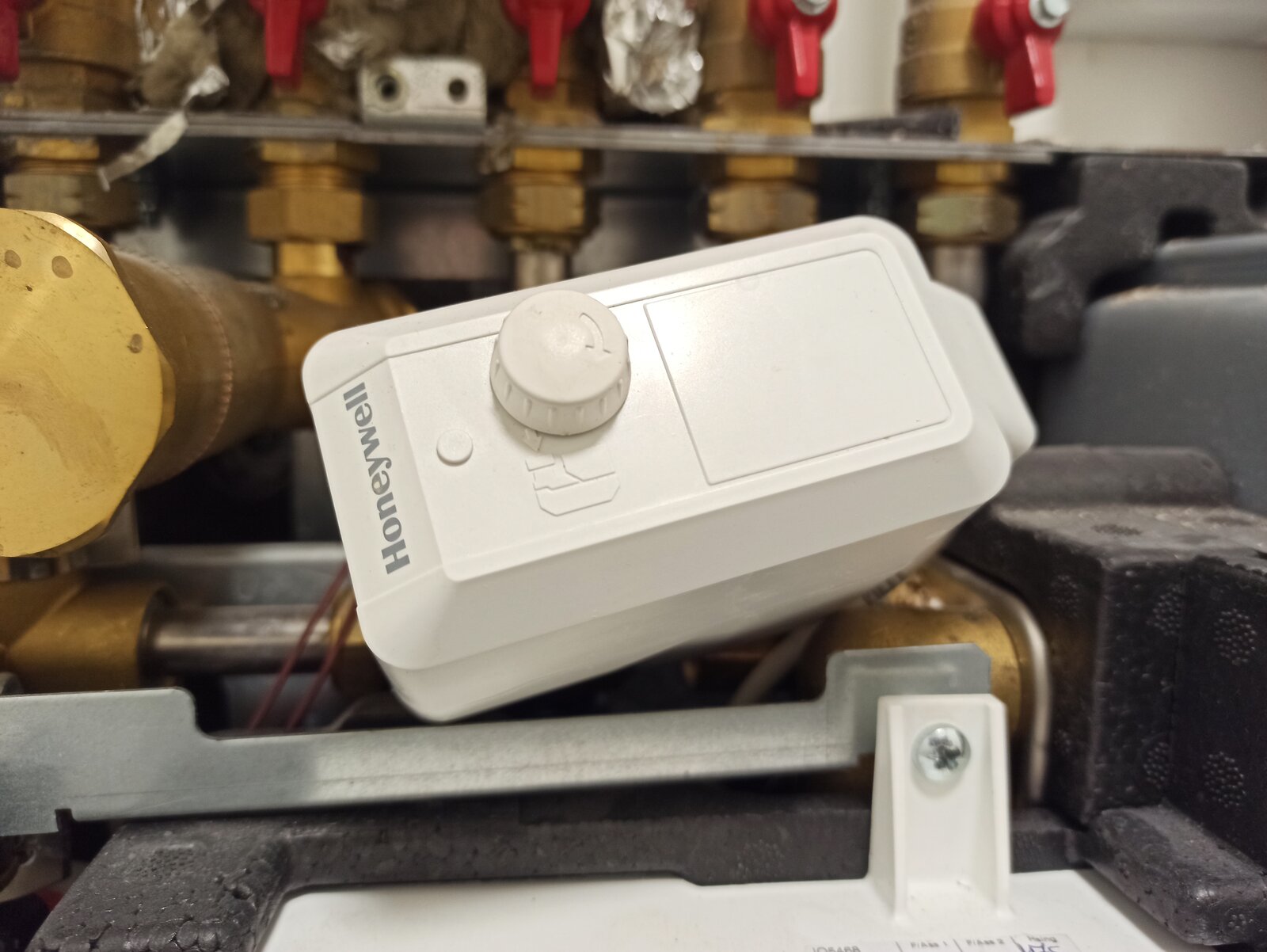

Forgot to add that the HIU also has an actuator. A Honeywell M6410l2023. Not certain if that is used for heating or hot water, or both!
