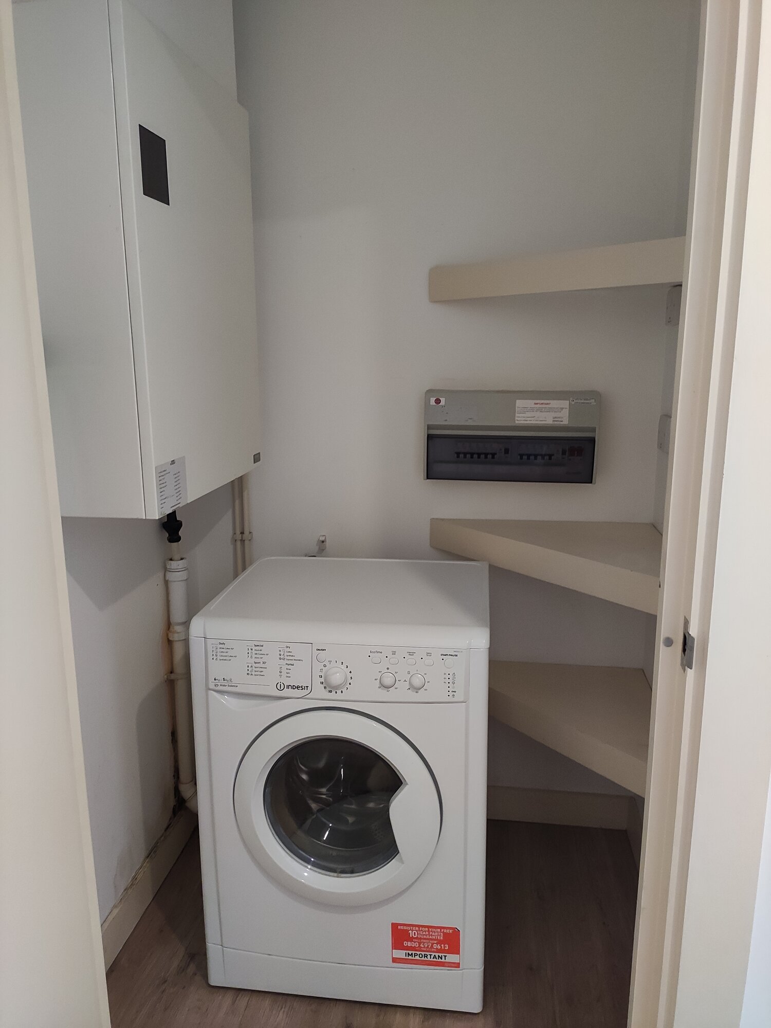

I am currently in a process purchasing a property and just realise it seems to be a leakage on the pipe connecting the HIU (Heat Interface Unit, transfers communal boiler to individual apartment then reheat the water).
I have done some research and it looks like the double check valve. You may see the rust on the wall besides the pipe and the water marks down to the wall edges.
Is it a serious problem and how can it be fixed? Are there other potential issues that I should arrange more testing on?
Thank you so much for your help!!

The heat interface unit that receives the hot water from the communal heating
Is the leak from the black item below the boiler (which I assume to be a tundish)?

The leak seems to be from the white pipe below the black item as the rust starts from there, I am not quite sure about the operation behind though.

Without a make and model it's guesswork but it's normal for the flat side of the unit to be an isolated and pressurised system and if that pressure is too high the safety valve will open and that appears to be the issue here.
The white item is a https://hepvo.com/ trap.
Rusty stains indicate a poorly maintained and corroding system assuming it's radiators...not good.

The Heat Interface Unit is the bridge between the district heating hot water supply and the home heating system. Normally it is 1 or 2 heat exchangers, a usage meter, pump and expansion vessel/prv.
th
If it is leaking at the black item underneath then invariably the system is overpressurising (EV needs pressurised probably), the pressure release valve is opening and dumping water, that water is then leaking from the tundish (the black thing) or lower down at the trap (white thing below it).
The fact that it is rusty water probably means the system water is full of corrosion. As suggested it all needs looked at and sorted before you would buy the property. Good thing it showed up now actually as it means it can be sorted by the vendor before you purchase.

I wouldn't say it's a lot of work, just needs an experienced engineer to give it a once over and sort the stuff out.
Worst case may be the system drained, cleaned, flushed and then re inhibited. A check as to why the release valve is lifting and sort that out (expansion vessel maybe) and find why the tundish/trap joint is leaking. Not a huge amount of work I wouldn't think.
