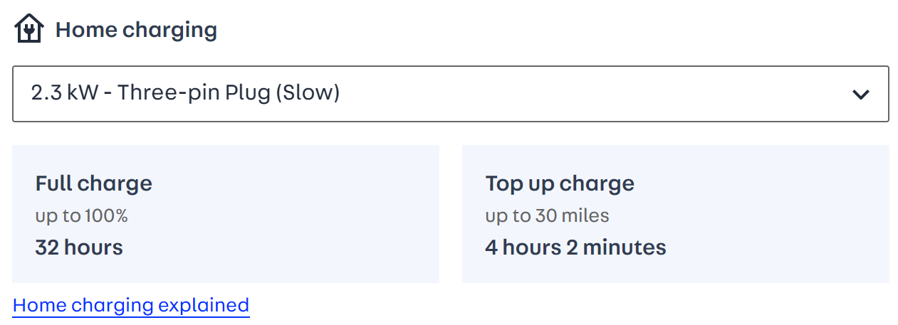

Where are you getting 30hrs at 3kW from? That would imply a total charge of 90kWh...they never made a Zoe with a 90kWh battery. Charging is obviously not 100% efficient, but it's not that bad :)
A quick google suggests a Zoe has a 52kWh battery so you'd be looking at around 23h of charging from 0-100% [which you wouldn't want to do].

The charging info came from the Autotrader estimate for the ad I was looking at:

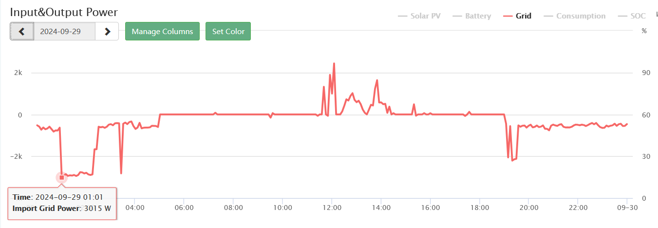

But home in UK are supplied with 60, 80, or 100 amp, and the fuse carrier is 100 amp even when only a 60 amp fuse fitted, so stage one is work out if you have spare power, and stage two does the DNO have spare power, we work on something called diversity, we do not expect all homes to draw high amps for a long time, my own home yesterday
Never used more than 3 kW, and this was normal, but use of both heat pumps and EV charging points has changed all this, I still use oil, so I charge the battery at around 2 kW for 1.5 hours each night, which is the highest load for the day. Mine turns on at 1 am, but if you had a street full of EV's all turning on at midnight, the chances are the system would not cope, so the normal EV charging point connects to the grid, so if too many are switched on together, they can reduce the load.

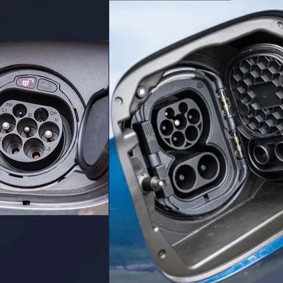

Most cars have one of these 1727698296334.png the bottom two pins are for DC so only used with fast chargers, the 7 pins often 2 pins missing
so they can only use single phase, so max charge rate is 7 kW, with 3 phase 22 kW max. But a commando plug has no fuse, so does not get hot, but a 13 amp plug does, and fuses always get hot, so with a 13 amp plug the charge rate is only 10 amp so as not to over heat plug, commando plugs come as 16, 32, 64 amp and more, single and three phase, 110 and 230 volt to earth, but main thing is they can be used up to their rating for a long time without over heating.

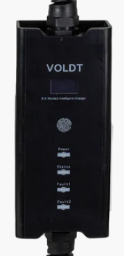

The box in the lead 1727698820001.pngare not all the same, the protection is the main variation, 6 mA DC, loss of PEN, RCD, may or may not be included, so prices vary. Some 1727699042987.png will allow you to swap and change the plug. Clearly using even a 16 amp commando plug will increase charge rate by 1/3 so I would be at least looking at a 16 amp socket, but
