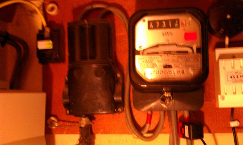

Supply in
CU
The one labeled 'Spare' has a 32A B32 in it, the one to the far right labeled sockets is actually our whirlpool bath? Don't know why its labelled as sockets by thats by the by

Just one thing to consider- looking at the picture of your cutout and main earth etc, That main bare earth which is plummed onto the lead looks quite small and also from experience that cutout will only have a maximum of a 60A fuse inside. I'd mention this to the sparky and possible get the DNO out to change the cutout to a new 100A one with a new 16mm main earth connection (if the EFLI test turns out to be below .80 ohms). Shouldn't cost anything either
