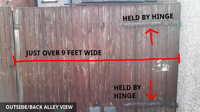

I've got major fence issues!
I'm not really experienced in building but am smart enough that with a bit of direction can probably do the job...I think. Anyway, back fence of a terraced house has been battered for years and is being held by 2x4 braces and rope! lol

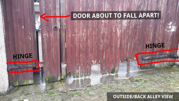

My back fence door recently nearly came apart in 2 pcs due to latest strong winds (we get hit with strong winds 5-6 times per year). I don't think my poor fence will last another strong wind.

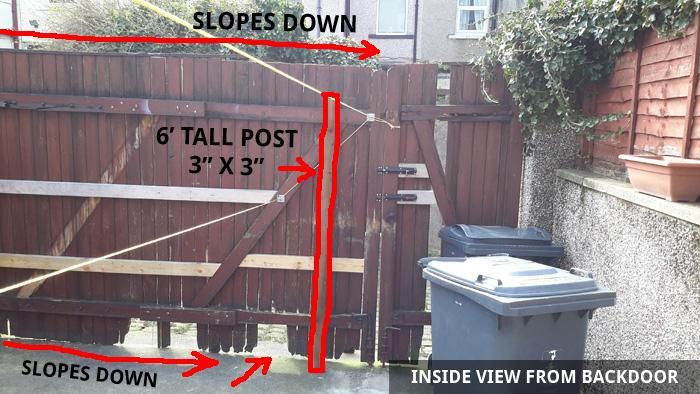

I went to B&Q and bought 3 - 3x3 inch posts, 6' tall and some 1" x 4" boards that would act as the horizontal "braces"(?) and some metal footings(?)

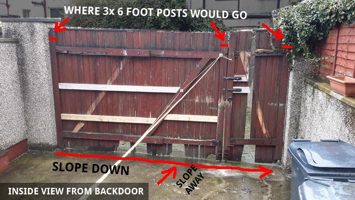

My main issue, aside from wondering if I have the right materials, is that my back garden slopes down (left to right) and away (towards back alley) so the brackets wouldn't be level. I bought some "shims" to help level the brackets out.

1) Are the brackets and 3x3 by 6' posts going to be sturdy enough? I was going to use 1" x 4" or 1" x 6" boards (either B&Q or Wickes)
2) Would I need 4x4x6' posts instead? Please remember, we get some strong winds several times per year
3) What about the slope down and away? How would I level out the brackets so the fence posts were vertical, etc?
4) The door may be tricky too because I was going to use the old hinge for the new door I planned on building.
5) The fence is over 9' long and I was going to use 3 posts to make it secured as opposed to using the old hinges.

Welcome Scott!
Personally I find those Metpost sockets are fine for bolting down onto solid concrete, if yours is in good nick.
You should get a good fixing into those brick piers, as a starting point.
4"x4" posts will always be better, especially in the centre run of the fence.
Keep the arris rails level, then cut your fencing planks to follow the contour of the yard

Yes Scott the brick piers are at the left and right of the old fence......they look to be in pretty sound condition, so any post should fix well to them.
It wouldn't have to be a 4x4 post onto the piers, it may be easier for you to use a 4x3 or even 4x2, keeping the 4" face flat against the brick.
I don't consider 3" posts with any fence of that height.....fine for decorative garden stuff but that's about it.
The arris rails are the horizontals that link the posts, the stronger they are means less movement when the fence is done.
The fence needs to be level at the top, and the boards cut to length to suit the yard floor, if you see what I mean......the tops can be pointed, curved or whatever to suit you. The wider the board the more likely it is to cup (warp) with the weather.
You can level the Metsockets with plastic shims or steel washers - which ever is the easiest for you. Stop water getting in under the Metsocket with silicone if the gap is small, or sand and cement if the gap is large.
The Metsockets are bolted down with Rawlbolts, so you'll need the correct hammer drill and drill bit.
As for the brick piers, you can fix your posts to them with Rawlbolts again, or large frame fixers.....There's lots of alternatives out there!
Hope your project goes well - arm yourself with a good spirit level and a string line to help with the middle post(s).
John :)

Burnerman has given good advice.
I advise the use of large stainless steel washers under the bolt holes to level the Metsockets - they won't crack/fall apart like plastic shims might. Don't rush setting the metsockets in place - aim to get the posts absolutely vertical so it looks neater. Getting the posts in the metsockets before final levelling and screw down may help.
Rather than expansion rawl bolts I'd use something like these...
http://www.screwfix.com/c/screws-nails-fixings/bolts/cat840086#category=cat6530001
They don't put so much stress on the concrete but definitely need correct size drill bit and ideally a socket and wrench to tighten.
I strongly advise drilling a small test hole in the concrete first to check how thick it is. No fixing is going to hold up a fence that high if the concrete is thin or crumbly.
