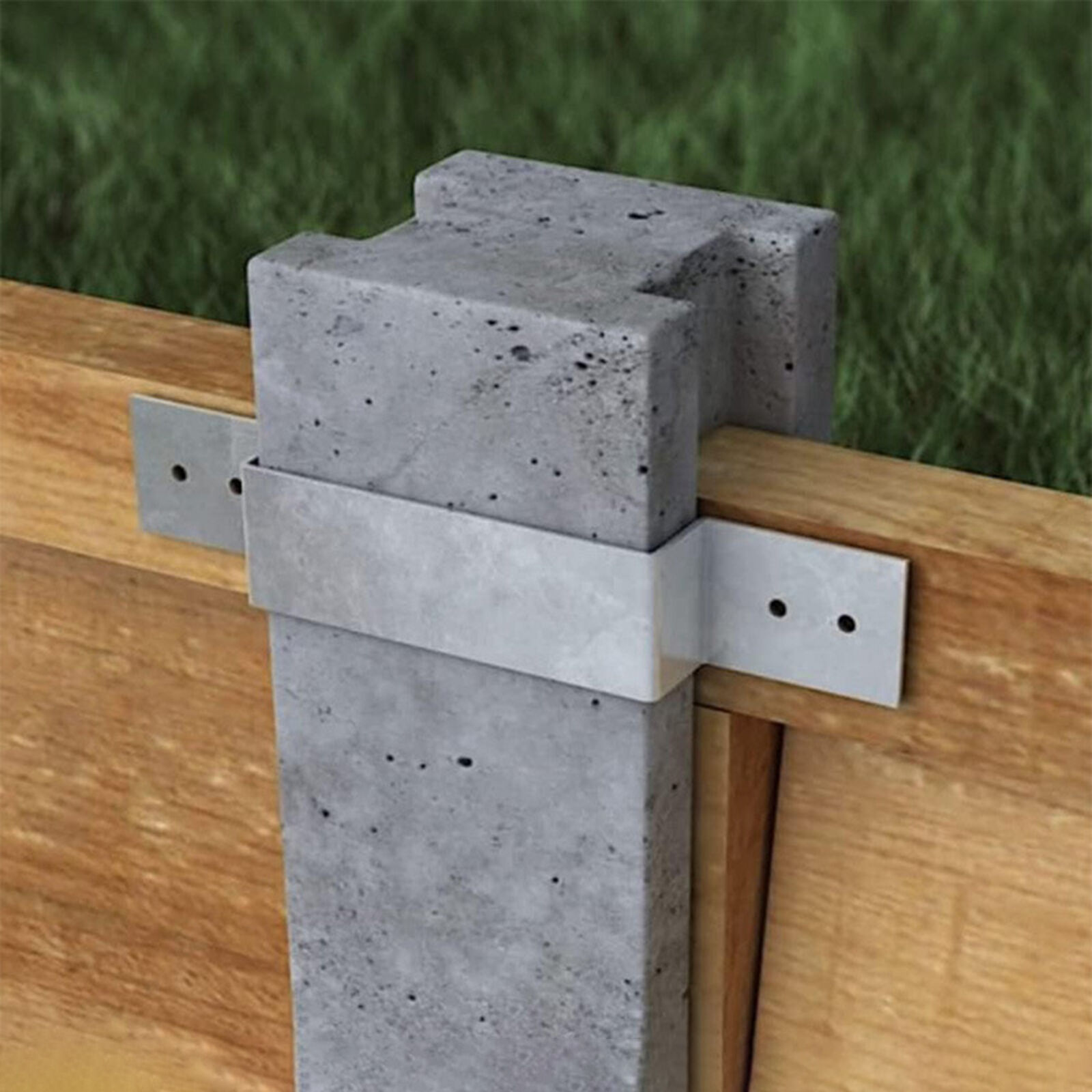

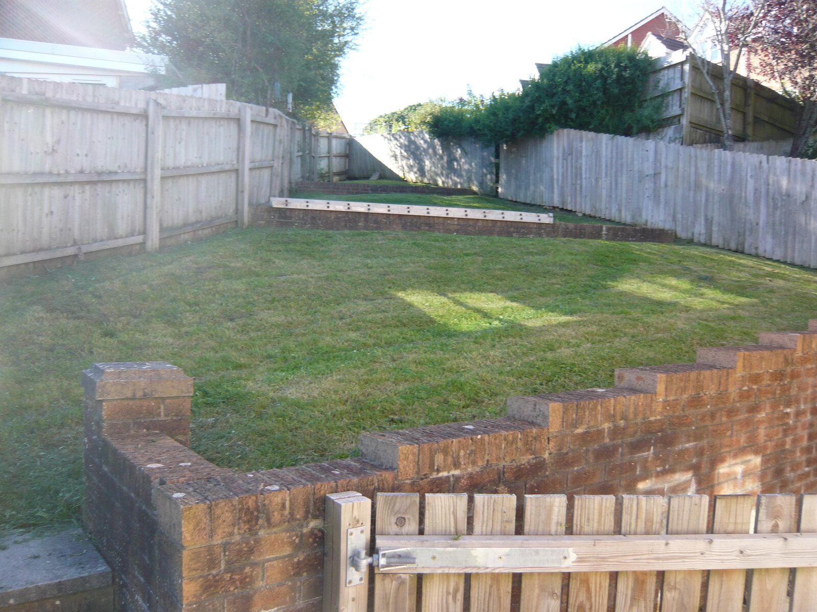

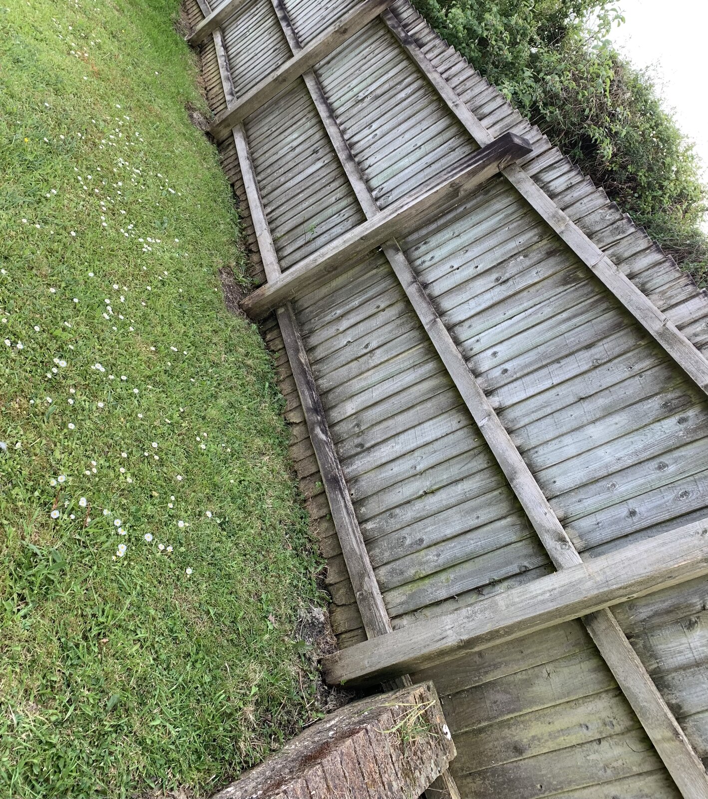

I have a feather-edge fence, the wooden posts are 4"x 4". Eighteen in total.
I need to replace these, but I need to attach the posts to the rails, from the rails side, as I can't get to the other side because of heavy brambles etc.
I need some sort of bracket, similar to the image, but obviously, to fit a 4"x 4" wooden post and then into the wooden rails.
Also, a photo of my fence :confused:

If you wanted a bracket like that, you could easily make them out of builders metalwork. Take a flat strap, cut to length, couple bends in a vice. That would answer your question - but probably not the best way to repair your fence?
Have you looked at post repair spurs?
Having vegetation pushing against a fence will cause it to fall over sooner than it would otherwise, so you should bear that in mind when sorting your fence.
If you can use concrete repair spurs "in situ" without taking the fence down, that would be ideal, but getting a fixing in might be tricky with access to only one side.

Yes. I'm thinking of using concrete spurs now... 18 of them.

It's not clear what you're replacing.
Are you fitting new posts and attaching the old rails to them?
Will the new posts be in the same place as the old? (This will be very very hard if they were set in a big lump of concrete)
From what I can see the old rails are not mortised into the posts, but fixed to the face, probably with screws. This is easy to do (but preferably using bolts, washers and nuts, or studding which is much cheaper.

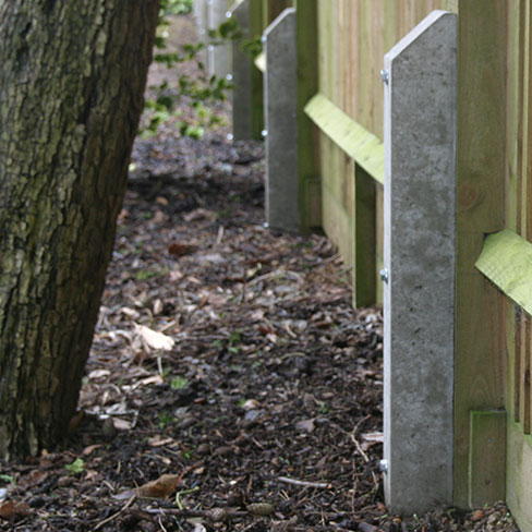

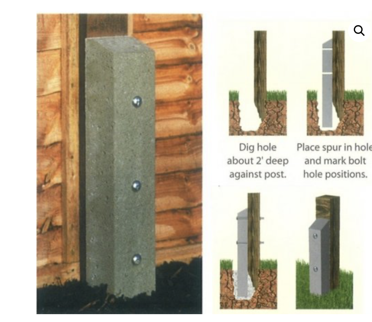

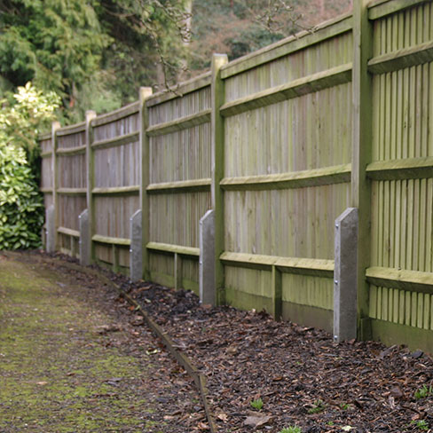

Fitting new posts next to the old rotting ones (save digging out the old ones) need to fix the the rails to these posts.
I can't get to the other side of the fence to nail/screw the rails to the new posts, as it usually done. I have decided to go halfway of the difficult side of things, and put in concrete, like the photos spurs.
It saves having the fence looking ugly to have a new post two feet away from each old one.
You saw the bottom of the post just above the rot.
The remainder of the posts above the rot are solid.
Anyway, I've decided to go that way.

Concrete spurs are fine. You can cut the rotten bottoms off your old wooden posts and bolt them to the spurs, not touching the ground.
Leave the concrete several days to harden. A week is better.
If you can rig up a dish to soak the cut post ends in wood preserver it will help
But you will find it hard work getting the stumps and the old concrete out if you want to use the same position.
8mm zinc plated studding is cheaper than huge screws or bolts. Use penny washers under the nuts, and grease the threads.

The only way I think the OP can do this with access only to one side would be to drill through the spurs and use timber fixings through into the posts.

The only way I can think of would be to but some right angle brackets.
Anyway, I have decided to bite half a bullet and go for concrete spurs on the original posts.
