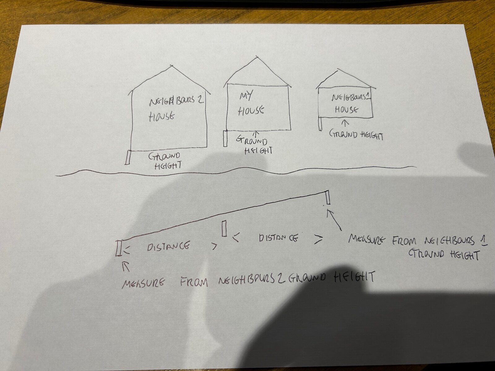

Just had an idea and wonder if this would satisfy the planning officer.
If i measure from my upper neighbours ground level nearest me to my lower neighbours ground level furthest away wouldn,t that give me the natural ground level ?
no ....the natural ground level uses the term "immediately adjacent" as you may not be able to physically see whats under but because its a fence it can physically be measured from the ground level under the fence
the measurement anywhere remote is off no value as far as a fence goes
for what its worth, my interoperation off datum point to measure from is on your side not the other but that may need the fence to be fully on your side and not on the wall its self to make it remote from the wall ??
but just my thoughts
That would mean, if the neighbour put the fence up, and their ground level was higher, the fence on the OP's side could be higher, than any fence the OP could install - clearly, that would be nonsense. I would take the measurement, from whichever side is the higher.

So the OP could get away with reducing the height from 2,150, by 150mm, above the neighbour's higher side, assuming that there are no special by-laws in place?
You would expect to follow the contours of the ground, taking the highest adjacent ground as the measuring point. Otherwise a garden that was two metres lower would be completely overlooked and the higher one not much better off. The regs say adjacent which is not the same as adjoining so maybe some wriggle room for the planning bid.
Does it really need planning? If the OP just lowers it 150mm he should be fully within regs..
