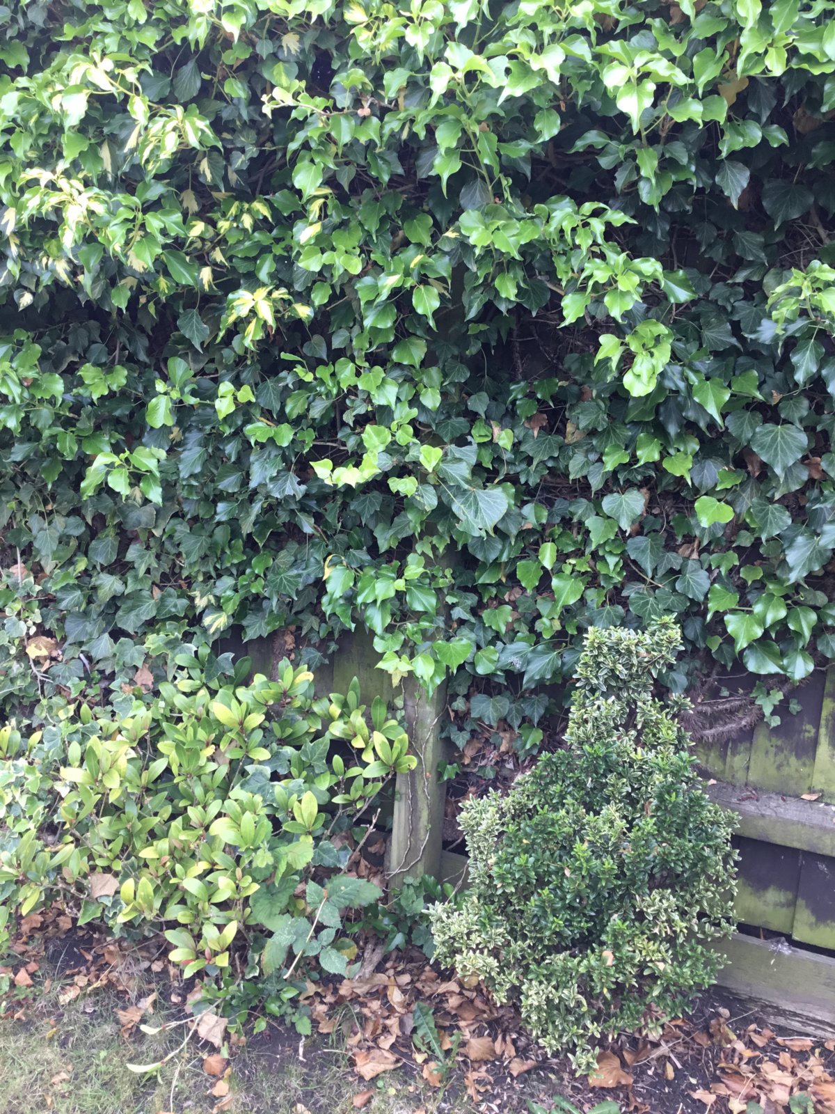

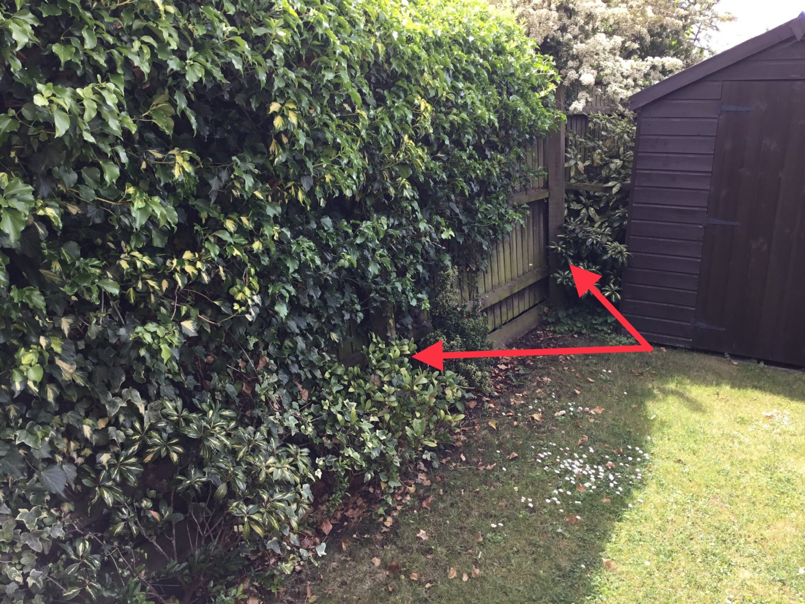

Hi all
I’m looking for advice on how to repair or replace the two broken fence posts as shown in the attached photo. I have previously replaced posts for standard 6x6 fencing but this fence is much larger and the posts much bigger.
Ideally I would like a contractor to do the job but it seems fencing repair contractors in the East Midlands area are very hard to find or they are just not interested. If anyone can recommend a fencing contractor in the LE7 area of Leicestershire it would be very much appreciated.
Thank you

You could try a fence spur, bolting it to the wooden post and setting in postcrete or similar product. You would need to chop out any concrete anchoring the existing post though, so a fair amount of physical effort if your not used to it.
Or you could look in the small ads section of the local paper for someone prepared to do what would be regarded as a small job by the more established fencing contractors. Be prepared to spend several hundred pounds for it.
