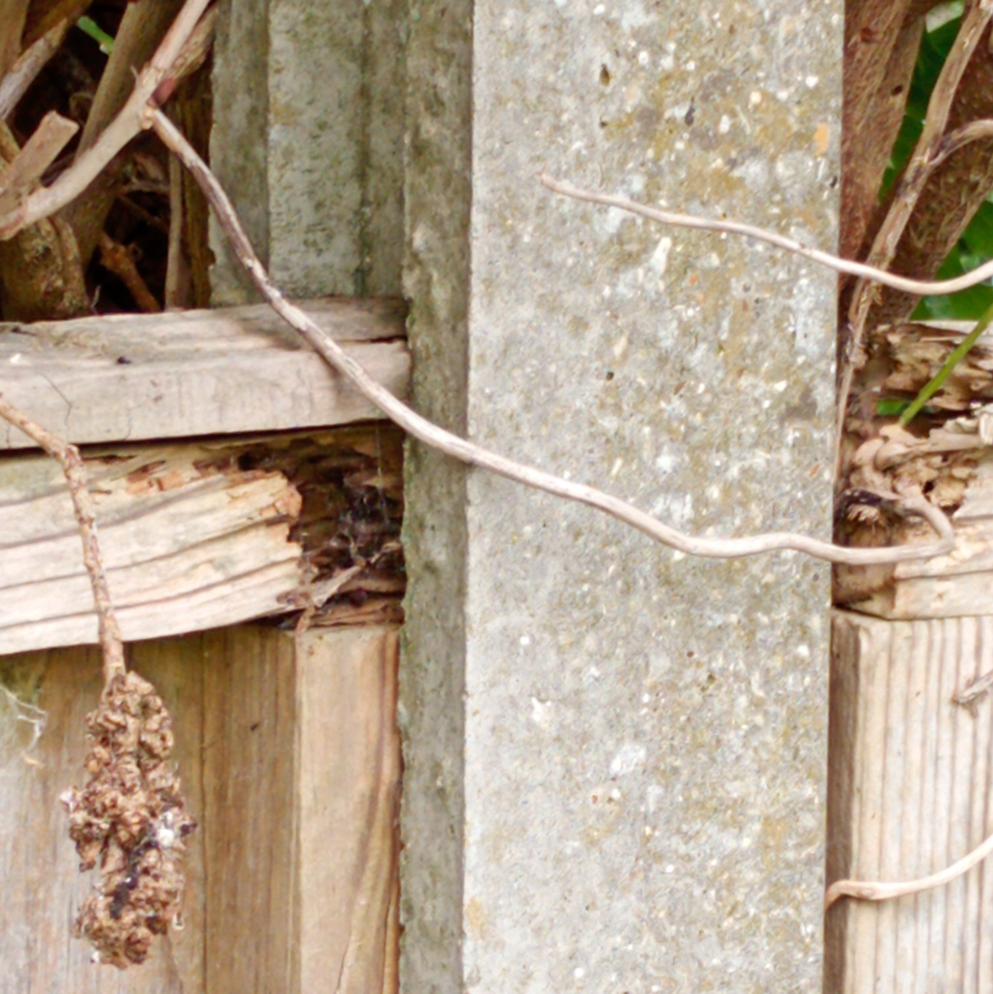

On a lot of my dads fence panels the top corners have rotted as you can see in the image below. What is the best solution to this, splice a new piece in or replace the whole cross member?
Obviously will replace the cap peice.

Splice some timber or patch it up as you wish if you like but the panels are nearing the end of their life.
The rest of the panels are showing no signs of rot it's just at the corners. That's why I was thinking of repair rather than replace.
Looks like there is plant life against fence which will prevent wind keeping the fence dry and avoid rot.
I would remove panel to make repair easier .
i repair all my lap larch panels and some are now 35 years old repairing with 2x1 tile batons chamfered for caps [so 3x thicker and stronger than provided]and 19x38mm for others
now here is the point it saves the planet but you need to keep replacing full lengths as you cant just splice in a bit in as the strength is end to end and its interaction you also need the tools and its generally cheaper to buy a new panel as every removed timber requires an oscillating saw through every nail so blades and timber
and a points off note whilst timber is metric panels are imperial so your replacement timber for 1830mm panel has to be a 2.1m or to get 2 from 1 3.9m
as said remove and have a look
as an aside you can replace and splice providing you can live with a new bit off timber but you need around 500mm[2x250mm] as an overlap onto the splice and on the old timber to hold them together but not at all pretty
