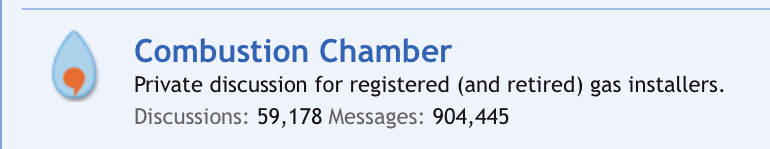

Update: got second hand PCB for 40 quid. Fitted it, bit fiddly, got my m8 in who is registered gas fitter to do all the necessary analysis with fga, we are now nice & toasty & might go wild & take a hot shower. Cheers all. On a side note: can ex gas chappies get into combustion chamber if no longer registered but can prove qualifications, ie: City n Guilds, old Gas Safe reg number?
Thanks again.
can ex gas chappies get into combustion chamber if no longer registered but can prove qualifications, is: City n Guilds, old Gas Safe reg number?
Thanks again.
Yes,I don’t know how it works, but it’s for retired engineers as well.
