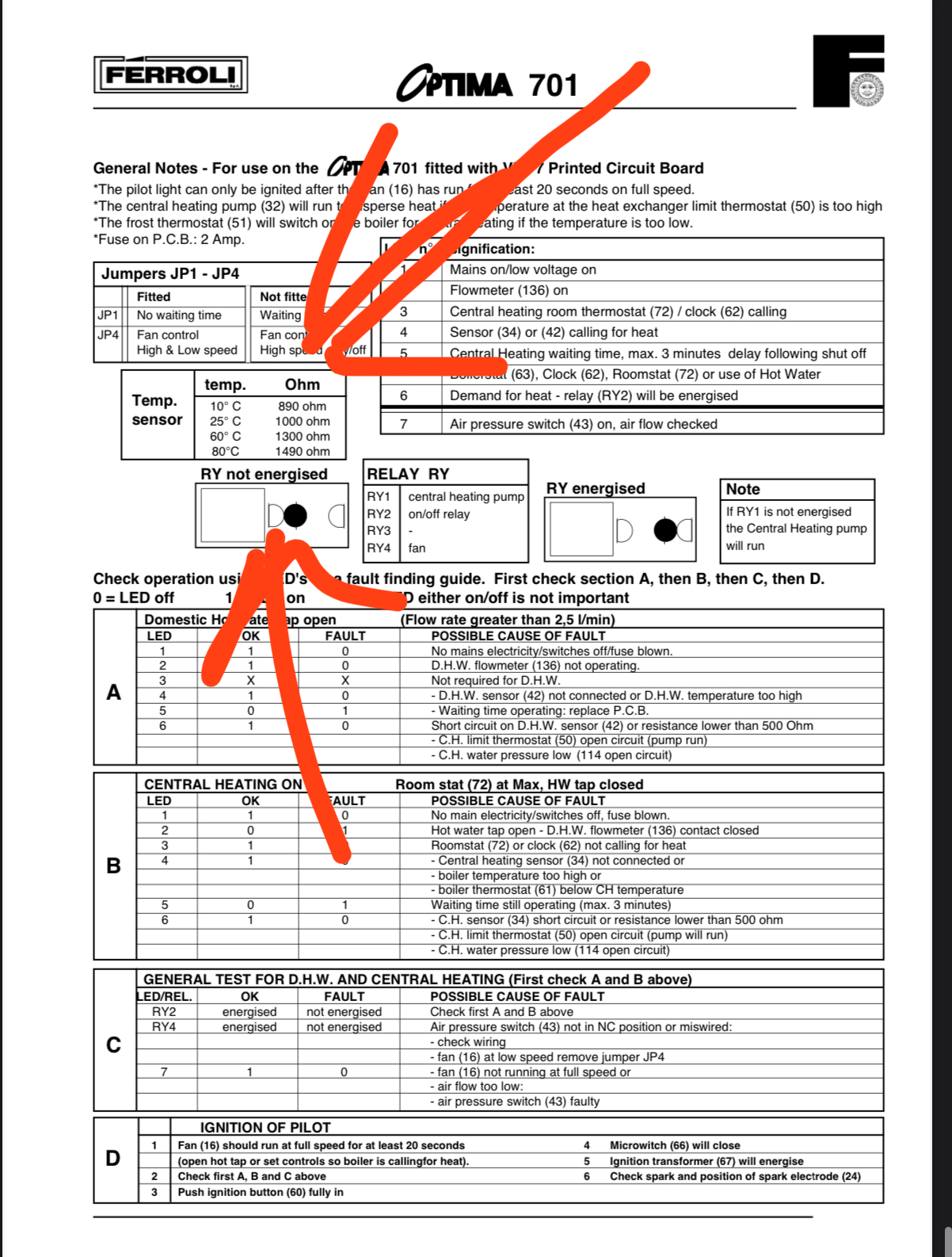

My trusty Ferroli 701CH is switching on /off.
I checked the LED status and done a few basic with my multimeter checks and it’s tripping on the CH limit stat/over temp on heat exchanger.
Would the CH flow temp cause this as it’s not adjusting/modulating the gas valve?
I have tested it’s resistance and it seems ok and within range??
Is the gas valve adjustable or just on/off as I suspect?
Cheers
The thermostat on the boiler to set the CH is also ok.
But even when I have it set at at its lowest in order to call for CH the outlet pipe is gets absolutely red hot.
I can not keep my hand on it!
It’s the internal ‘heat exchange limit thermostat’ (50 on diagram) that is switching the boiler even at its lowest setting.
Any ideas?

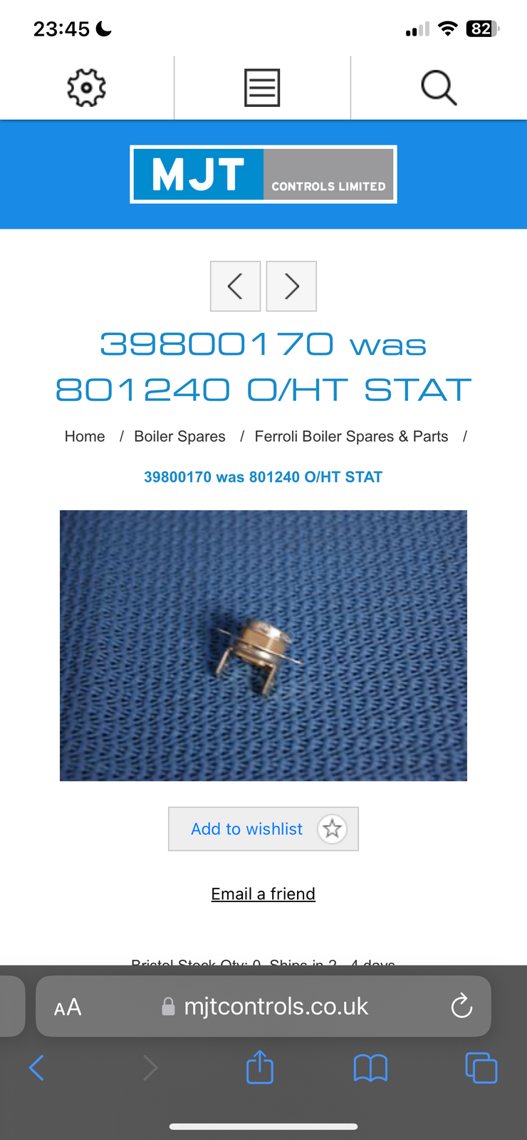

I have replaced the the CH flow sensor (34) but it will not fire at all then?
It is reading approx 1.2k!!! At room temp??
I had another and that reads the same??
I also swapped the CH and HW over over and HW is still fine/no problems at all?
Also looking on page 29 the as temp increases then so does resistance.
So they must be PTC thermistors.
Surely they should be NTC on CH or HW.
My reading of 1.2k when cold/removed at room temp show 1.2k on the new ones I purchased??
So this gives me approx as below (I just averaged the temps for missing specs.
10c. -890
25c. -1000
37c. -1100. Approx
48c. -1200. Approx
60c. -1300
70c. -1400. Approx
80c. -1490

PTC thermistors were not unusual for boilers developed in the 90s when boiler control was less advanced.
Some models had PTCs that had resistances down to a few ohms.
What's the pump like?

What are the leds indicating during heating cycle?

Check the pump

What flow switch. Pump run is not checked
240 on terminal means power going to it but it could be slow running so will not blow a fuse but temperature will spike.
You need to look at the led strip to establish what is calling or shutting the burner

All LEDs seem to be fine even though the diagnostic capabilities of them is very vague imo……
Everything works.
All conditions met.
I have HW and CH (trips after hitting limit)
It’s not tripping the
It’s just tripping out on CH Limit stat/Heat Exchanger Limit stat (50).
There is 230v going to pump and my rads are warming up so it must be ‘running’.
After CH is constantly cycling on/off the pump is red hot.
I did bleed the pump and as well but no difference (water was very black as expected).

LED is the one that is ON/OFF.
Unplug thermistor goes off/adjust HW switches it/overheats it’s goes off as expected.
It’s even telling me the thermistor is ok as it I set it to min and it trips out I have to slightly increase temp for it to illuminate again.

I’m thinking it can only be the pump now…

Also what has confused me is that the HW and CH will not work if the new stats I had.
It’s as if the resistance is to to high even though that’s what it requires.
The resistance does not match what I posted above given by on the manual.
The new ones will not work on either HW or CH.
but both my existing work fine. Plus I have have swapped my existing over from HW to CH and it fires as last post.
They should be high resistance.
Anything below 0.5k and led 4 woukd drop out.
Hurray. Finally reached the finishing line.
There are two LEDs, one for heating and other for hot water. Led will drop out like you have found when overshoot occurs.
Have you checked the resistance of the working sensor against what is not working.
Bear in mind, visually these might look identical but operation will be polar opposite
Sensors that are not working should read about 1000 ohms at room temperature, if 10,000 then you have the wrong sensor
