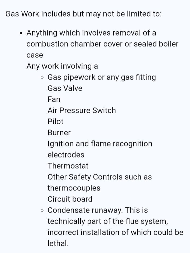

Gas Work: You will not be competent to go through all the appropriate tests of 26.9 when you think you've finished, will you?
Execution of these is a legal requirement.
Just because it works, doesn't mean it is safe or will fail safe.
In the same way, a gas fitter wouldn't know which 18th Edn regs apply or how to test.
- - - - - - - - Mod.
Why would I give free advice, on gas safety, what costs me a fortune every year to renew. Good luck bud
I disagree.
You may disagree, and I'm not going to argue. However, the forum rules state:
And the question you are asking comes under these terms, whether we like it, or not.
To avoid the forum moderators, I don't think you will find anyone to help answer your question here.
You may be more than competent; however, this is a public forum - people far less competent than you can still see any advice given, and end up in a whole load of trouble.
