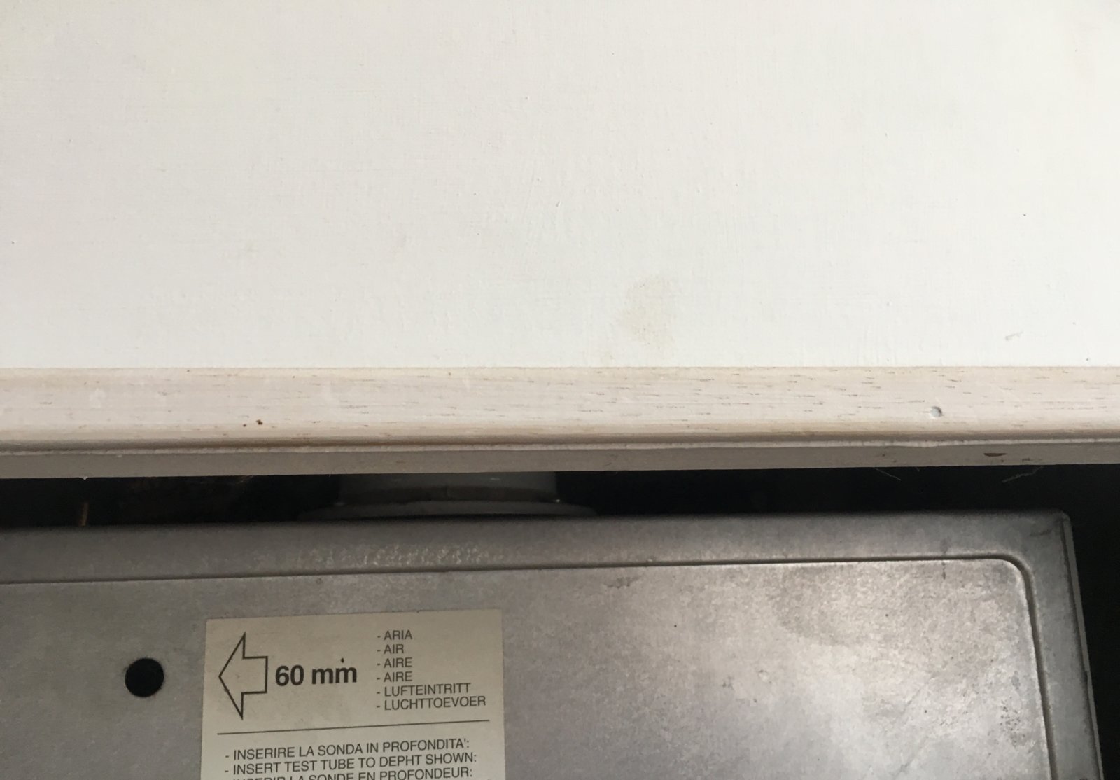

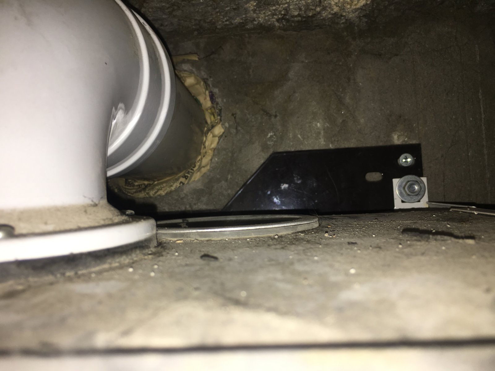

It's a nightmare for access, about 6" from boiler top to solid concrete, plus the access hole is even smaller, just big enough to lift the main cover off!!

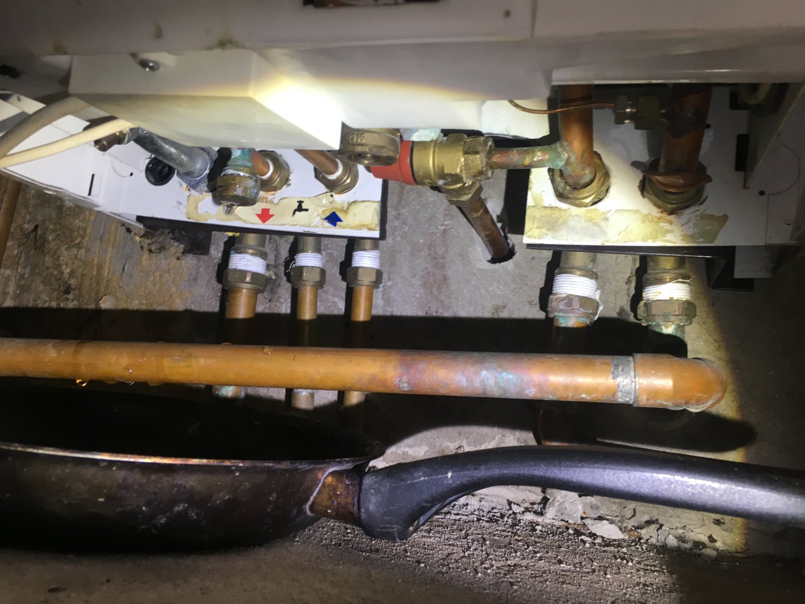

The bottom is even worse as in pic, the drain off valve is just a 15mm end cap!!, was expecting a drain plug or something tbh...
Got nothing to fit onto it i can think of atm, but i should fit something to make it future proof, an isolation valve/drain??
Can i get anything? A
The back door to drain to is literally 5ft away.

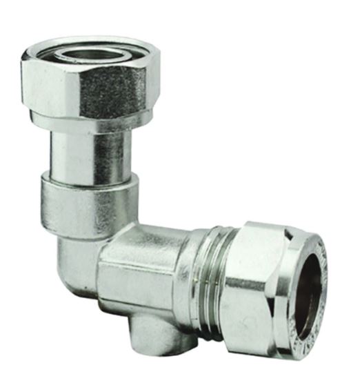

What can i fit to it once it's drained in order that i can just connect a hose next time?
I've got a Benzo/solder/flux etc...Was thinking an elbow tap valve with valve and then onto an end feed drain plug or something??
Anyone got any ideas?
