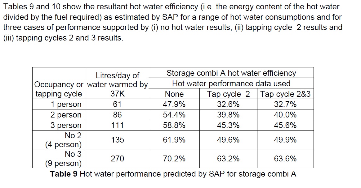

You still haven't explained how your imaginary friend calculated boiler efficiency without measuring flue gases and condensate volume/distribution.
Why don't you speak up and give the actual efficiency.
The calculation of true efficiency requires only :-
(1) Heat energy available in the fuel consumed
(2) Heat energy transfered into the fluid ( the water )
and is best expressed as Coefficient of Performance ( COP ) ,
Calculation is COP = (2) divided by (1)
The perfect boiler would have a COP of 1
The results of boiler testing. The boilers being used in the way that the boilers would be used in a domestic hot water sytem. Testing by the Building Research Establishment on a range of different boilers.

And as I explained before, Bernard, based on working with the bre first hand on a project, I wouldn't trust their input as far as I could throw them.
And those usage figures look like total booloocks.
So does 122% (hi) unless there is an explanation of the (hi) modifier.
The BRE figures fit with other sources.

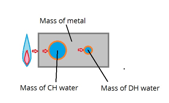

Can you say how much the Intergas heat exchanger weighs ?. be interesting to work out how many joules are need to raise the temperature of the aluminium mass by 40°C.

Can you be more specific? There's 5 of them.
Lets take the middle sized one. What I intend is to calculate the thermal mass between the flame and the DHW coil.
As the thermal mass between the flame and the DHW coil includes the thermal mass of the water in the CH coil it would help to have accurate dimensions of the CH water ways as the CH water will absorb a significant amount of heat compared to the amount absorbed by the aluminium block.
