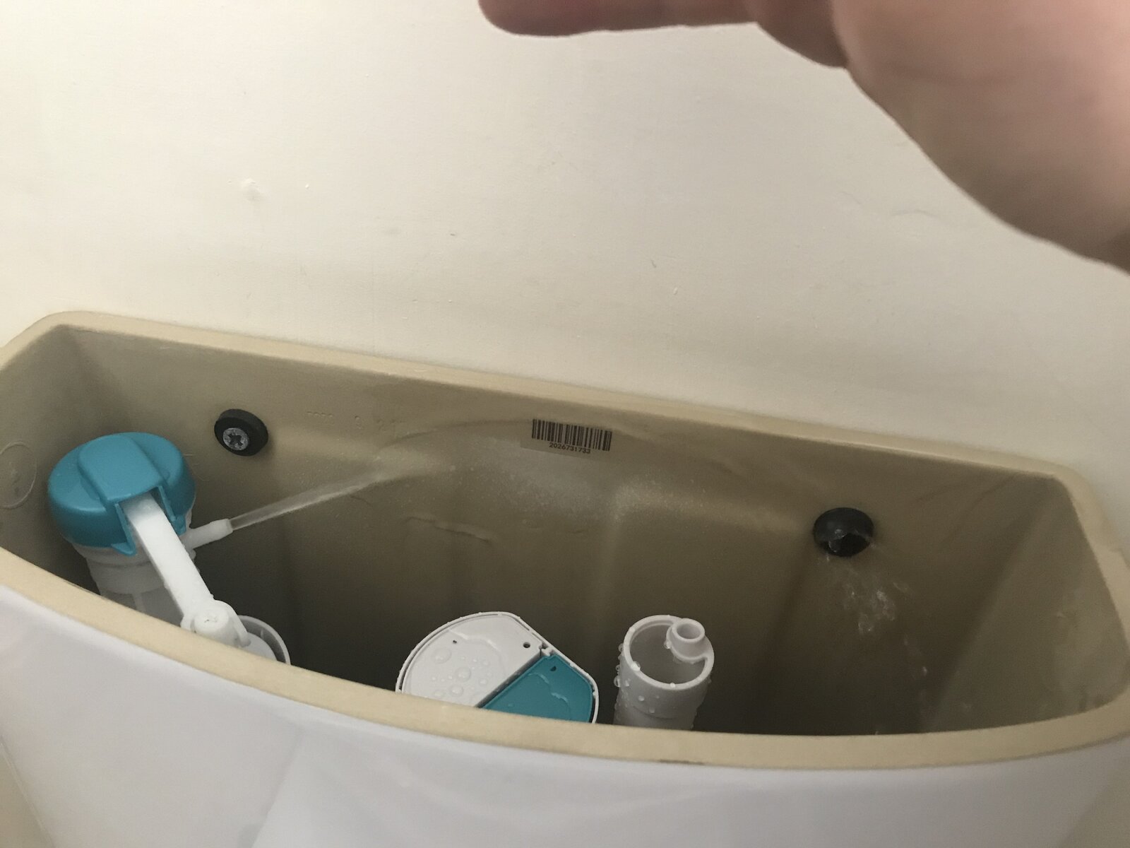

My new toilet is peeing water upwards and it spills down the back of the cistern.
I need a rubber tube. Any ideas where i can get one ?
1. Water isn't supposed to come out of that little "spout".
2. May need a new diaphragm washer.
3. Looks like a Viva "Skylo" but can't be sure.
