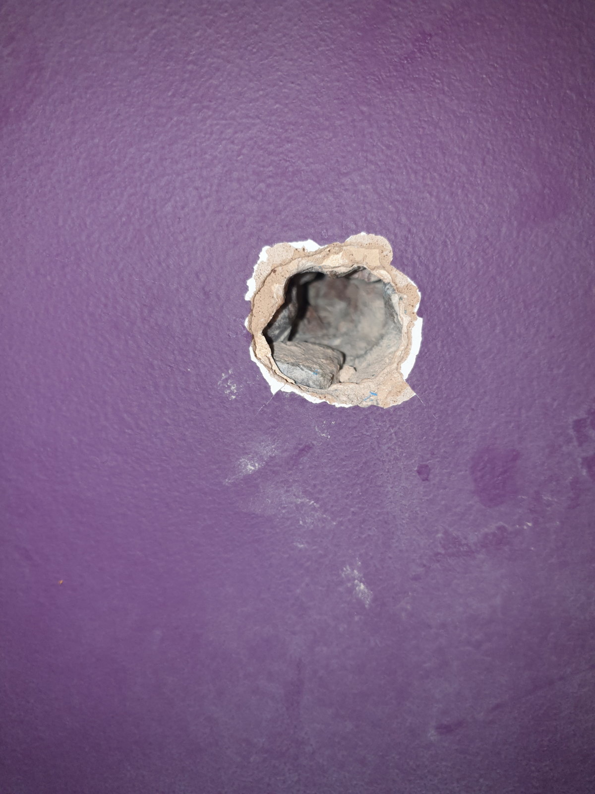

I was hoping someone would know how to help. My house is wimpy no fines (https://www.bisfhouse.com/wimpey-no-fines-in-situ-concrete-house/) so the external walls are loads of decent-sized pebbles and gaps. This means drilling into them is a pain in the arse and something I haven't tried much especially of anything heavy to be attached to the wall..
I am trying to mount a TV on a wall and as usual, drilling made a mess of the wall and didn't really split any of the pebbles so I used a small chisel to make a bigger hole with the intention of filling it and then drilling a clean hole (obviously I will do more holes for the other mount points), I just wondered what the best filler would be so I can mount about 10/11kg of TV and bracket. The hole is about the size of 50p

How deep is it? Maybe polyfilla? But maybe don't take my advice ...
sand and cement. Wet the hole first, and poke it in with a pencil so it is dense with no air pockets. You can press your plasplug into it while it is wet, so no need to drill again.
Mist the wall frequently for a day or so to keep the cement wet while it cures.
Press it slightly below the level of the plaster so that when you tire of it and want to fill the hole, there is no need to pull it out and leave a huge crater.

The hole is that big because I used a chisel as my hammer drill and masonry bit barely got past the plaster.
As you have probably guessed I am not all that good at DIY and I've never mixed cement before so I don't know what ratio would be best or would it not matter too much?
5 of sand to 1 of cement will do (it's quite a weak mix)
mix it up in an ice-cream container
less water than you think
If you put water in first, them add cement, it will minimise dust while you work. Preferably mix it outdoors because of cement dust.
I find it's also very good for bedding in electrical back boxes and the first layer of chases (stays workable longer than plaster).
Wet the hole first and mist the job once in. Cement hardens by chemical reaction with water so must not dry out or it will stop hardening (and will not restart). A day is the shortest time to get any strength.
Don't rip the bag open like this idiot. Cut it neatly across the top so you can fold it tightly to keep air out. You can mix it with an old knife. If the mix looks black or dark grey it probably has too much cement. You can buy small amounts in strong plastic bags.
