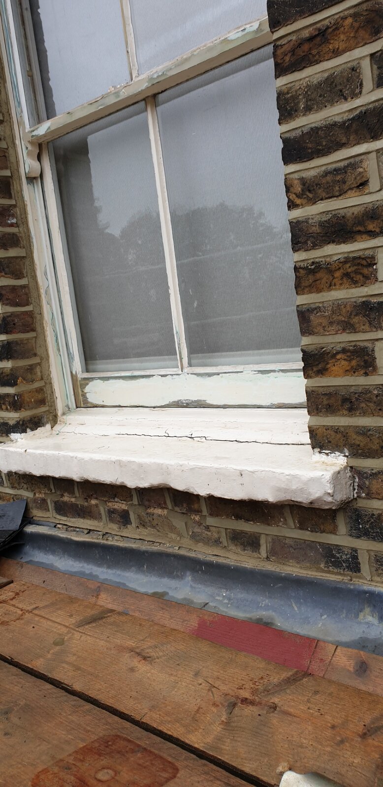

Scraped all the loose paint off this old windowsill gonna then wash it down. Gonna put on peel stop on any places still dusty when I run my hands over it It's pretty dented and knackered, is it pointless filling the holes from flaked paint?
You have a number of options.
The easiest would be to skim the whole thing with Toupret Touprelith F. It is pretty easy to sand flat. It is not really suitable for windows sills that may have someone banging a ladder against them. You can hand sand it though if you need to. It does however have a very slight granular texture. After about 4 coats of masonry paint, you can lightly sand the masonry paint to make it (the paint) flatter.
Toupret make harder exterior fillers, but they require much more sanding.
If I want a very durable finish and don't care how many coats of filler I have to apply, I use two pack filler (eg Upol Easy 1). But the following took over half a day of filling, sanding and filling and sanding...

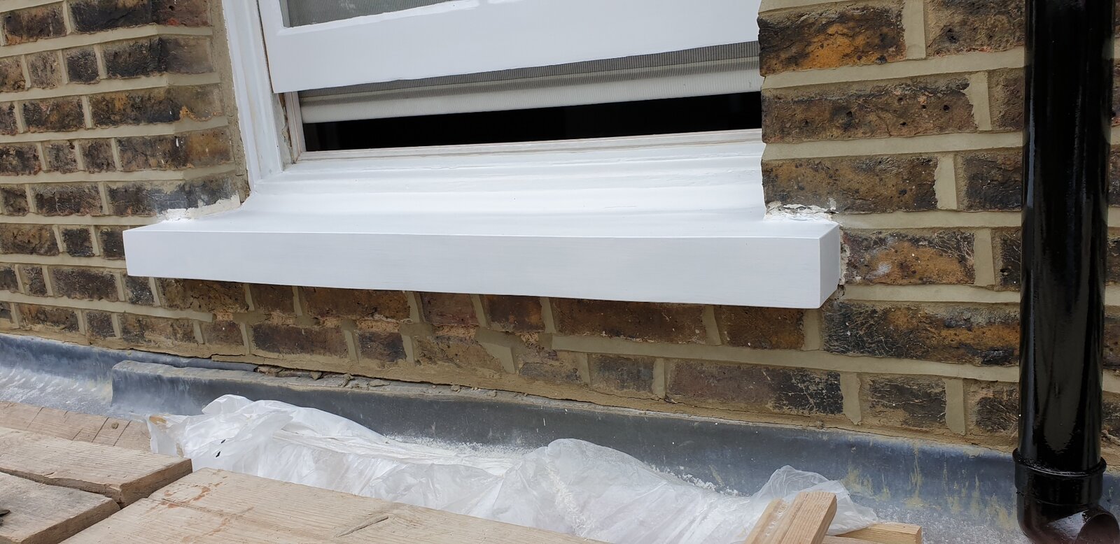

I wrap polythene dust sheet around a length of timber and clamp it to the underside of the window sill. None of the fillers mentioned above will stick to the polythene.
Once the timber is in place, force the filler into the irregular underside. I try to make sure that it only goes backward about 5mm. If it is an old sill with no drip channel, I don't want rainwater to track back to the wall.
I normally fill the top of the sill first and sand, adding more filler as required. I normally use a very wide knife (12") for the top of the sill.
I use a suitably sized filling knife to face fill the front edge. Some of the filler will reach over the previously sanded top edge. I then use the filling knife to pull the excess filler on to the top face (to ensure it bonds).
Once the filler has set, I remove the clamps. The underside should not need sanding. The poly should pull away. On the balance of probability, you may need to refill the tiny areas difficult to access because of the clamps.
