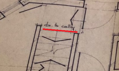

Here it is
The words "dn. to cellar" suggest there may be a cellar
I'm assuming this was the original entrance to the cellar, "DU" being down and up. The line to the cellar in the original drawing is still present in the new drawing so although this entrance has disappeared I'm thinking the cellar still exists as the line to the cellar has not been removed.

Nice one, we always joke that there could be millions down there lol. Would be nice if I could find out, could come in handy if it is a decent size (Which it looks according to the cellar line)
I've seen a few (but older houses) where the coal cellar ceiling/kitchen floor is formed by huge stone flags which are subsequently screeded over giving the appearance of concrete. Might be worth trying one of those cheap boroscope cameras that fit on your phone and drilling a few discrete holes with a masonry drill.
That's a strange shaped house, I wonder what it was before - looks like an old fort with all those "arrow slit" windows!
Only history I know is that it was built around 1920-1930 by an architect who designed the entire street and this house was for him, we live right next to a railway and I've seen a really old picture in a railway book that was taken pre war. I'm assuming the ceiling would only be plasterboard and not concrete or anything so suppose I will have to remove some floor boards and see if there is a void under the floor material?
do you have air bricks at low level around the utility area?
in the Existing drawing it indicates cellar steps.
no need to dig inside the house - remove a few low level, outside bricks, being alert to any DPC or DPM, and drive a steel bar down at an angle to search for a void.
or dig an outside pit, and then go sideways - if the foundation and footings for the wall are conventional and shallow then its doubtful that there's any cellar
Also where the wall of the cellar was there is now a porch/hallway there so air bricks could have been there but now covered up with a hallway.
