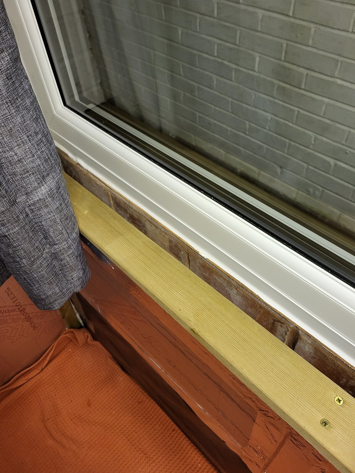

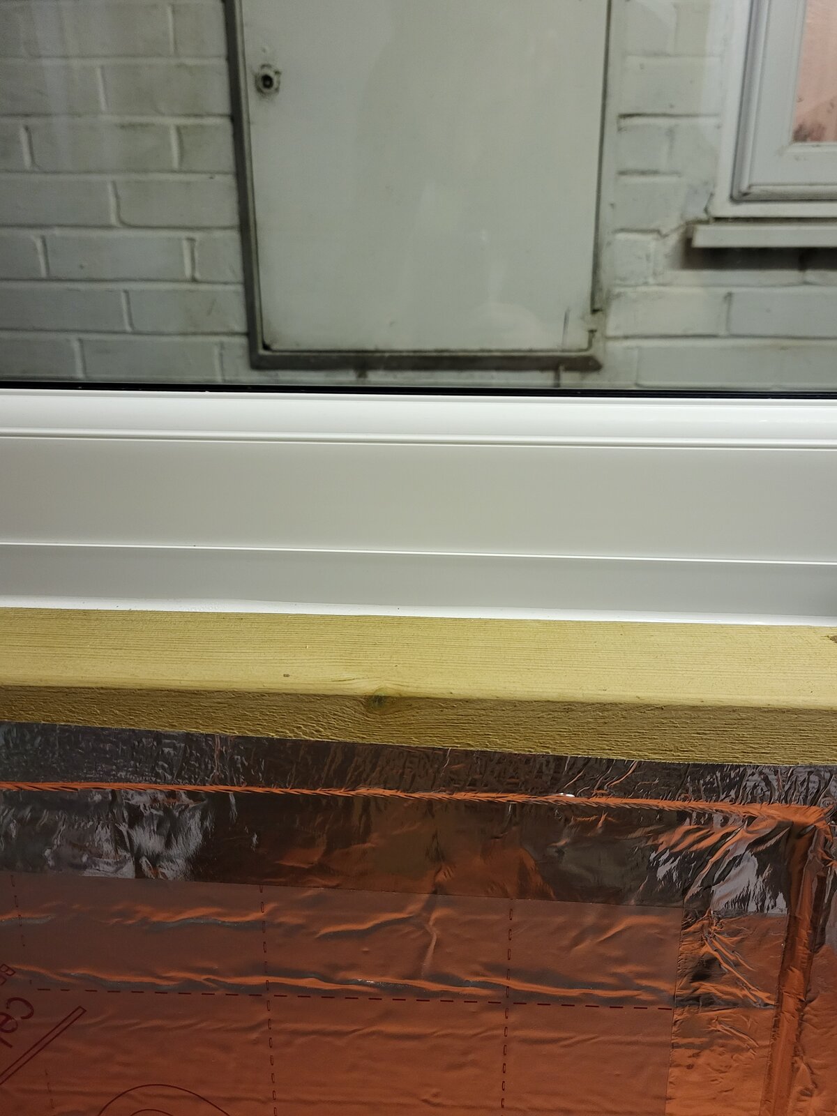

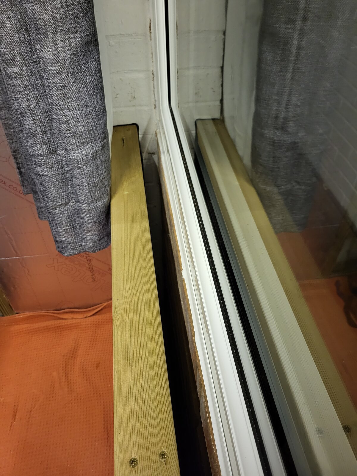

What would be the best way to finish off this low wall under my window?
I was thinking of Plasterboarding the front wall itself, but what can I do with the top?
Can I just put a uPVC Window ledge on?

Strip of PIR foam first, then plasterboard or window ledge.
Are there two windows, as there is a gap on the first pic, but not the second one?
No, just an illusion!
Exact same location just different angles. It's 1 Window.
PIR to Window and across Wood right? Not sit it in cavity?
Fit a (cut down) window board.
Is a window board an internal window sill? Or a specific item?
Just Googled it and they seem to be MDF. With PIR on top taped that should still be fine right?
Wickes do a uPVC Window Facia board. That similar?
I can't foresee much moisture coming up or condensation getting in either.
