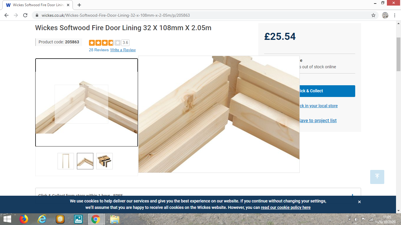

We need a fire door between our newly insulated/boarded utility room and garage.
We've got this Wickes fire door frame which is 108 mm deep.
Can someone confirm whether the hinges fix on the edge nearest to the rebate for the intumescent strip, so that the spine of the door sits over the top of the strip when in the closed position? This means 25mm S/S ball bearing hinges overlap onto the groove for the strip, so presumably you have to take the rebate for the hinge down to the depth of the groove for the intumescent strip, which is 4mm.The hinges are 2mm thick.
If the hinges were fixed on the other edge, then the intumescent strip would be on the far side of the door stop, so on the protected room side of the door? Assume that the idea is that the strip expands as possible if there's a fire, ie positioned closer to the fire risk area?

Thanks for replying.
The frame (as you can see) has the channel for the IS (we've got the one with brushes as believe it needs to be an FD30S door?)
the issue is that the hinges we have (SS ball bearing fire rated) are 51mm wide (each leaf 20mm) but the width between the edge of the frame and the channel for the intumescent strip is only 15 mm, so the hinge leaf (and one of the screw holes) goes over into the channel.
If we take the recess for the hinge down to only 2 ml, surely the hinge isn't going to "sit" flat, because of the 2 mm difference where it sits across the channel for the strip? The screws are pretty pathetic size 3 and the heads sheer off if you look at them the wrong way.

The hinges are recessed to the depth of the hinge leafs. The intumescent strip is cut some that it doesn't pass behind or beneath the hinge. The hinge leaf must be flush to the jamb. This means that there could be a groove beneath the hinge. If so it should be filled with intumescent caulk (fire stopping). If the hinge cuts into an intumescent strip it is normal to scribe the intumescent strip to fit around the hinge

Where you have fixed directly to the masonry if there are any gaps at all just fill them with intumescent caulk (there will be gaps - the caulk needs to be pumped in so thay it ideally forms at least 10mm deep bead). Ifneeds be use a spatula or stopping knife to get it in. On the other side the gaps should be packed with mineral wool (Rockwool, Earthwool, etc) and the last 10mm to the surface (on one side only) should be filled with intumescent caulk. The mineral wool is fire resistant, the caulk expands when it gets hot enough to prevent the fire breaching the containment.
