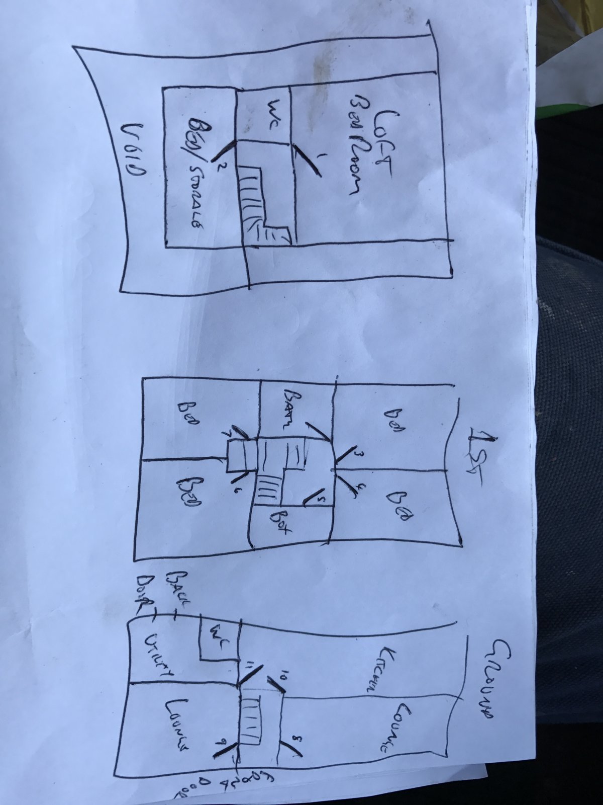

This shows roughly the 11 I think I need:
You'd normally have one on the door to the loft, not one in each loft room, so the layout must be an interesting one. Although you have 4 rooms on the ground floor, as the escape route to the front door has been protected, there's be no need to go out through the kitchen, so they shouldn't need doing. My BCO said that as long as I had a fire door at the bottom of the stairs to the loft, then he'd accept door closers on the other door.
Just got the pictures; yes, you're stuffed. Have a talk to him about options.
Although the ones I'm looking at are 'only' £148 each so not the end of the world.
You're still going to need the door closers, but maybe different types if you keep the existing doors, but see if the BCO will accept retardant paint on the existing doors.
